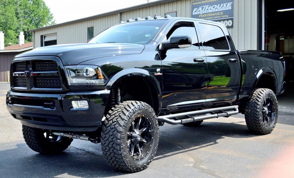

I have a customer that washed his truck for the first time after it was coated and noticed little water spots that won't wash off... it sits outside. He used ONR any ideas how to remedy this?
22ple applied Monday.. customer waited just over 24hours before removing this incredibly large truck from the shop where I spent many hours with it.. got rained on and he did an ONR on it today instructions said after intial 8-12 hours of cure it is safe to get wet and washed???
I received a pm from zach after asking for advice, and I am going to go over to wash this beast saturday evening after sun goes down and hopefully remove them if not will then use spotless followed by reload! Wish me luck!
Here she is
