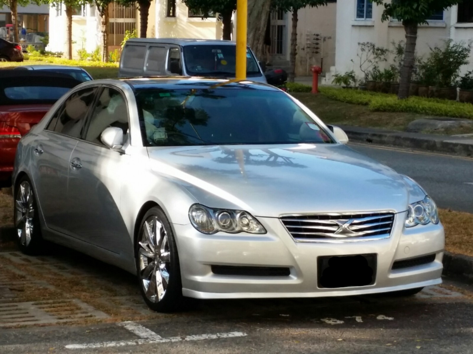

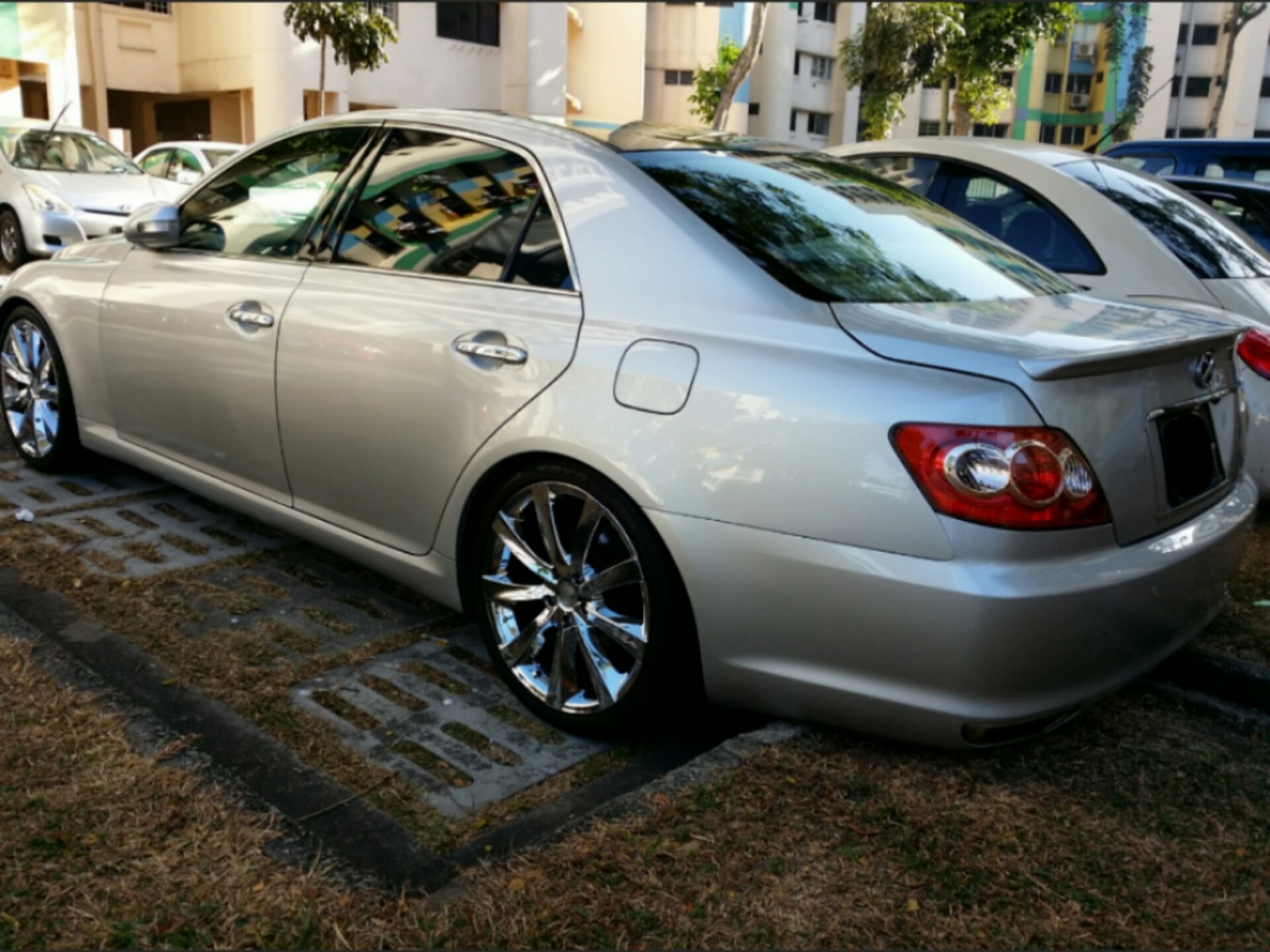

Check out these pics. And this isn’t even a fine grade towel, it’s the mid grade between fine/medium. These pics include a time stamp and show there was absolutely no negative effect on the paint such as marring after I was done.
Before
After. Zero clay marring.
I clayed my trunk the other day... Light color paint, all these contaminants, once again zero marring.
Clay marring only happens if your technique is truly bad [i.e. not enough lube, the wrong kind of lube, a heavy hand, super soft paint, etc] but under normL circumstances there should never be any clay marring no matter what color the vehicle is. I fail to see why black paint is any bigger deal than any other color. I detail black vehicles all the time and I don’t treat them any different than the rest.

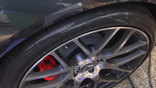

I clayed this dark navy blue Nissan Altima with a Med. Grade Nanoskin mitt and there wasn’t any marring.
I’ve clayed a black Porsche Panamera without marring it, I just don’t have any pictures of that job.
I’ve never detailed a Mazda or a Suburu, and I’ve never seen a black Toyota.
Both that MB and Nissan look like they have very smooth paint and virtually no OP. The level of OP and the level of contaminates seems to be the biggest determining factor regarding marring if you keep the other things like lube and claybar/mitt/towel/sponge consistent. Heavy OP causes more of that rash marring look seen on the peaks. Heavy contaminates will give you tiny scratches especially using a clay substitute.
