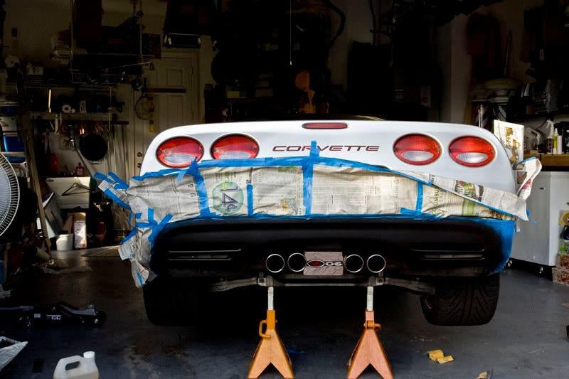

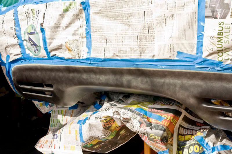

If I was broke and wanted that car to look better, I'd definitely go the rattle can route. I don't know how crazy you want to go, but a color change can be a lot of work and I don't know how much time you're looking to put into this. I painted the rear fascia of my Vette with SEM semi gloss/flat black (I think it was called Honda black bumper paint). I spent A LOT of time masking, scuffed with 800 grit, used plenty of Meguiars body solvent, and did many thin coats. It turned out awesome...did it on my friend's car too.
I would personally give something like that a shot, but since you don't have a good layer of paint to work with, you'll likely need to sand it down and re-primer it too.
