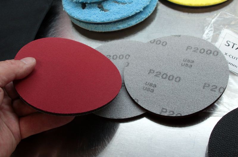

-Block sand everything with Mirka 1500 wet/dry paper
-Wet sanding with Mirka Abralon 2000grit sanding discs (6" & 3" disc)
-Wet sanding with Trizact 3000grit sanding discs (6" & 3" disc)

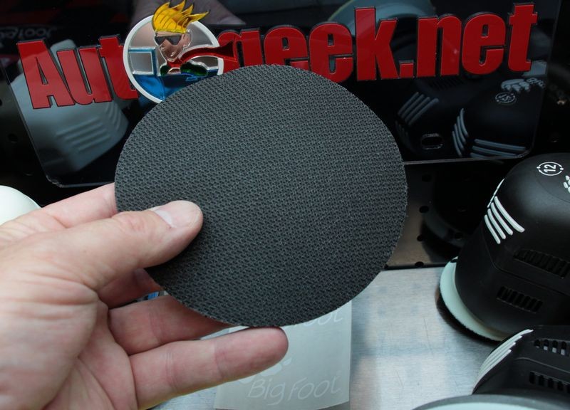

I used a 6" pneumatic 3m sander with a 3/32" orbit and a pistol grip 3" chicago pneumatic sander (both tools equipped with the 3m interface pad)
