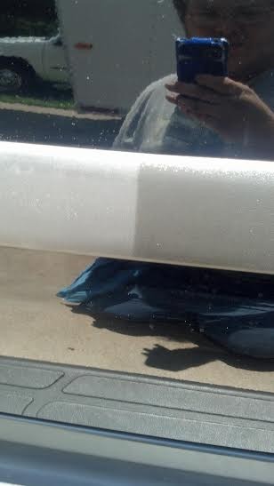

Now were talking!!! I love it when you guys start rolling:) OK so I just got back from seeing the car. It was less worse than I was expecting. Though I can see how a customer would feel having just paid 4K for a new paint job, Just to trust a detailer to leave him hanging. I checked the thickness of the paint and it was 260-300UM Should I switch to MILS on my meter? it is on Metric now. But can set it to Imperial. I looked on the roof and it looked like a 10 year old painted it with 100 spray cans. It was solid orange peel like nothing I have ever seen. I told him if I was to correct the roof it would cost more than doing his whole Suburban. He was totally fine with that. The picture sucks but maybe you can see it? We had rain and clouds were not letting much light through. I have some ACA 510 coming today and a purple wool LK tomorrow. Though I feel Beast with orange LC HDO CCS and 3D ONE will do the trick. I'm also pretty geeked he doesn't want the inside done. I only like interior jobs on newer vehicles. Thanks a ton guy's:)

Yeah, if that came into the shop, I'd start with the Orange LC HDO or blue Hex Logic/B&S standard, and 3D ONE to see where I may need to go cut wise. From that pic it looks like a sigh of relief! It's those cars with heavy, deep, and layered lacerations that test my mettle. Usually from an automatic car wash, where the brushes wet sand the vehicle using the mud and grit that drips from the seams or is pulled out of the wheel wells, or isn't power washed off during the prep stage.
