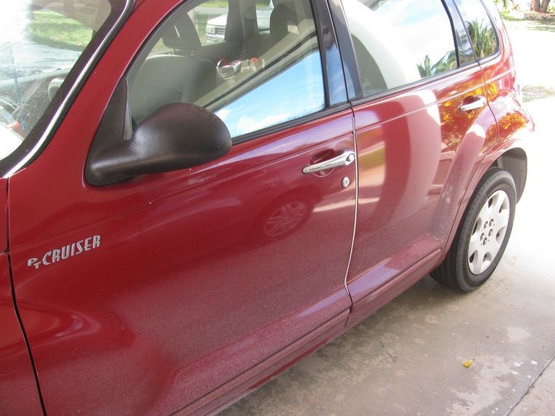

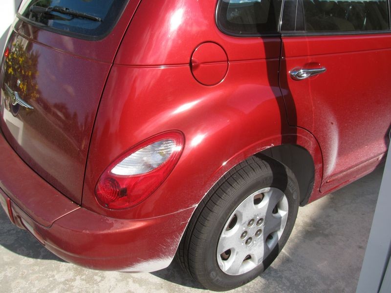

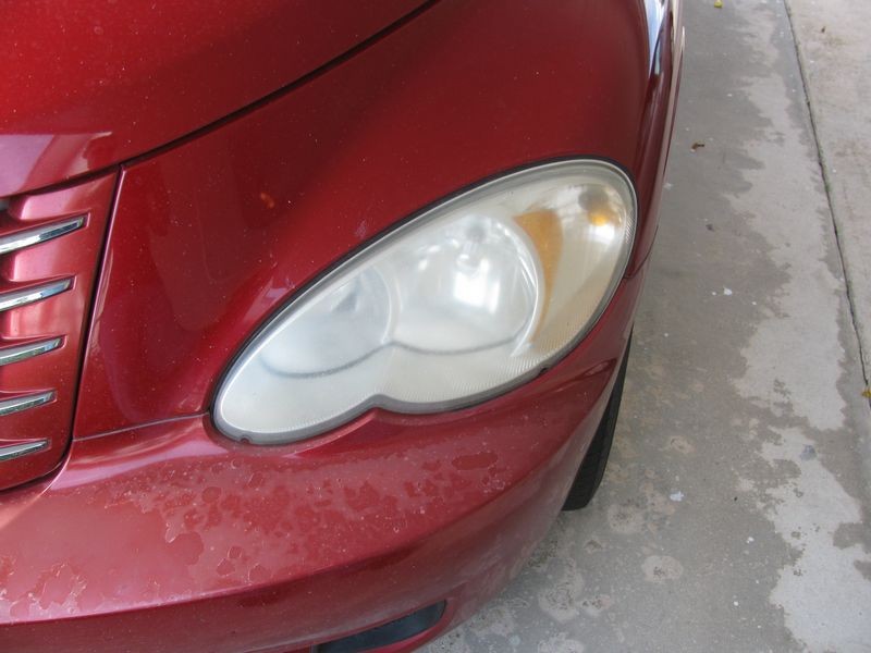

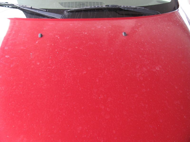

Hi Mike,
Take a look at the pictures, any idea what this is and if it's fixable?
I clayed a small section and polished with HD speed but it didn't really do anything.
View attachment 69424 View attachment 69425 View attachment 69426
Your thoughts would be appreciated. As far as I know it has never been repainted, after claying and polishing it felt smoother but not buttery smooth.
If your talking about those tiny brown specks-- Thats Artillery Fungus
Talking about the dots/specks you can see at the perimeter of the light reflection.

Well that doesn't sound great. I don't have the best light but it's definitely all over my hood and think I saw it on the roof but I'd want to clean and clay a spot to be sure.
I don't know.
I've seen this before but don't have a great answer.
They are like pin holes THROUGH the paint, not ON the paint.
Because they are through or in the paint, compounding will take off good paint and just uncover more of the tiny pin holes.
My guess is the safest route is to do your normal detailing steps for the paint and learn to live with them or get a repaint or trade-in the car.
:dunno:
