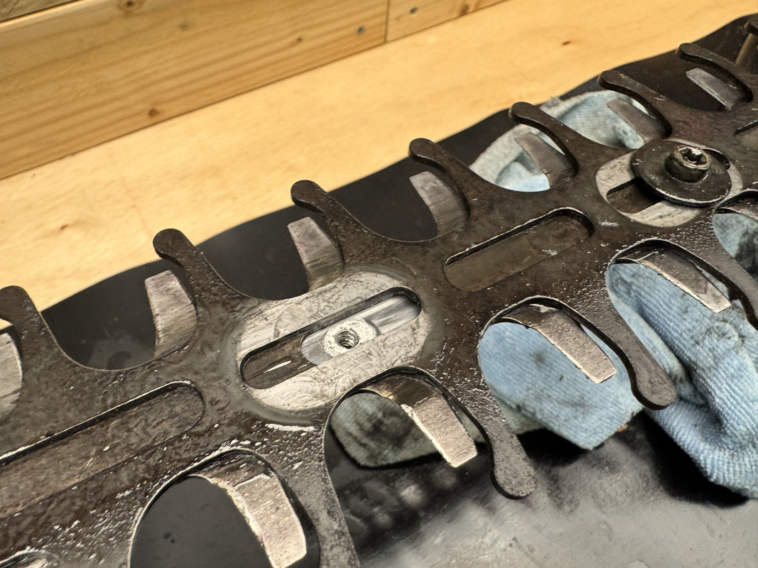

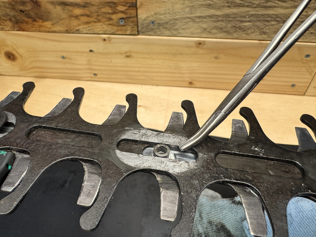

I noticed earlier in the week my hedge trimmer wasn't cutting very well, it also sounded louder than normal. No problem, it's probably ready for a another sharpen.
On Wednesday, I got around to taking a closer look. I normally sharpen the blades with a Dremel stone while still attached to the unit, but its a little cumbersome. So, this time I wanted to take them apart to make sharpening easier, but also to properly clean them and repack the gearbox with grease while I was at it. When I flipped the unit over, I found the source of the added noise and crappy cutting performance, missing hardware................

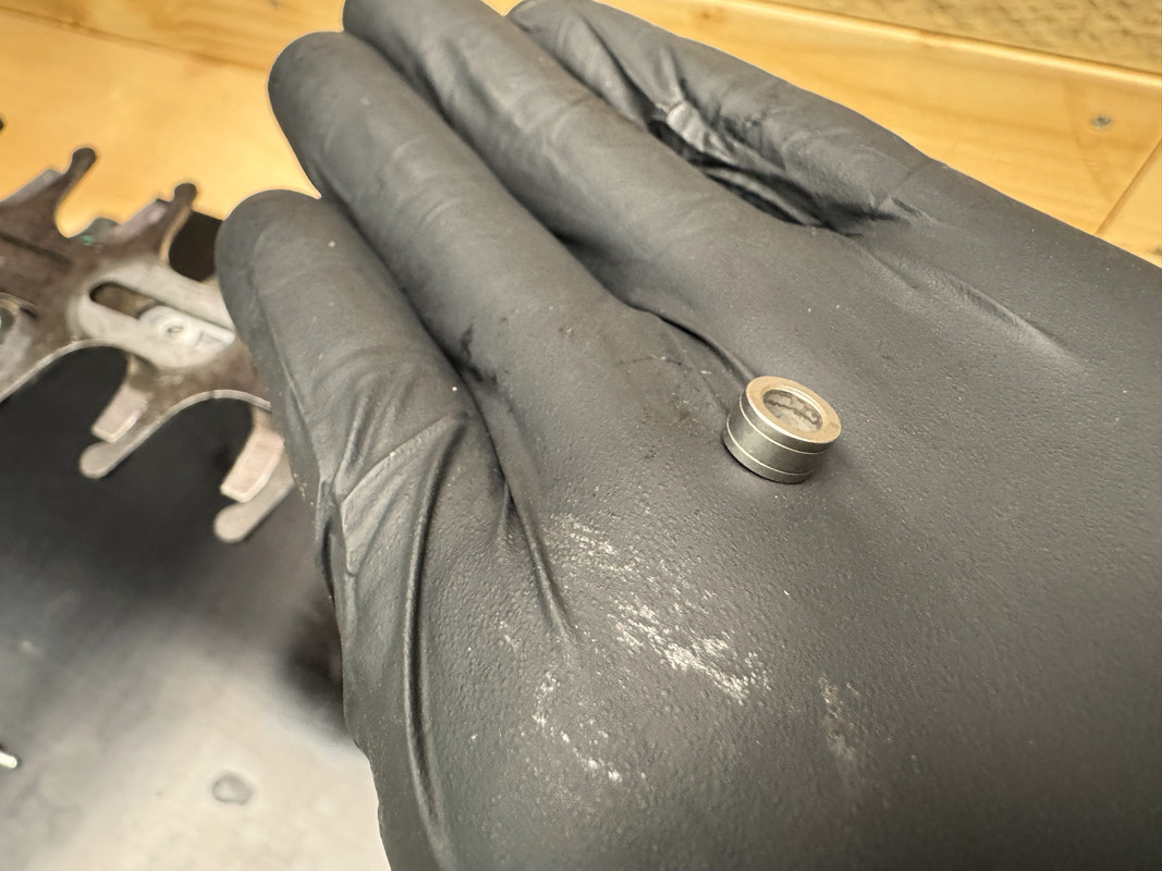

No problem, I'll find something in the parts crypt. So, off I went with the sharpening, cleaning, and re-greasing. I put it all back together and went looking for some hardware. The T27 bolt was easy, I have a case full of replacement Stihl hardware, I even found a suitable washer. But, I wasn't so lucky finding the tiny little piece that sits below the washer in the blade groove. This tiny part is crucial because it allows the fastener to be tight, yet prevents the bolt and washer clamping down too tight and locking up the blade movement.
Knowing how this stuff works, and being a battery powered tool, I was certain this missing piece would mean buying a whole blade assembly, valued at around $130 - $150. I've had colleagues scrap otherwise functioning hedge trimmers because of a missing piece like this that is not available as a spare part. As a long shot, I went and found the parts manual, then landed on the required parts within 2 minutes! This availability of parts is reassuring as Stihl is now fully invested in battery tools. In the past, battery or electric powered would have meant non-serviceable.

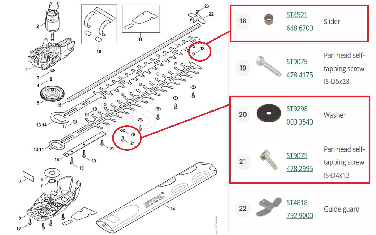

Outside of the basics, Stihl spare parts are normally only available through the dealer network, which generally means visiting a dealer. In the past, I've found this to be hit and miss, I'm still waiting for a fuel line I asked for 9 months ago! :nothappy I can't wait indefinitely for a part on this machine, especially with all of the spring growth. I suppose I could have driven all over town trying to find something similar from a hardware store or specialty bolt place, but frankly, I don't have the patience for that crap anymore. In this case, I found the parts at an online Stihl dealer and had them shipped in less than two days.

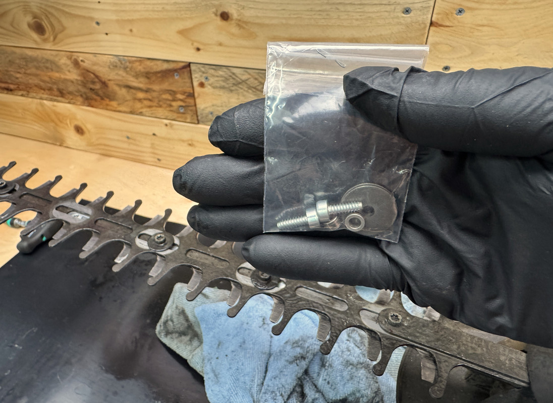

The part in question is what Stihl calls a "slider". This is basically a small piece of tube that retails for $6.00 each. While I was at it, I ordered the correct bolt and washer, two of each. I would have ordered more, but they only had two of the sliders in stock.
I said this was a $0.50c failure...................more like a $11.40 + shipping failure. That's one piece of tube, one bolt, one washer for $12. :doh

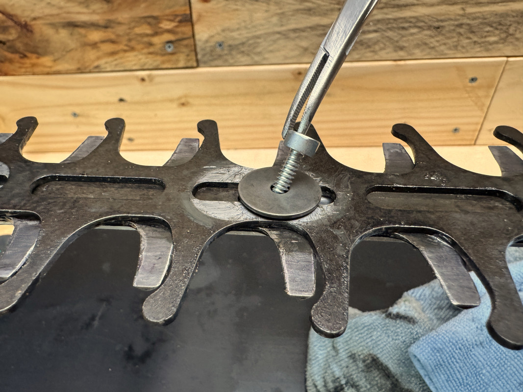

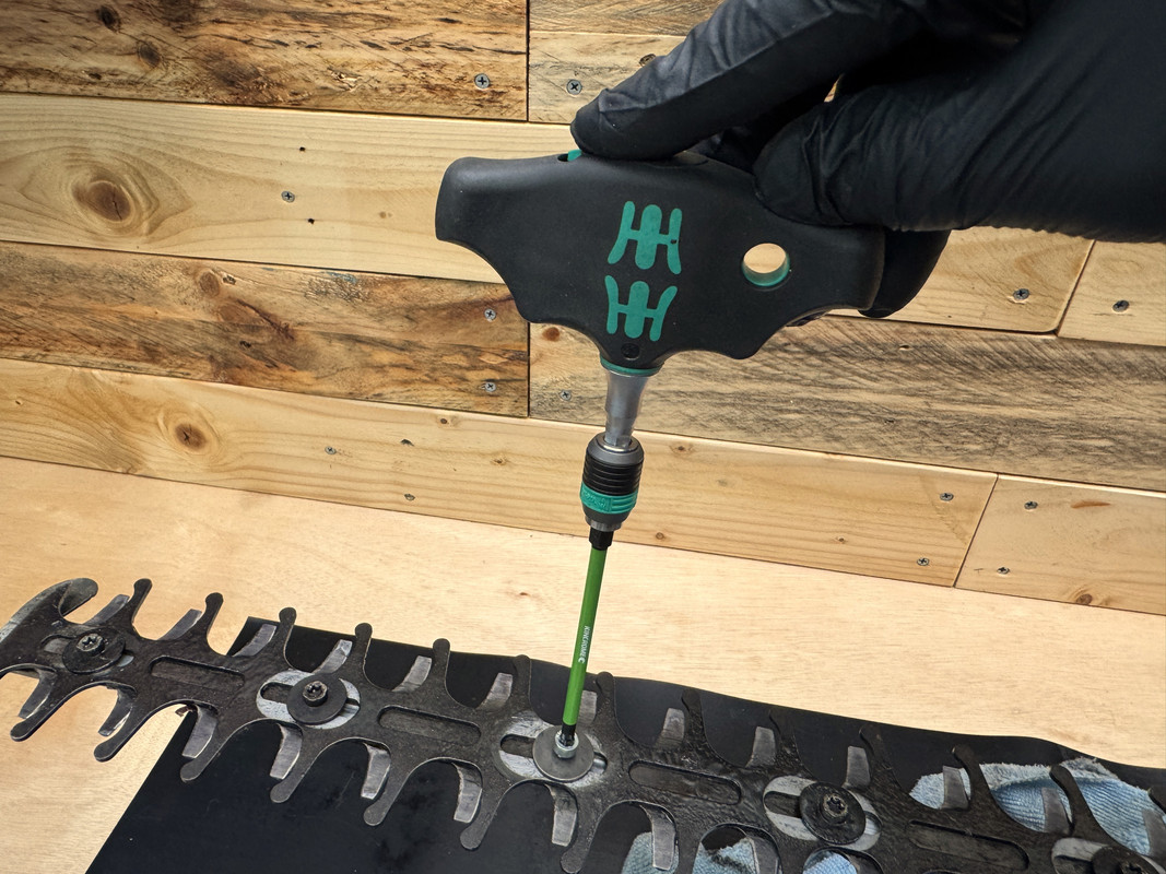

Having complained about the cost, I will say that $12 is better than $150 for a new blade set. And the parts were easy to find and fit.
As you can see, the "slider" fits into the grove created by the two blades, the washer sits on top and the bolt drives through and into the blade support guide. This arrangement provides just enough torque to keep the blades firm for crisp cutting, but not too tight that the blades won't oscillate.

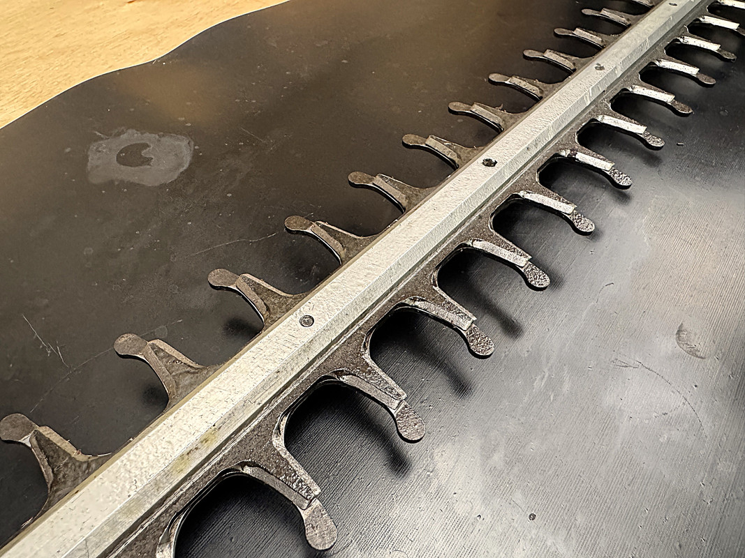

You can probably see the blades are covered in a sticky residue. That is not plant sap, but rather a coating of WD-40 Specialist No Drip, formally Spray & Stay. I stumbled across this when trying to find a substitute for Valco Cincinnati Gel Lube that Mr. Dactel uses, which as usual, isn't sold in Australia. The concept being that rather than drying, evaporating or dripping away, the sticky consistency stays adhered to the treated surface. The WD-40 product is not a total substitute for Gel Lube though, which can also be used as an engine assembly lube.

Sharp, greased, lubricated...............ready to CUT some bush(es)................

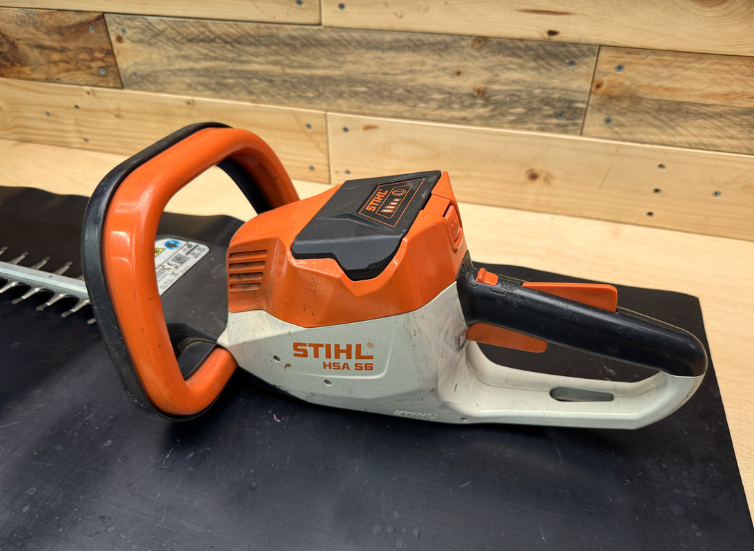

I bought this HSA 56 hedge trimmer in November 2018, my first battery powered garden tool. I paid a neat $500 for it, which included the AL 101 charger and AK10 battery. With how far Stihl have come with battery power, in 2025 you can actually buy the equivalent HSA 50 kit for $459. Considering how much work this thing has done over a 7-year period, today's $12 repair is a drop in the ocean. Amazingly, the batteries that power it are of a similar age, and touch wood, are still performing very well. Can't ask for more.
Comparing that to the petrol-powered Stihl HS 45 it replaced, well that's a completely different story. In addition to the $629 purchase price in 2010, between November 2014 and when it was retired in November 2018, I spent $280 keeping it in service via repairs (fuel lines ect) and blade sharpening. And that's before you add fuel costs, which with how you run a hedger at WOT all of the time, you end up burning through a lot of it! Plus, it was heavier, noisier, smellier. Also, the layout of them makes it awkwardly hard to start, balancing the machine in one hand and pulling the rope in the other, all the while not cutting yourself or a plant.
I love petrol power, but not when it comes to hedge trimmers! After sitting at the back of the shed for 6 years, I cleaned it up, replaced a broken primer bulb and moved it on.

Could you add a little bule locktite to that bolt?
