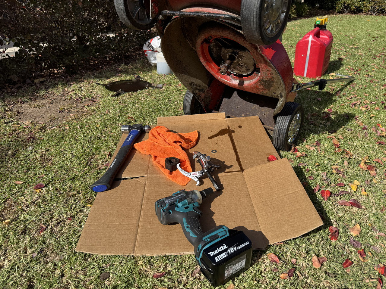

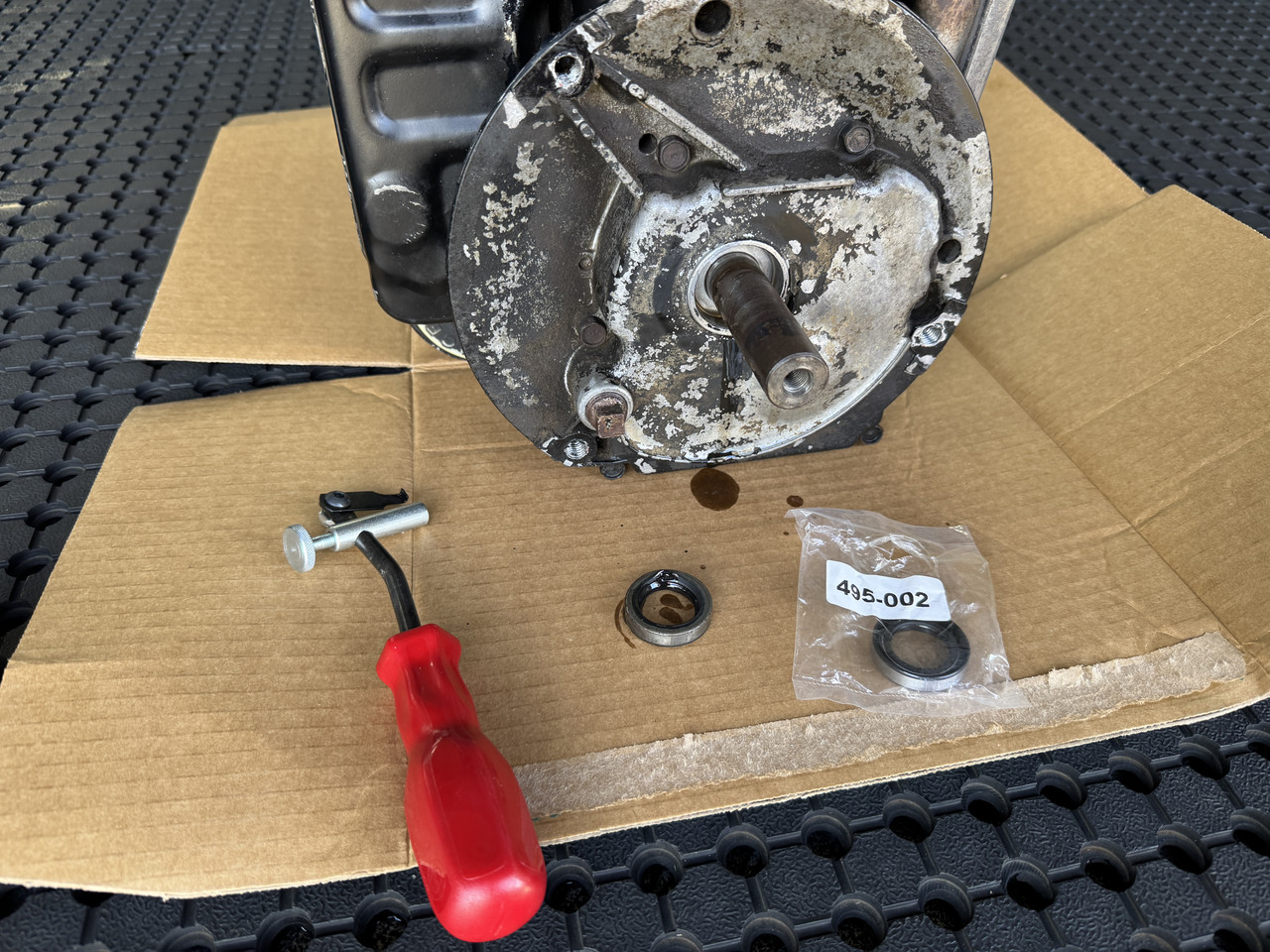

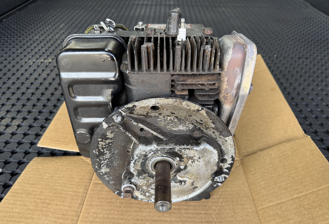

Some parts have begun arriving for the Rover Craftsman, namely the most important one, the lower oil seal. The one on it would be the original from 1986 and was leaking so badly that it had bathed the blade disk in oil.
Before removing the disk, I had syphoned the oil and fuel from the engine.
I didn't want to drop the oil pan to dig out the old seal, that would have required more work and considering its not leaking, I wanted to leave it alone. Either way, the blade disk and crankshaft adaptor needed to be removed. The disk was simple, one large 3/8 bolt and three 1/4 bolts. As I knew it would, the adaptor was frozen with rust. With a 3-leg puller attached, it wouldn't budge so I had to use the impact to buzz it off. The shear key was also rusted in place, which I needed a punch tap it free. I then removed the rust from the crankshaft with steel wool.
The oil on the carboard was what drained out with the seal STILL in place and the sump drained. Note the customary string wound around the shaft.
From here, I decided to remove the engine from the mower to improve access, its only three bolts and would make the trickiest part of this job much easier.

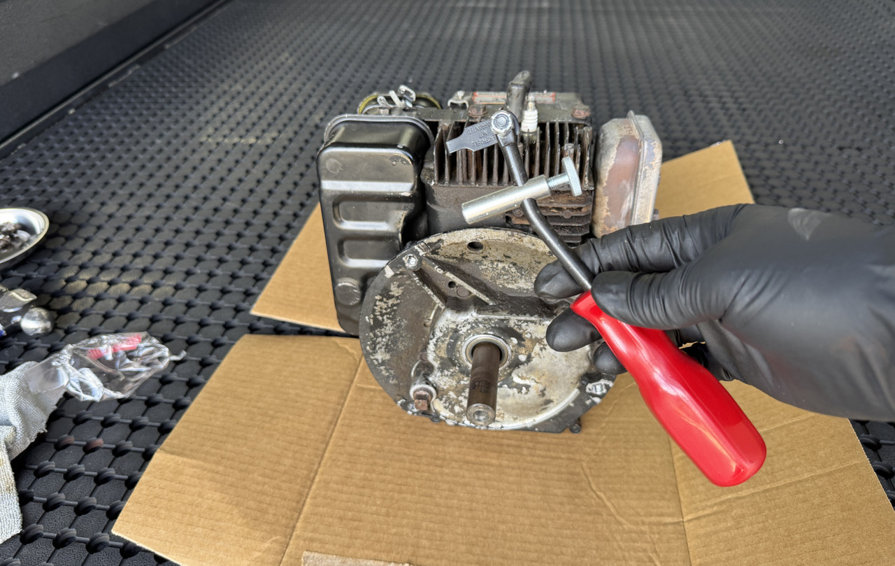

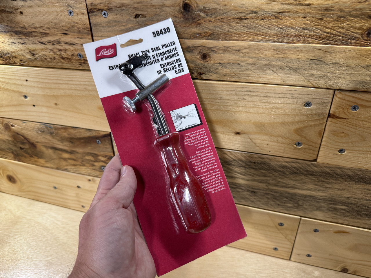

I've pulled seals before, done by driving a timber screw into the seal and levering out with a set of pliers. I'm not a fan of doing it that way, scratch the crankshaft and you've just destroyed an engine. A little online research and I came across this tool from Lisle, which at $34 I thought was quite a reasonable price, they are normally $70 at full retail. From what I can see, they were designed for camshaft seals.
https://www.amazon.com.au/dp/B000FPYW4K?ref=ppx_yo2ov_dt_b_fed_asin_title&th=1&psc=1
These are super easy to use, simply hook the "blade" under the lip of the seal, position the lever arm, then apply downward pressure, the seal then pops free without damage to the shaft or journal. I was dreading this part, but the tool made it a breeze, no grazed knuckles, no obscene language required.
After making sure to clean everything down, I put some oil on the new seal, Breaks & Scrappem part number 495-002, then gently tapped it home. The blade boss and key were reinstalled with a little anti-sleaze, the engine then went back on the frame, followed by the blade carrier after it was cleaned of all the oil. 600ml of Penrite SAE30 (I think it had 10W30 in it), fuel, and a test fire. Success.

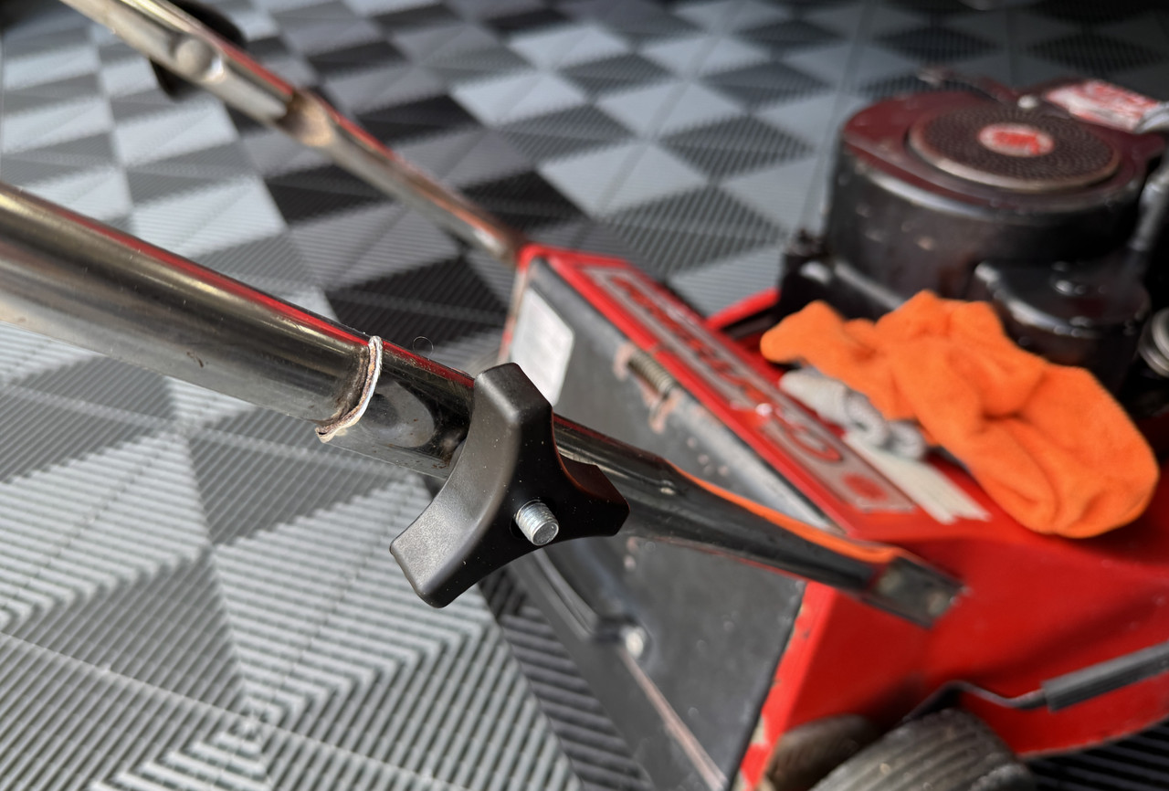

Next, I replaced the broken handle locks with some aftermarket replacements. While I was at it, buffed the chrome up with steel wool, which also removed the paint overspray. I would have liked the chunkier OEM type, but they are long obsolete.

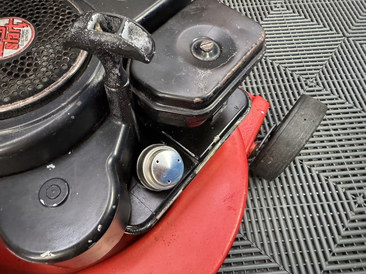

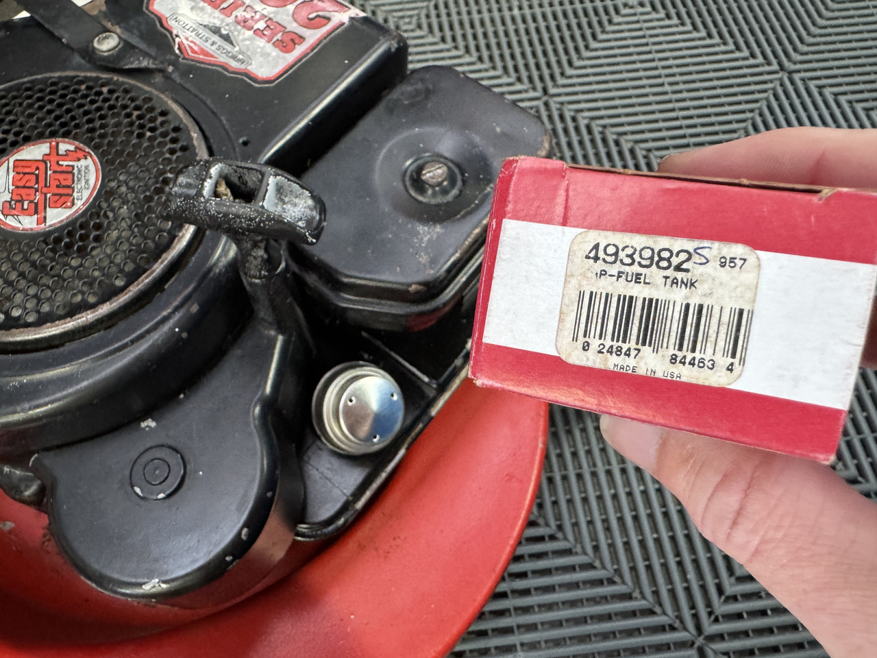

The final step was to replace the leaking fuel cap. I scored a bunch of NOS fuel caps last year, so it would be rude not to gift it a new one. These were always supplied unpainted like this.

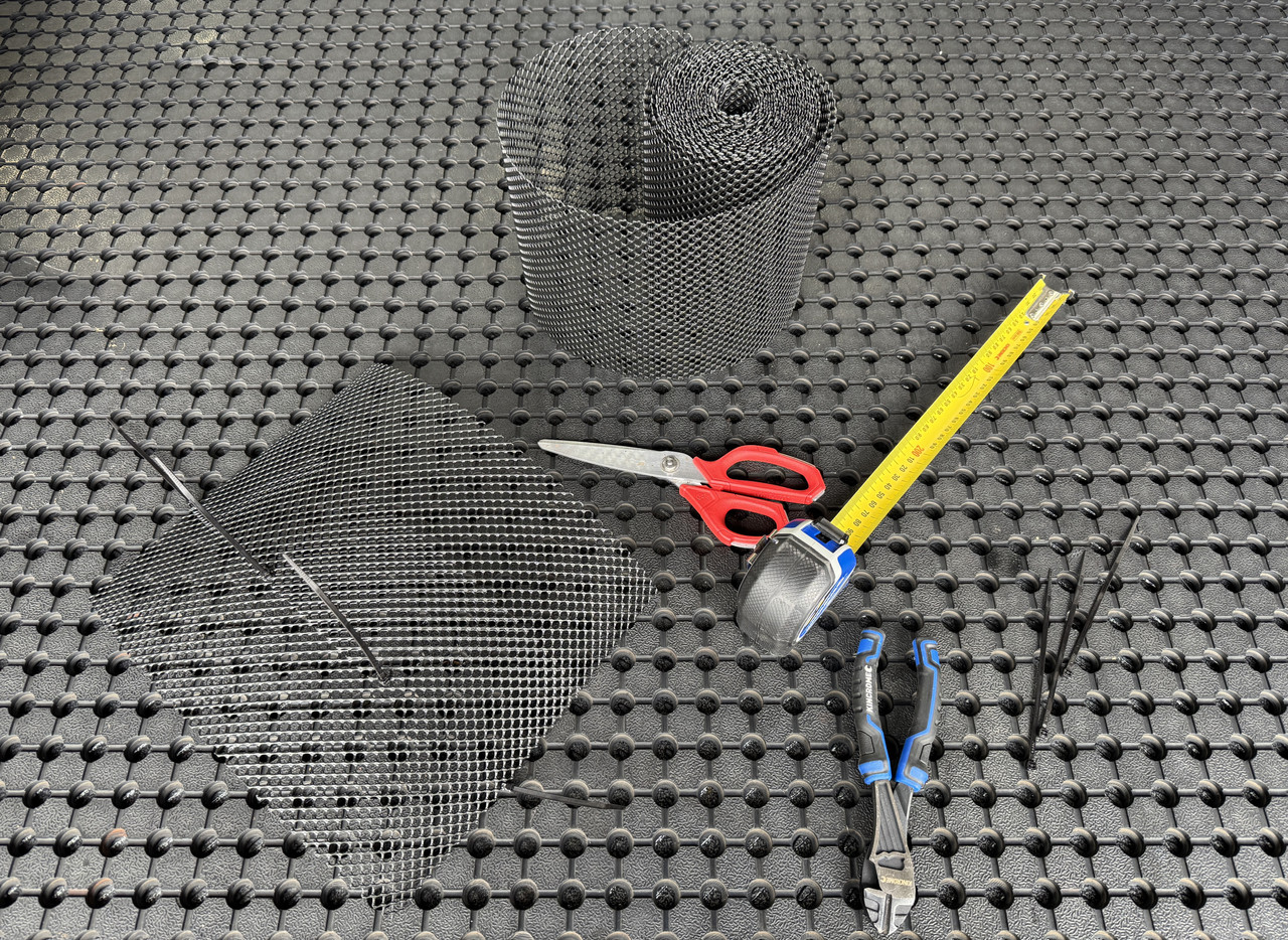

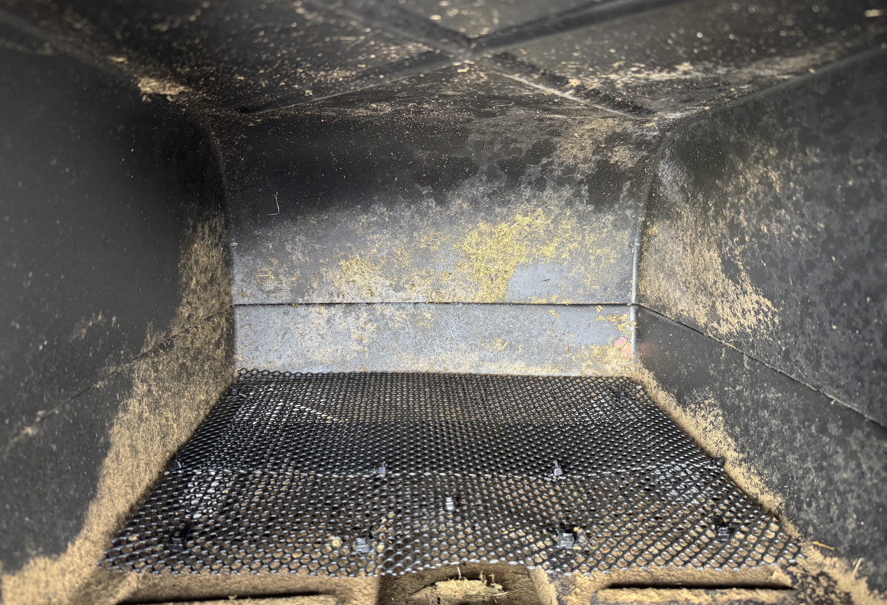

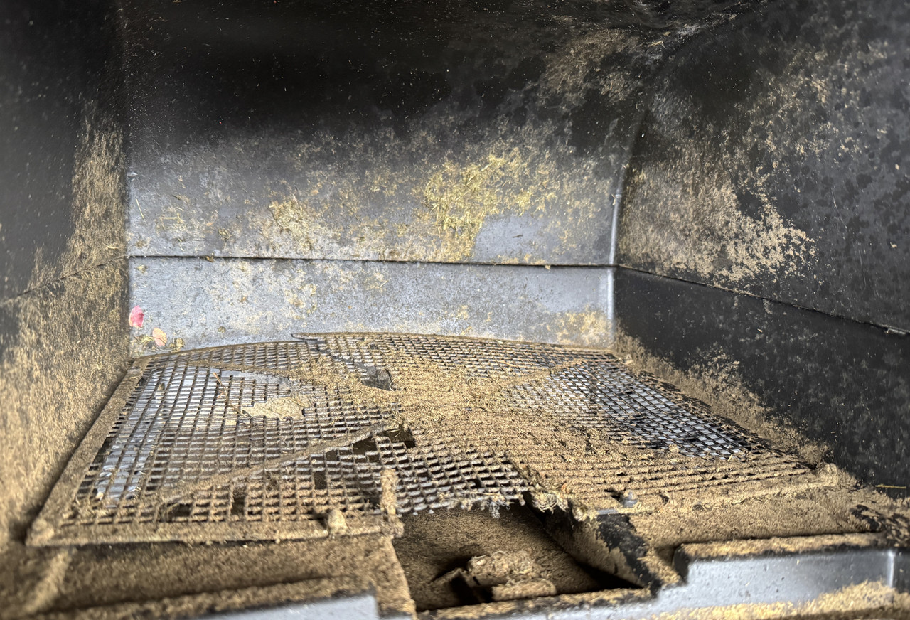

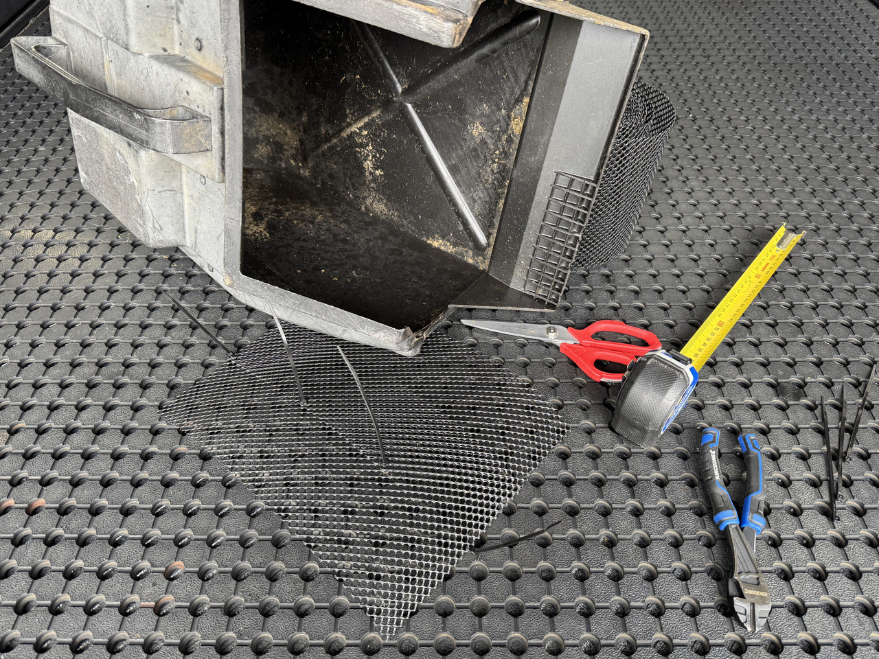

Got rained out today, so I decided to repair the catcher mesh on the Craftsman. Being plastic and 40 years old, it had broken in a few places but was still attached to the catcher itself.
Looking at the period parts diagram, there were two versions of this mesh insert, A03228 was plastic, and A03517 was steel. Which you got would depend on trim level, Craftsman was clearly a lower end model owing to the basic single loop handle, screw type handle locks, smaller wheels, and............plastic catcher mesh. Of course, these parts are NLA, hence me repairing what I already have.
I've done this repair before, of which was aided by a roll of plastic gutter guard. There are several types sold at Bunning's, but this particular one has a smaller mesh size to prevent clippings from passing through.
https://www.bunnings.com.au/jack-180mm-x-8m-super-gutter-guard_p3040589
Two strips were cut to equal length, then joined together with cable ties to form the depth. From there, I stitch this patch piece onto the existing mesh. Not the proper repair I'd like, but the best I can do without searching for another catcher.................which would also likely need such a repair.
You can see all the oil splatter in the catcher, blown in there from the leaking crank seal.
With 76cm of mesh and 10 zip ties, all up the cost of this repair was about $2.50.

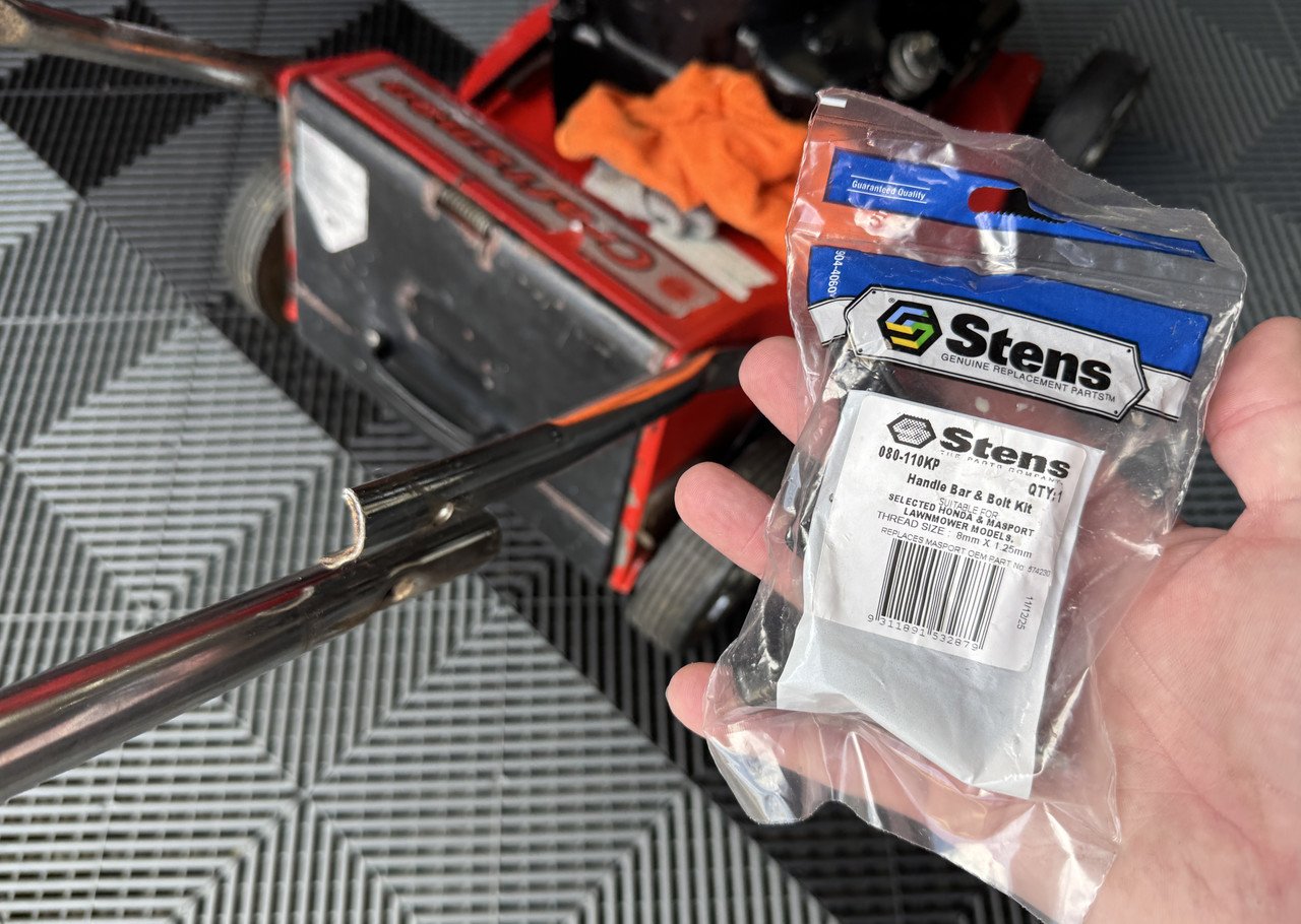

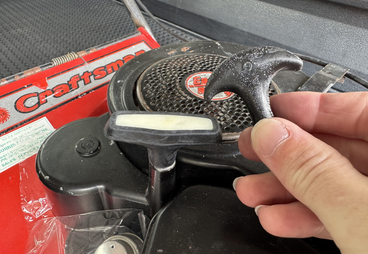

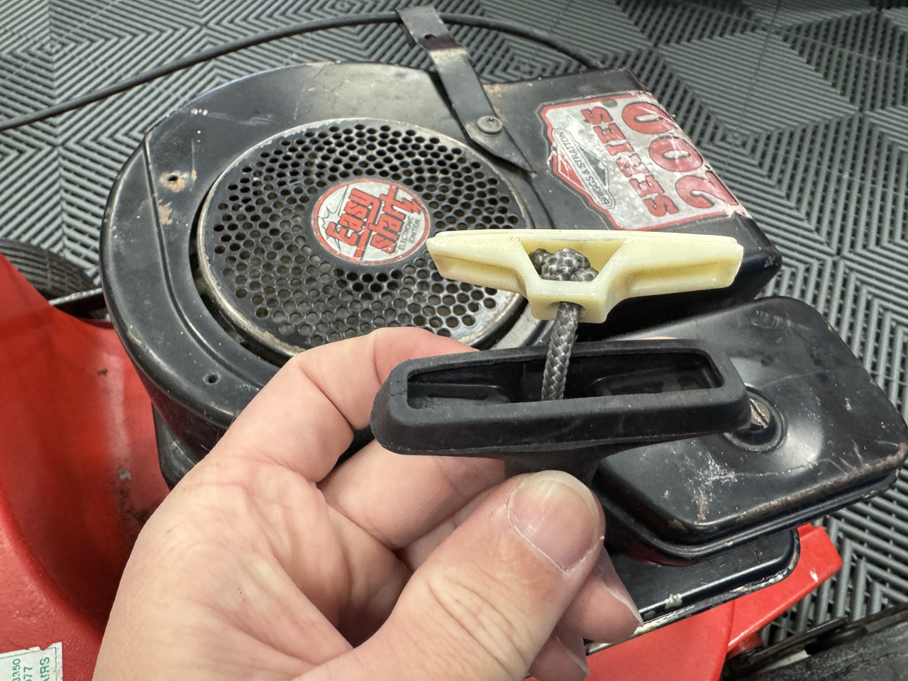

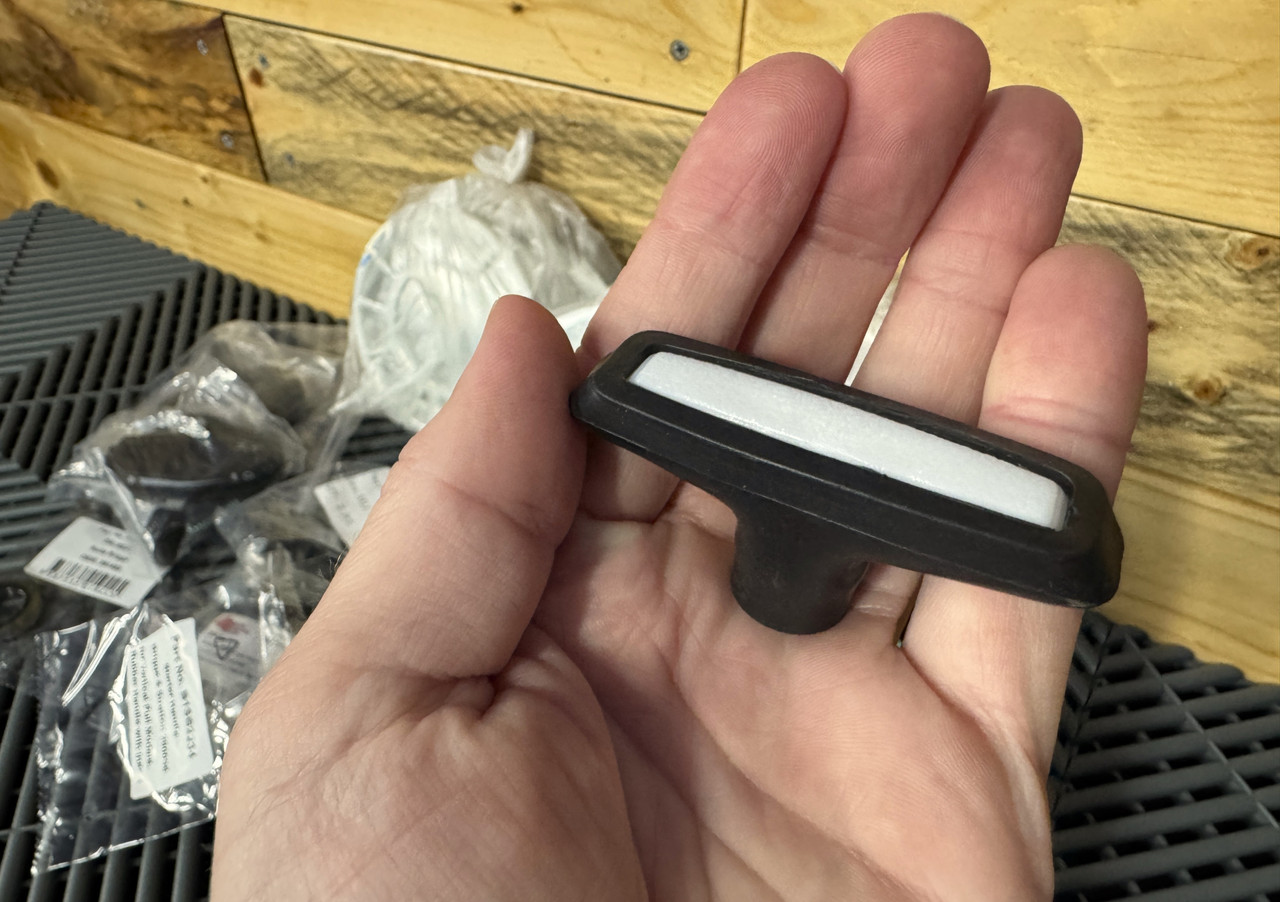

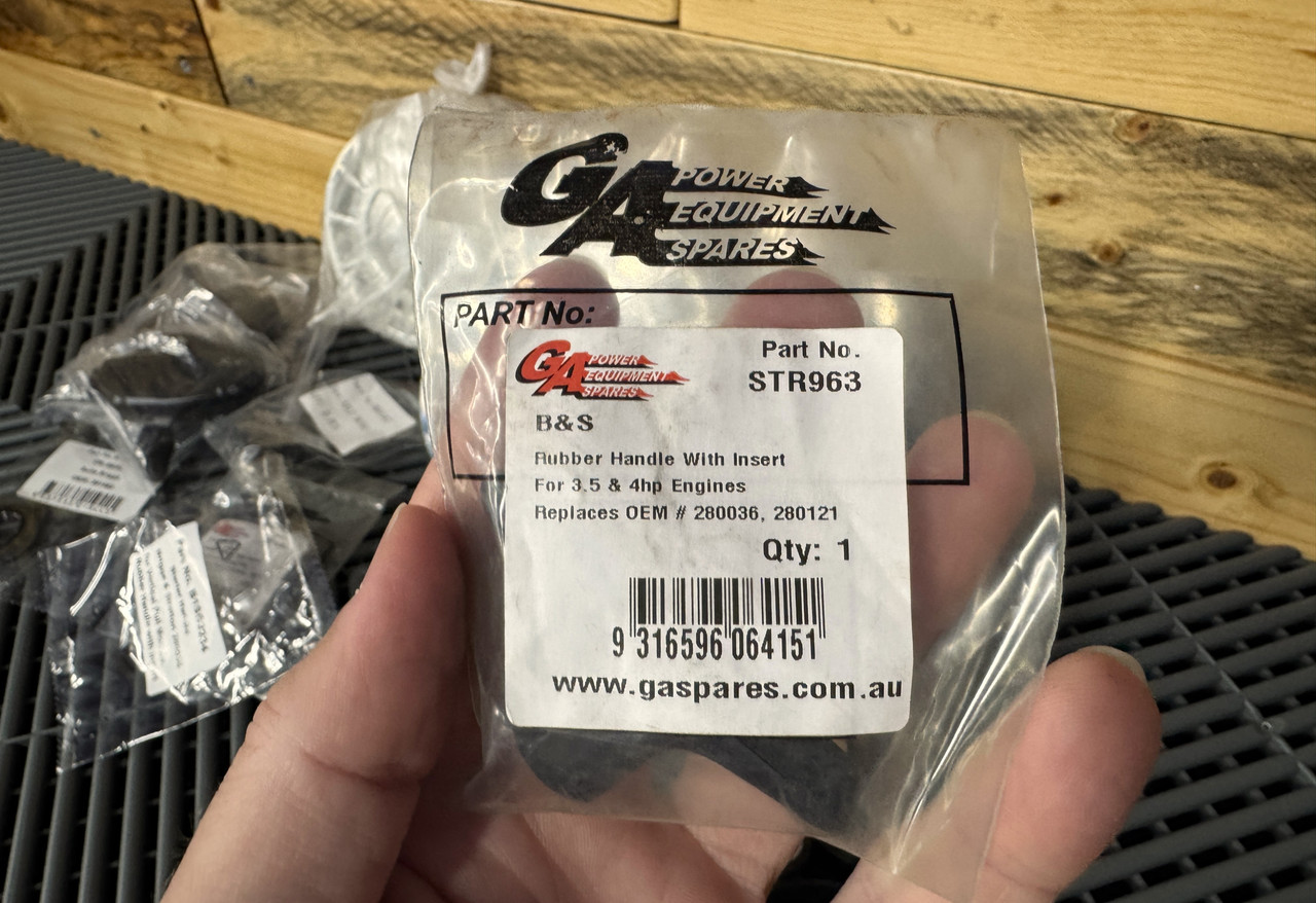

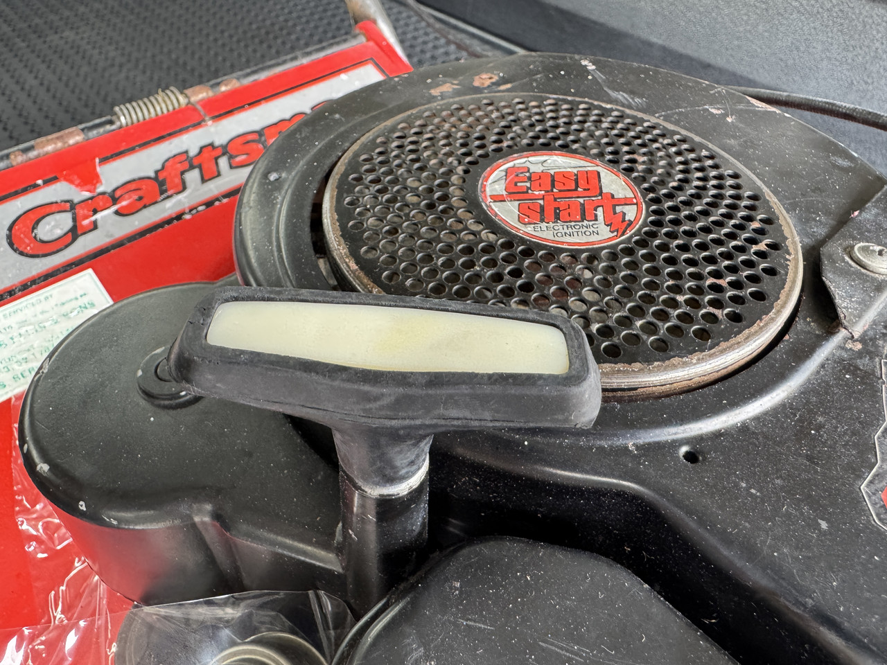

At some stage, someone had put a new rope handle on the vertical-pull recoil. I know that because they used an old Victa 2-Stroke handle. So what you say, it does the job. No, to a detail orientated person, I wanted the Briggs original.
The old Victa handle is a single piece design made from hard plastic, the type Briggs used for these vertical pull engines was a two-piece type made of firm rubber. These are now NLA from Briggs, but you can still get them aftermarket, in my case the GA Spares example.
Briggs & Stratton - 280036, 280121 (NLA)
GA Spares - STR963
Stens - 140-053
To install, you need to take the handle apart, removing the white inner section from the handle. After cutting the old knot and burning a new end on the rope, feed the handle onto the rope, followed by the inner section. Tie a knot and pull it firmly into the recess of the inner section, then snap the two pieces back together.
That tiny little change was oddly satisfying!

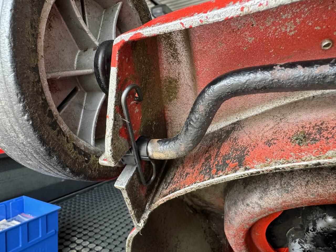

Next, replacement of the front axle bushes. I always replace these on any new (old) mower I get as I've had previous grief in that department. But why not the rear bushes as well? Because of how the rear axle is fixed to the chassis, I've found they never need replacement. On domestic-grade mowers like this, the front axle is mounted using wire retainer clips, which in turn wear and fatigue over time. On professional-grade lawn mowers, each axle mounting is bolted to the chassis, in turn limiting wear caused by excessive flex.
In this case, the front end was feeling sloppy, which I attributed to worn out wheel bearings and the axles bushes. I've decided to put new wheels on the mower instead of just bearings, so for now I'm sorting the axles. I'm glad I did because they were quite worn, I also replaced the retainers as a precaution.
Bushes - A03450
Retainers - A03442
This is why aluminium chassis mowers are the superior machine. The axle recesses are far more durable than a pressed steel chassis, and in turn gives you a higher level of tolerance to worn out bushes. Go too far with a steel deck and it's off to the junk yard. Ask me how I know.
Those bushes worked wonders, they took out 95% of the slop.

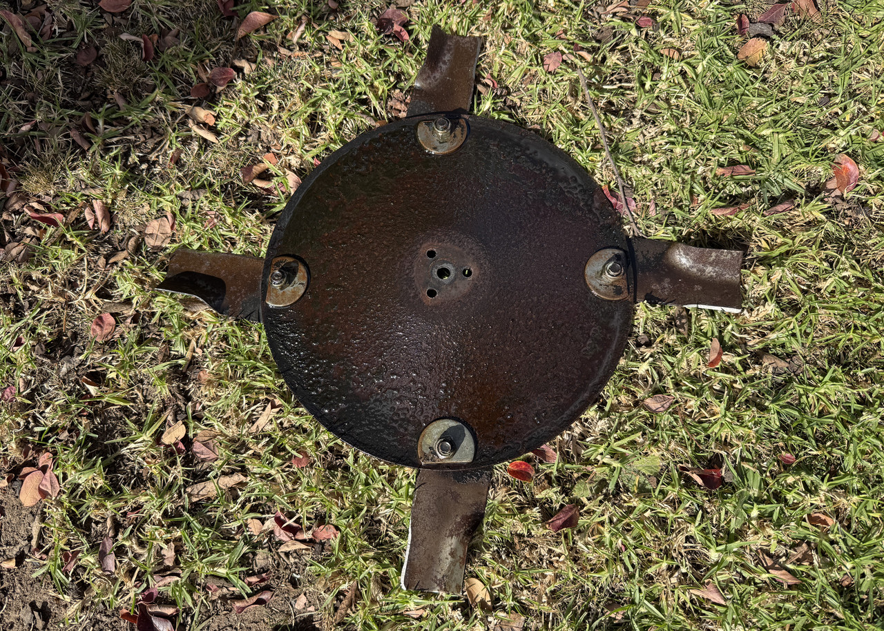

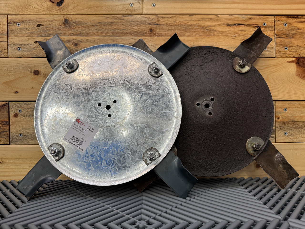

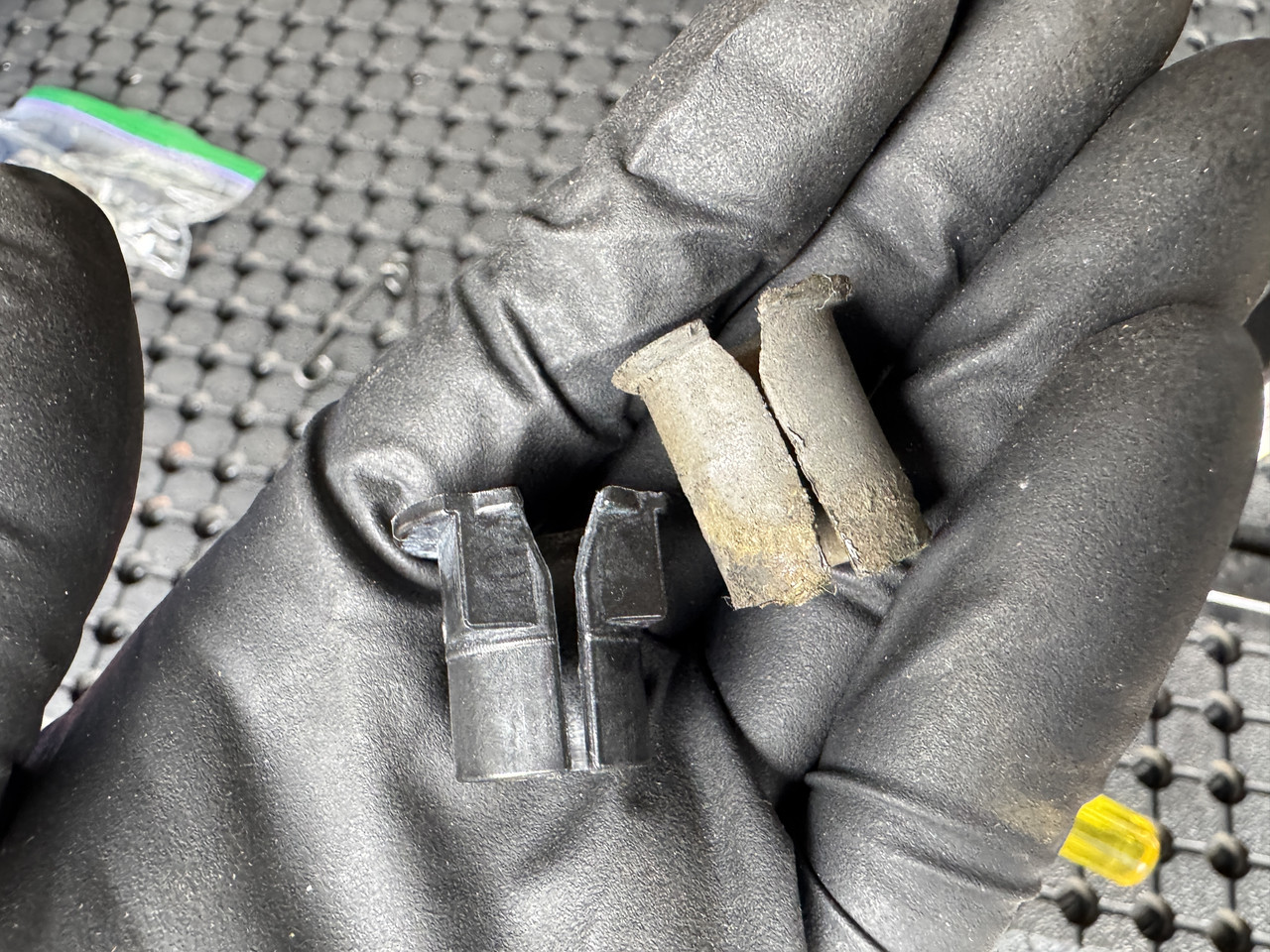

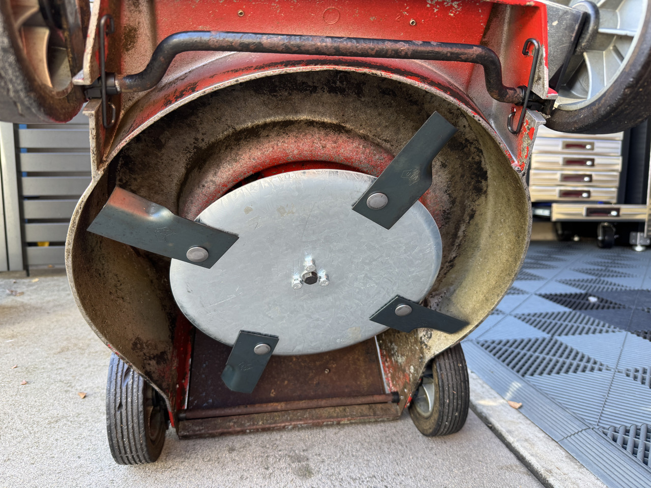

This was a job I had planned for later in the week, but I just couldn't help myself.
The blade carrier and the four mounting bolts on the Craftsman were heavily corroded and not something I was confident trusting. The blades had been sharpened, but they are cheap enough that I decided to just replace them too and start from fresh.

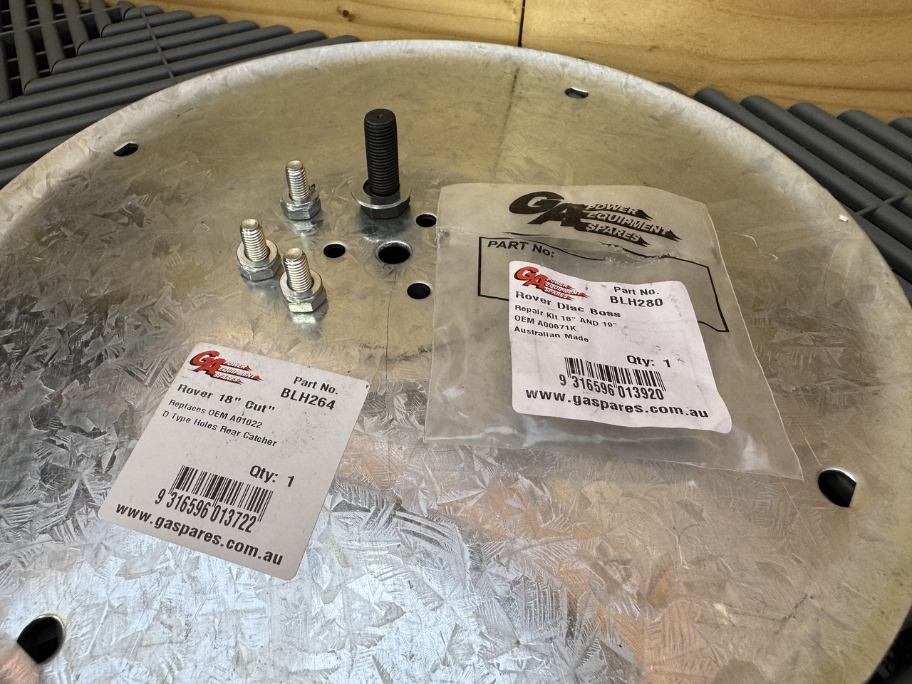

So, for peace of mind, I went ahead and ordered a new blade carrier disk with a set of replacement mounting hardware. I had also put a few witness marks on the 3/8" central bolt when removing the boss from the crankshaft, and the three smaller bolts with spring washers have a habit of snapping in the boss, so replacing those was preventative. The kit includes a new woodruff key, but I wasn't removing the blade boss again to do that.
Rover Blade Disk - AO1022 or BLH264 (GA Spares)
Rover Blade Boss Repair Kit - BLH280 (GA Spares)
Rover Blade & Bolt Kit (4) - A03830 or BNC6336
Rover D-Washers (4) - AO1025 (From NOS)
While fiddly to align, I much prefer the design Rover went with on these carriers. Firstly, it prevents misalignment compared to the Victa design, which uses locating ears on the boss with a corresponding shape in the disk. On the Rover, run down the large 3/8" bolt into the crankshaft by hand, then align the disk using the small 1/4" bolts, the rattle all four tight. Secondly, you have a degree of redundancy. Both Honda and Bushranger use the same four bolt design.

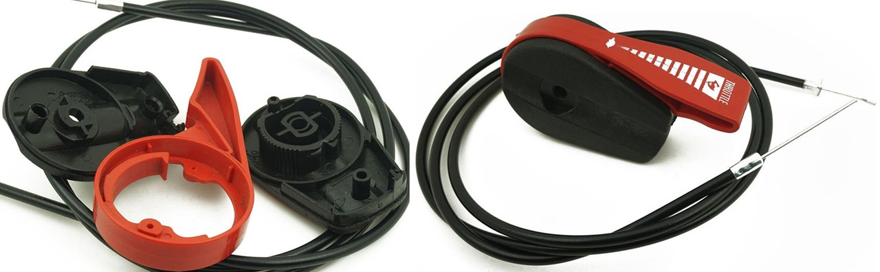

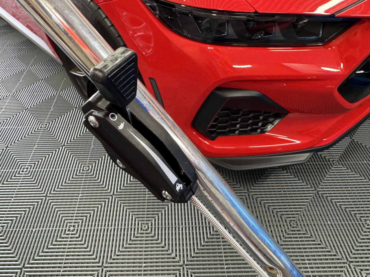

I then turned my attention to the throttle. The previous owner had recently installed a universal throttle controller and cable. Apart from it not being the OE design, I just don't like those throttle controllers. If look at the image below, they have a mild ratcheting function, which in use makes the lever action stiff. So, replacing this was equal parts functionality and looks.
Rover Throttle Controller - A00950K
Rover 54" Cable - A03249, A03106 or CAC460

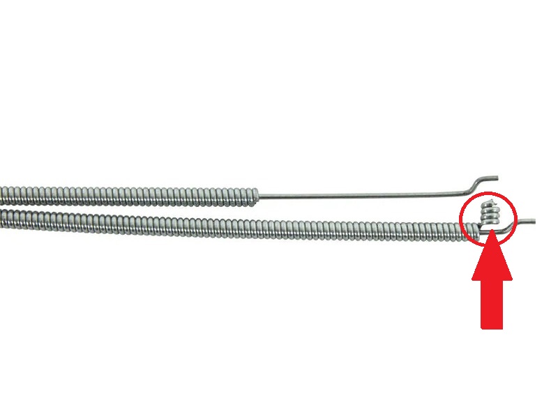

If you were wondering why I didn't just swap the cable over to a Rover throttle controller, well that's what I had planned on doing until I realized Rover-specific cables are different to most. Firstly, the universal cable has a pressed retailer so that it holds the cable snugly in the controller. The Rover controller can't accept that. Now, you could remove that retainer, but then there is another Rover quirk to contend with, and something I didn't even know about until now.
All throttle cables sold as being specific to Rover have what looks to be a manufacturing defect on one end, circled in red below. In essence, this is basically a few loops of the outer cable folded outward. Well, what looks to be poor workmanship is actually intentional. Those folded loops press into a recess within the controller housing and basically lock the cable in place, preventing it from coming adrift of the controller when in use.
With the correct length and throw of the new cable, and the specific Rover controller, this setup works so much smoother and well worth the time and effort getting this right. I always used to think those little Rover throttle controllers were cheap compared to what other companies went with, but I've since come to appreciate them. They are simple, smooth and easy to operate, not over designed for the sake of marketing prestige. You could probably say the same for mowers in general.

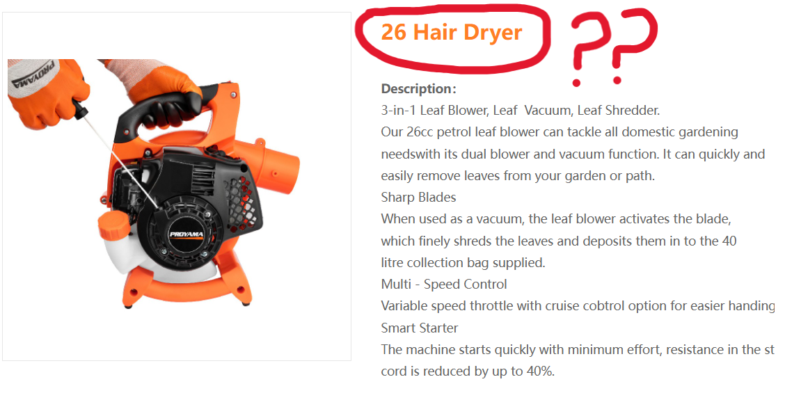

I've been researching cheap handheld tools for something I'm working on and came across this -
That's not the only mistake I've come across, this cheap stuff is littered with spelling mistakes, inappropriate word selection, and incorrect terminology. If they can't get the product listing right, then what does that say about the tools themselves?
