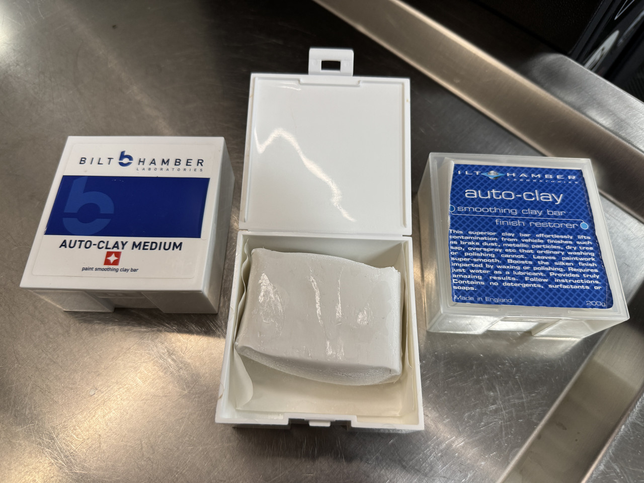

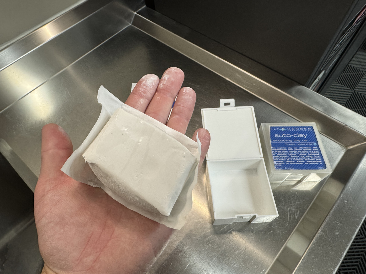

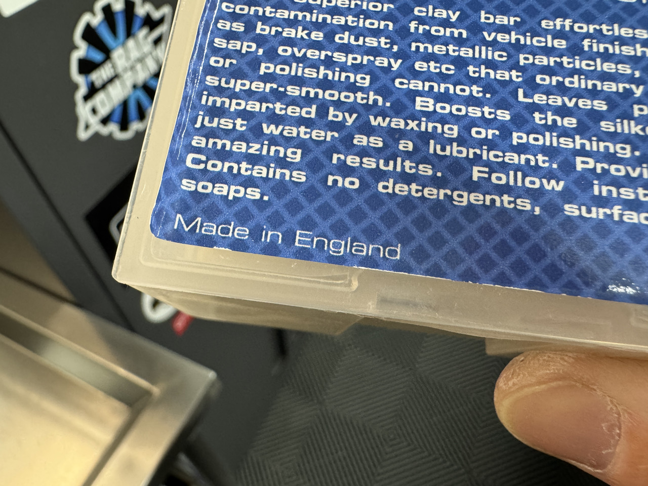

Has anyone tried the Bilt Hamber clay bars? I was sent all three but only briefly used the "regular" version, which I found too grabby and hard to knead for my liking. Strangely, the come laced with what appears talcum powder, wrapped in paper and sealed in a plastic container.
Regular –
If the vehicle is heavily contaminated, has never been clay-barred before, or it’s hot summertime then use Regular. All clay bars become firmer when cold and softer when warm.
Medium –
For paintwork that is in a reasonable condition, Medium will be preferred. The easier folding of the clay to expose a fresh working surface will be very beneficial.
Soft –
If paint is in good condition, if you like to clay your vehicle frequently or indeed if the weather is cold, then use Soft.
Our clay bars are designed to effortlessly restore the factory smooth finish to paint finishes. They have received critical acclaim in the detailing industry for being the most durable, cost effective and well-designed clay-bars available today.
Auto Express magazine, a giant in the car magazine world, has awarded Auto-Clay with their Best Clay Bar Award every year for the last five! Also, they compared the clay-cloths to clay-bars in one recent test, where they concluded that bars were better, and that Auto-Clay was the pick of the bunch once again!
They are generously sized, 2.5in x 2.5in x 1.0in and made in England.
