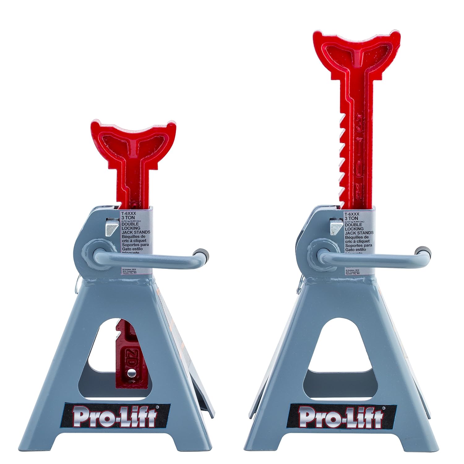

I used to put 4 jackstands up and changed my exhaust but now thinking back that was pretty dangerous. My are isn't sloped and should double check with balance meter but should be ok. Anyways, i'll be putting different exhaust on my other car this time.. What is good method to get the car raised and do so. Was told to get the jacks up and put tires or something underneath.
here's one with a 6 ton capacity and has a locking pin for safety. $50..
another pair (3 ton capacity) for under $30...
or make some like this gentleman. probably the safest option...
I would use cement blocks/6x6 wood instead of "tires or something"....
