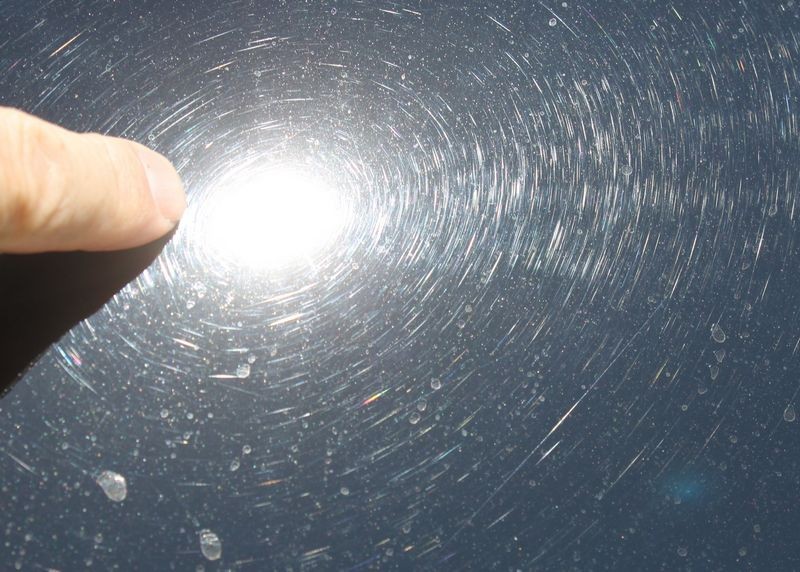

Changing my position to look across the panel is especially required on white panels... Often means I am on the floor to find em... Family think I'm nuts... View attachment 52117
