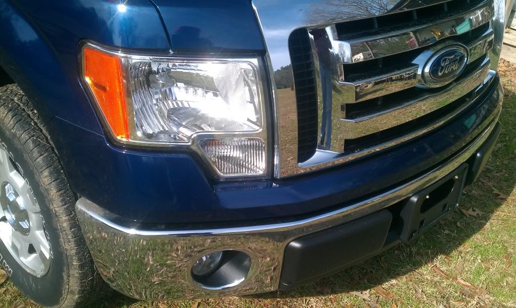

Greetings all! Im a newbie all the way when it comes to detailing. Up till now, ive always owned older vehicles and never cared what they look like. The ole lady and i recently purchased two newer vehicles. A 2011 camaro, black with the glossy orange stripes. And a 2012 f150, blue with running boards.
Ive been reading here and there for the past few weeks about different products and techniques. And ive beeb picking up things here and there that i thought id need to tone my skills and make our vehicles look as good as possible.
Early on, i read some good things about Magueiars products so everything ive gotten so far chemically is magueiars. Im looking to hand polish/wax both vehicles this week. Havent gotten the clay bar set yet cause i was a little scared since im a newbie and all. However, after recently washing both vehicles and examining things there looks to be some impurities here that may benefit from a little claying. So ill be picking that up this week.
Anyhoot, my question is what should i avoid polishing and waxing? The f150's front grill is made of plastic and is chrome painted. Headlight covers? The glossy orange stripes on the camaro are not a dull matt finish, so im assuming i can go easy but polish/wax that. And the bumpers on the f150 are chrome i believe. Should i be buying another product for the bumpers?

1. What am i to do with the chrome painted plastic grill on the f150? Hand polish with the car polish?

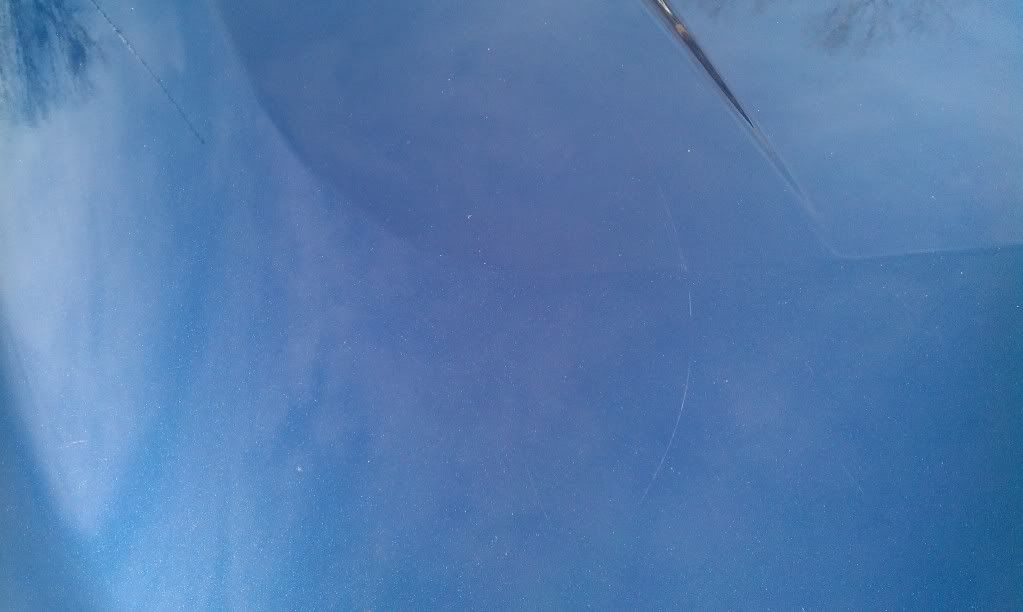

2. Is the polish im using good enough? ( pic at bottom of post) Or should i polish with something else first? There are some swirls id like to eliminate.

I've used the PC, the Megs and the Griot's DA Polishers and they all work very good for removing swirls especially compared to the TOB or to working by hand.
The key is to get thin foam pads, the 5.5" LC pads work very good or go with the Meguiar's Microfiber DA Correction System. Note how Meguiar's designed their MF pads to be thin? As did Lake Country, so there's a reason for this and that is thinner pads are better for transferring the power from the tool to the paint surface.

Hi, and welcome to the forum.
Not sure if this has been mentioned, I did do a brief browse through the thread.
You've asked about polishing things like the Chomed Plastic Grill, and other items like Headlight, or Tail Light Covers Lenses?
As for any Chrome Plated Plastic, I would not resort to any heavy duty abrasive Polishes on such, especially since they're all relatively new-new, as you'll likely do more damage than good. A gentle Car Wash Soap-Shampoo should be all that is needed at this Point in time.
Use waxes, or perhaps even better yet, a Synth Sealant to seal, and protect these Parts, it will help make them easier to clean when they get dirty, or removing bugs. Any of the Wipe on Walk Away Sealants might be ideal. The pricier ones (GTechniq-Opti-Coat-CarPro CQuartz etc will be optimal, and the most durable.) Yes, more expensive up front costs, but probably actually more economical in the long run.
As for the Plastic Light Lenses, resist the urge to use any sort of Abrasive Polishes at this point. Again, you'll actually do more damage than good, by abrading off the protective UV outer layer of the Plastic.
Again, Sealant products, like I mention above, a clear wipe on-walk away type would be perfect, to seal, and protect these parts. The better you care, and protect these parts with such durable sealants, the longer they will last, and stave off hazing-clouding.
Waxes might offer some protection, but many waxes also contain strong petrol solvents, and might not be ideal for such parts.
Hope this helps. Mark
