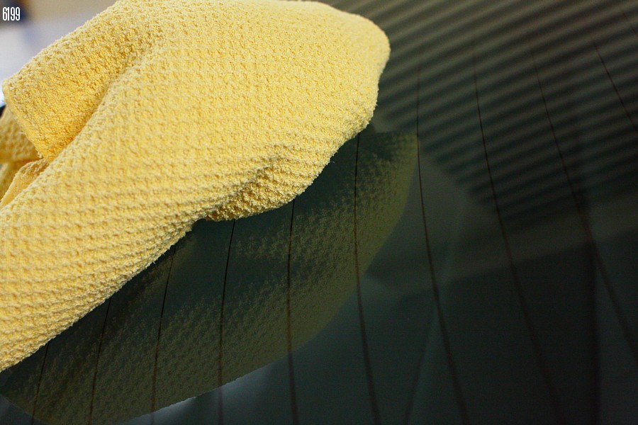

I never used Menzerna, but the previous member convinced me when I started new to all this to try HD speed... I am extremely satisfied with the results I have been getting. In case you haven't seen this yet, I HD speed this in the recent month.View attachment 37963

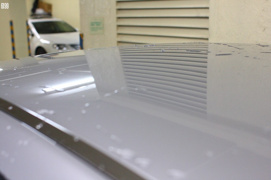

And I tested speed on my own car about ten days agoView attachment 37964

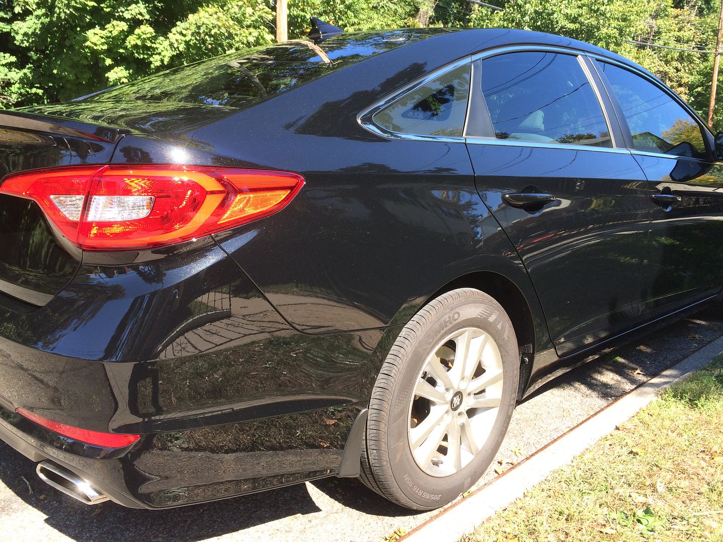

If you have a black or dark colored car and don't want to spend much, I really like Meguiars Black Wax. I only have the 4" DA Power System, but I did a quick pass on my '15 Sonata this weekend and got pretty good results considering one pass with the yellow polishing pad at moderate speed. Really cleaned up the light swirls and made the metallic pop. I'm sure if I do an additional pass or so with a little more pressure I could clean it up even more. Good protection and beading too with the carnauba in it.
Not the best light, but it gives you the idea.
