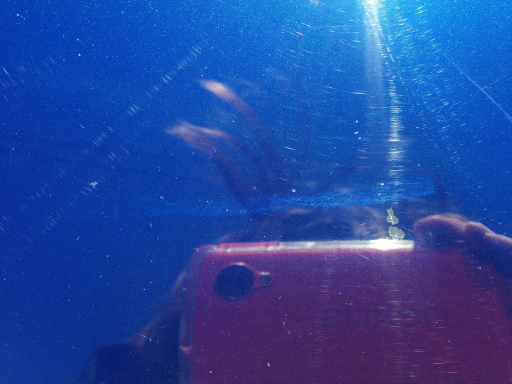

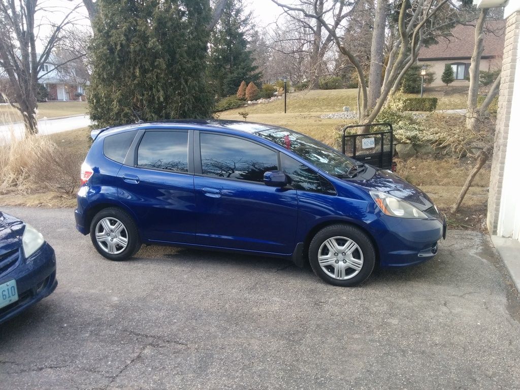

I just bought a Honda fit and it has bad swirls and a couple deeper scratches. The paint is thin just from looking at the chipped areas and scratches very easy. I have a PC polisher and white, orange and black LC pads. Any suggestions on what compounds to use or stick to just a polish and orange pad?
I also plan to seal it with cquartz uk.
Menzerna SF4000 , FG400 would knock out those swirls but since the cc is thin, just polish...
Hondas usually have quite soft paint. I would start with a polishing pad and light/medium polish and work up from there.
I did a fit a few months back and used 205 with the megs MF. Paint reacted well here's a 50/50.
