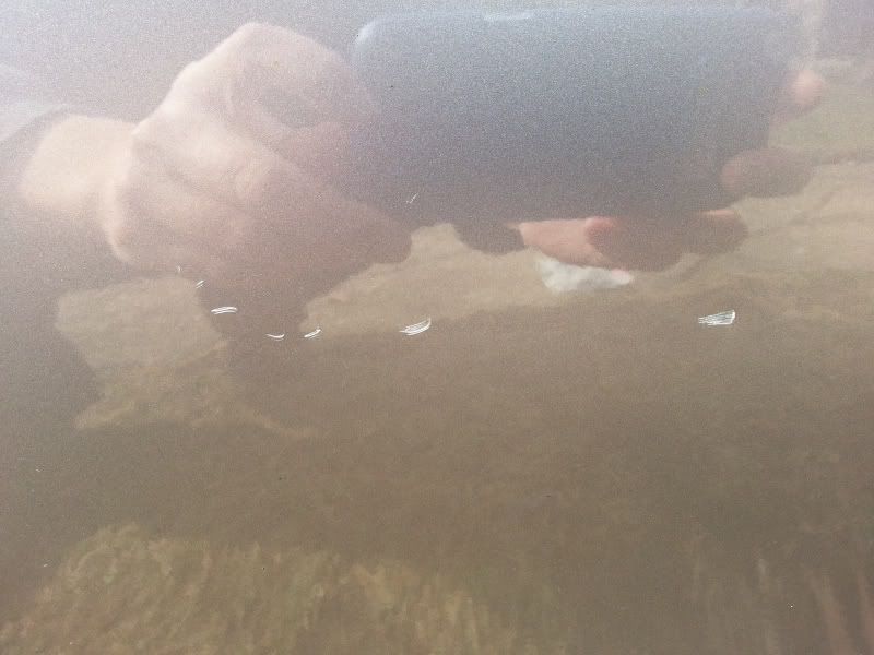

I recieved a lovely bunch of nics in my passenger rear door while parked at work. All I have on hand at this point is the touch up marker from the dealer, my polisher, and detailing supplies. I was thinking of filling it with the touch up paint, then lightly wet sanding, then compound it out with fg400, then finish it. Obviously allowing a cure time in between the touch up and the polishing. Here is how it looks:

If I couldn't afford a repaint I would glob touchup paint onto the area (after cleaning thoroughly first) Allow 24-48hrs then wetsand / polish and hope for the best
Are you sure those spots need paint. Does it catch with your fingernail?

That's a solid plan. Hard to tell but looks like some are down to primer or even bare metal. If so get some touch up primer to layer in before the color coat. They even have clear coat pens you can use after the color coat drys. Then sand and clear, compound, polish, wax and call it a day.
Should come out pretty darn good if you take your time.
The reason for using primer is so you don't wind up with 15 coats of color to fill the scratch making the color coat darker than the panel. 5 coats or layers is ample. I like using a fine tip modelers paint brush for dings like these. Even tooth picks can help wedge paint in but be careful of putting too much in at once.
You are right on the money with your thought process. Should work just fine.

Yes I can feel every one of them. Thanks for the advice guys.

Whatever you do don't apply the clear coat they supply. That will ruin your color match for sure
