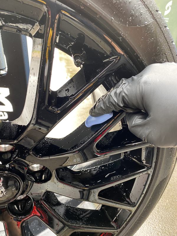

Most certainly don't re-use a clay bar after using on wheels. I just tear off a smaller piece rather than sacrificing and entire bar. Also, don't waste time with the synthetic clay towel/mitt/sponges for this role, you absolutely need the extra ability of a real clay bar here.

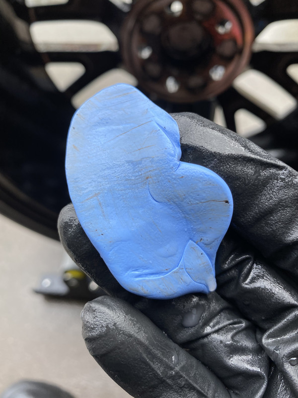

Claying these things was a nightmare!
Below was what I pulled after an extremely thorough chemical decon, including tar remover, iron remover and high pH wheel cleaner.
Wow, not envious, looks a major undertaking.

On those wheels, I had just removed them from the car after getting new wheels. I had no indentions of them going back on the car, but felt compelled to clean and polish them up. If you thought claying those wheels was a major undertaking, just think about polishing each spoke! I didn't bother coating those wheels, just wiped them down with Bead Maker before loading into storage. Actually, I put them back on the car when I traded it in on the new car.

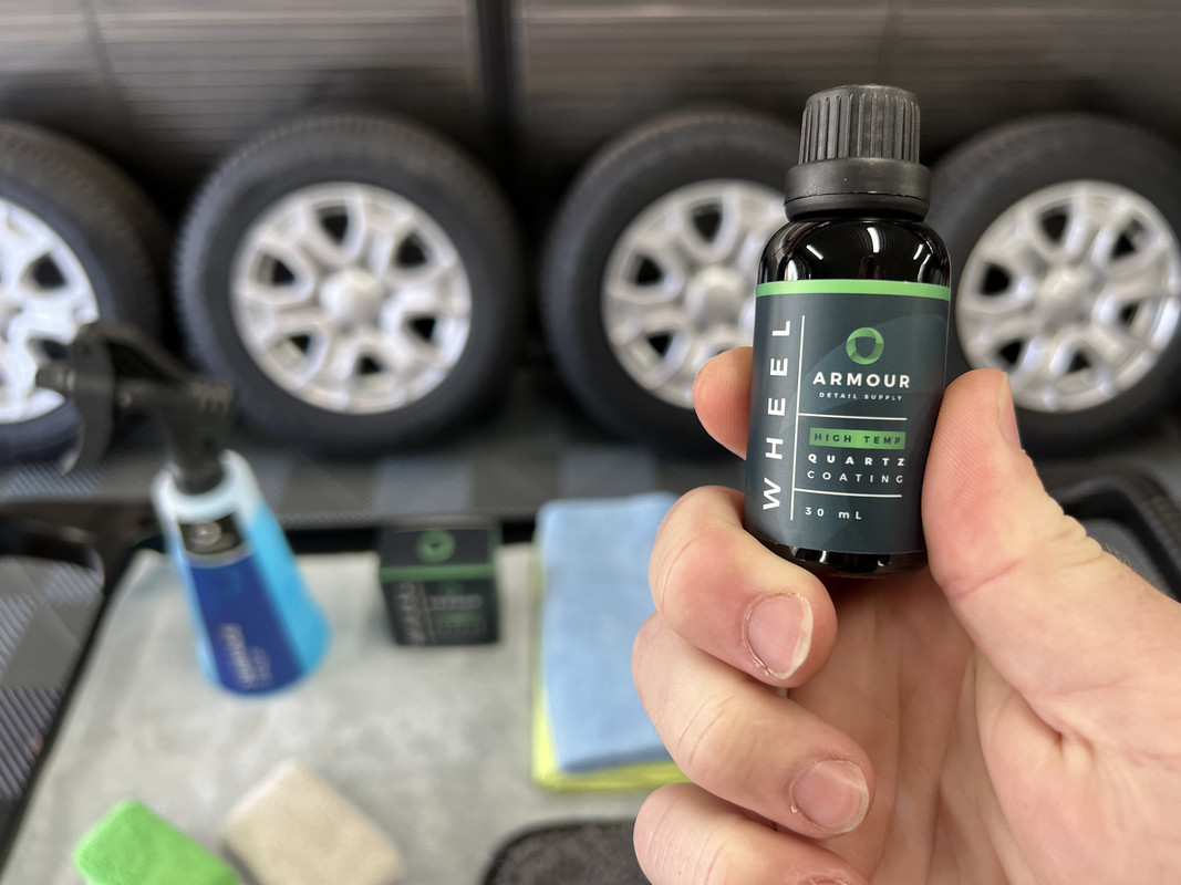

The first wheel coating I tried was NV Wheel, but I didn't like it, very lacklustre in terms of hydrophobics and slickness.
I've since moved to ADS High Temp Wheel Coating. I've used this multiple times now, even coated a lawn mower with it. I like this coating because it has excellent hydrophobics, is slick without toppers, and seems to be lasting very well. Actually, it's my favourite ceramic coating. Yes, you pay more for this coating, but I think its worth it. ADS recommend two layers an hour apart, especially on matte or satin finishes, you can get by with a single layer on clear coated wheels.
I know some have questioned the point of dedicated wheel coatings, and I certainly don't buy into the whole "heat tolerance" thing. I'd wager a hood or roof panel is going to get hotter in the summer sun that what a brake rotor would radiate outwards. I also know some have questioned the longevity of this particular ADS coating, but that's not something I've noticed across several wheel sets, including a daily driver. But then I regularly wash and maintain the coating. I think many who coat wheels think its a green light to neglect them because "its coated".
What claybar are you using?
