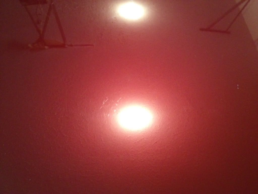

Well I got the "damage" polished off, too the least aggressive option I have available, ultimate polish and a tangerine pad. Here's the best before shot I could get:

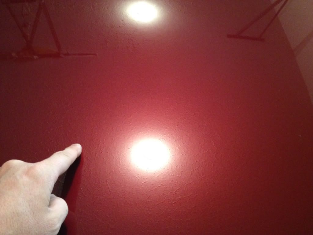

And here it is in my garage:

Am I seeing things, or does that paint have a texture to it? Maybe its just the picture???
lol, yeah, textured ceiling.. Sorry. lol
The scuffs in the second photo would be just above the light, to the left.
