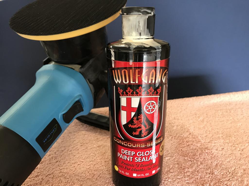

What Is It and What Does It Do?
Deep Gloss Paint Sealant is a cross-linking polymer paint sealant, which the Wolfgang Concourse Series was originally designed around. Longevity is said to last up to 6 months, anecdotally, that figure is optimistic at best. Having said that, I can get a year out of it on a garage queen. Wolfgang also make note of the anti-static properties DGPS provides, helping to repel dust, dirt and grime.
There are a few key reasons why I come back to the product –
- The glossy, wet look it creates. After application, Wolfgang suggest that the “paint looks like a clear glossy coating was just poured over it.”
- The slickness!
- The depth that it adds to paint, enhancing the colour beyond its natural state.
- Hydrophobic qualities that rival fancier ceramic coatings.
Naturally, paint protection technology has moved on since this product hit the market, including within the Wolfgang’s own portfolio. As such, Deep Gloss Paint Sealant is hardly the last word in durability or longevity, be that among newer ceramic coatings or even similar polymer sealants. For use on a daily driver, this is probably not the best choice. For pampered garage queens, this is a truly wonderful paint sealant that delivers supreme gloss, slickness and hydrophobic qualities. And for that reason, I think there is still a place for this product.
Where and How To Use
Wolfgang Deep Gloss Paint Sealant can be used on all painted surfaces. This is another product I would avoid getting on unpainted rubber and plastic trim, it will otherwise stain. And just like Collinite 845, there are few quirks to its application.
This product can be applied to the car by hand or via machine. I prefer to use the machine with a black waxing pad to speed up the process and ensure even coverage, swapping to a small foam hand applicator for intricate areas like the wing mirrors and front bumper.
Application -
1 - Wash and decontaminate the car, polish if needed. Follow with an IPA-based prep spray such as Carpro Eraser or Gyeon Prep.
2 - Prime the pad (hand or machine) with a semi-generous amount of product, squeeze or spread to distribute.
3 - Working panel by panel, apply a thin coat to the whole car, reapplying product to the pad as needed. Remember, a little goes a VERY long way.
4 - You then need to be patient, DGPS needs to sit for untouched for 30 to 45 minutes to set up.
5 - After setting, start removing the residue with a microfiber towel, starting where you began the application.
6 - The curing of DGPS is activated by oxygen, so exposure to moisture during the first 12 hours will compromise proper curing and tamper with the long-term durability. So, think ahead.
The end result is a rich colour enhancement with deep reflections and exceptional slickness......................
Tips & Tricks
- Shake the bottle! It’s very important to shake the product prior to and during use as DGPS does tend to settle and separate in storage.
- This applies to most waxes and sealants but it's worth repeating, apply thinly! The pain of trying to plough throw excess sealant is easily avoided.
- I prefer foam applicators for sealants and waxes, but a microfiber applicator can be used if desired. For machine application, choose the softest pad in your system, in my case its usually a ShineMate or Lake Country black foam pad on the lowest speed setting.
- This is another product that’s extremely difficult to remove from your applicator. You will need repeated applications of APC or pad cleaner, running warm water and plenty of patience. All would be forgiven if the pad was simply thrown in the trash!
- The 45-minute wait for DGPS to cure is not as bad as you think. By the time you have applied it to the whole car, cleaned up your pads, removed your taping, its usually ready to be buffed.
- DGPS is best applied and then left undercover for 12 hours, in a garage if possible. This is to limit moisture interference. Otherwise, apply earlier in the day to give the product enough time to cure before dusk and dew sets in.
- After 12 hours, DGPS can layered with a wax, but to be honest, you really don’t need it.
