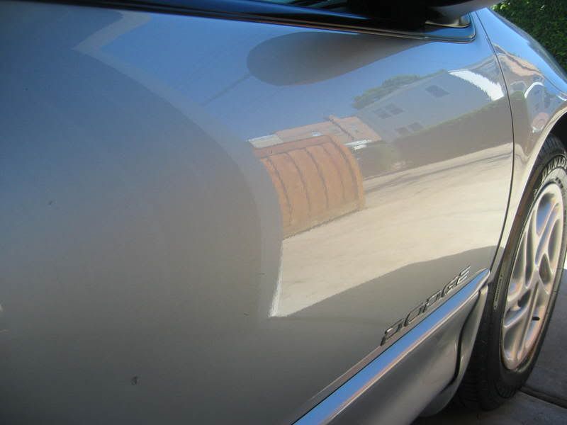

My wife owns the car and yesterday was the first deatil the cars has seen..this car has been a test bed to teach the girls how to drive so it has seen its share of dings..
The game plan was to polish it up to bring some life back into it..all in all it took some time ..
[COLOR="Red"
Process:
[COLOR="Black"]Tires/wheels citrus degreaser
same process for the lower panels and wheel wheels
wheel wells dressed with Megs hyperdressing
Tires: AA tire gel
washed with NXT

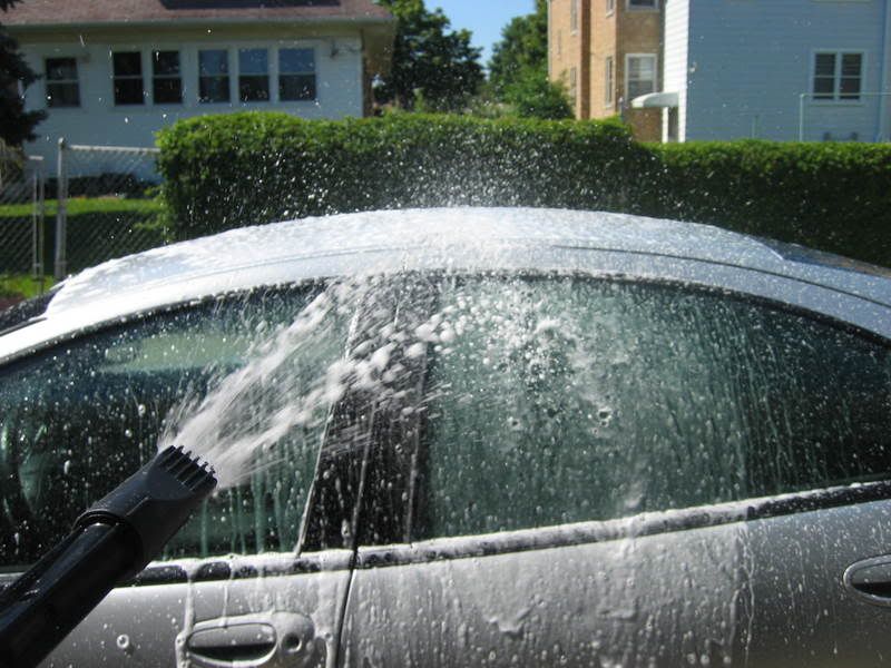

I had a little DP foam soap leaf over so i used it to to neaturilize the degreaser on the wheels and lower panels
Clayed with Megs aggressive clay

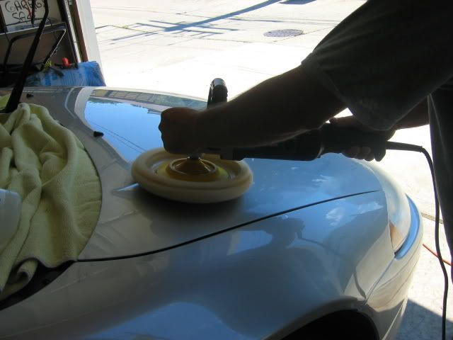

Polished: Menz PG/Opt polish using a wool pad at 1800 RPMs(makita] then dropping the RPMs down to refine the finish
[/COLOR]]LC CCS 5 "Pads on a rotory for the lower panels using OP/HTEC

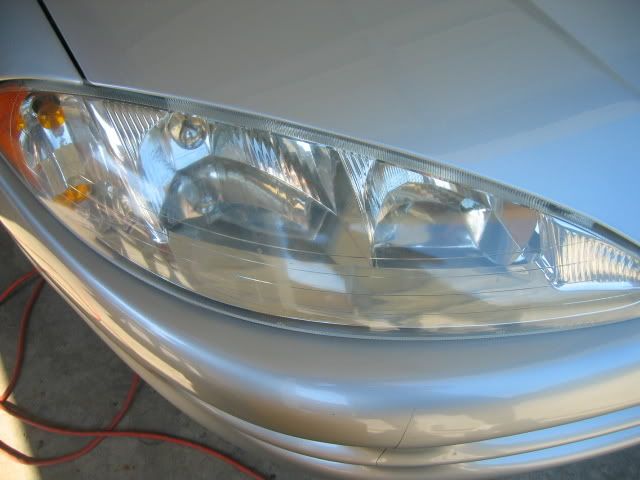

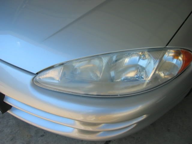

Headlights: OP with a LC CCS 5" green pad follwed up with a LC white polishing pad
Rewash using ONR
XMT Glaze w/pc on a 5" blue pad
LSP Megs 16# spit shine with AW.
Left lense 50/50 shot..i polished them the best i could with what i had available.
Right lense complete..both lense were yellowed so the afters are an improvement
