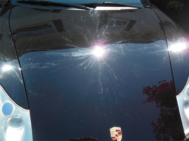

Long title, not sure how I wrote that? Big picture is this, MOST of the swirls, scratches and dulling to the finish on a car comes from how you wash it so I'll cover how to do it the right way and how to do the safe way. For anyone attending Detail Fest this class is scheduled for 9:15am on Saturday in Classroom #100
