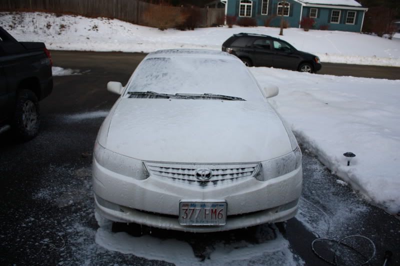

I started by rinsing it down with the pressure washer to get as much road grime and salt off as I could. Since it was so warm out and the car was really dirty I decided to give it a foam bath with DP Xtreme Foam and Dawn. I used the two bucket method with Pinnacle XMT Shampoo and Conditioner for soap and a sheep skin mitt.

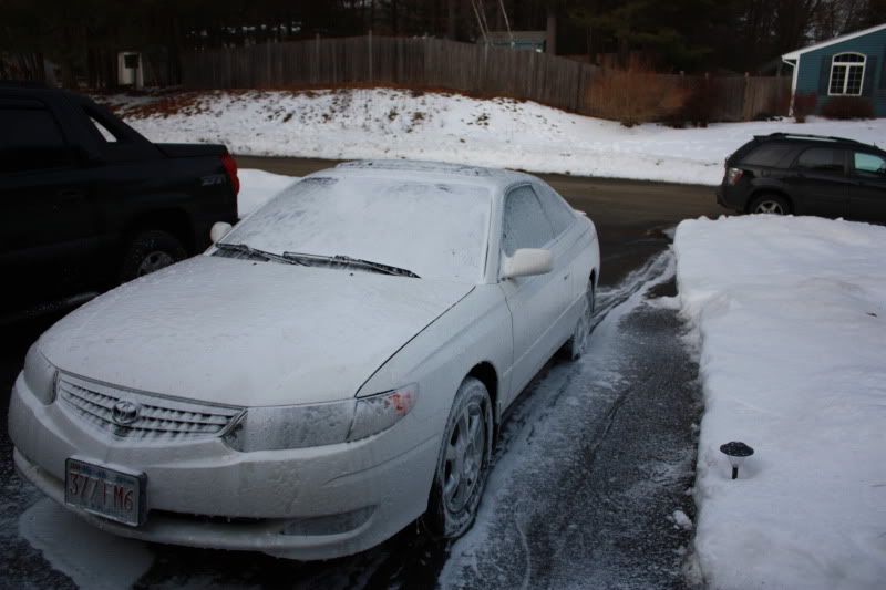

Couple of shots before a rinse...
Foamed...

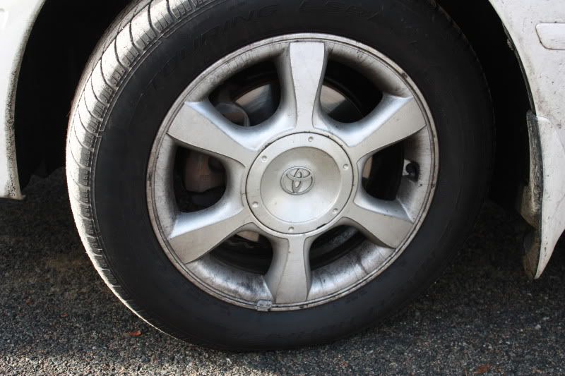

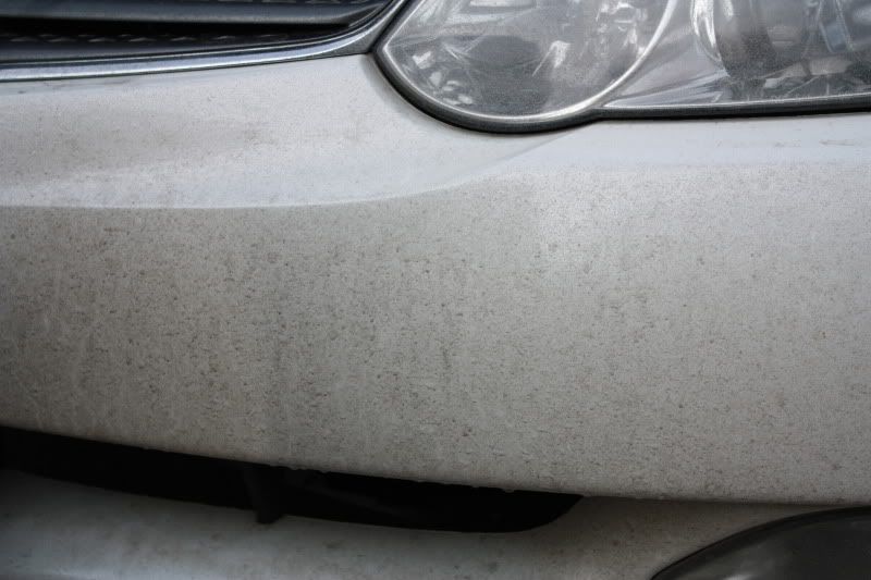

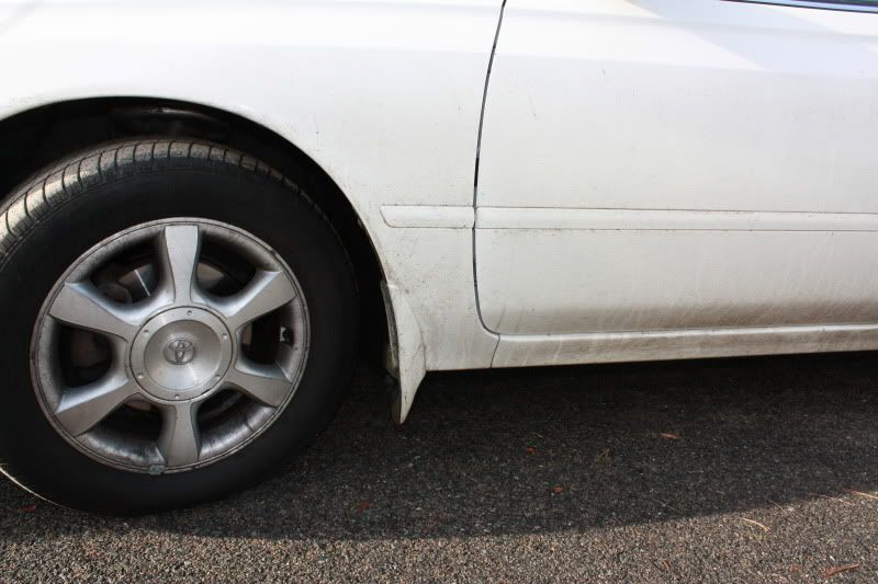

After the wash it was dried with a small electric leaf blower. And I could see the real damage. The car has been clayed twice this year and was just recently done back in Oct, so it wasn't bad. A couple areas on the side skirts needed some claying.

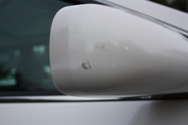

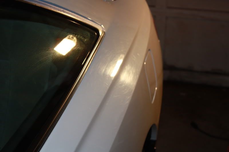

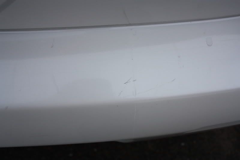

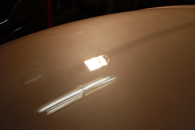

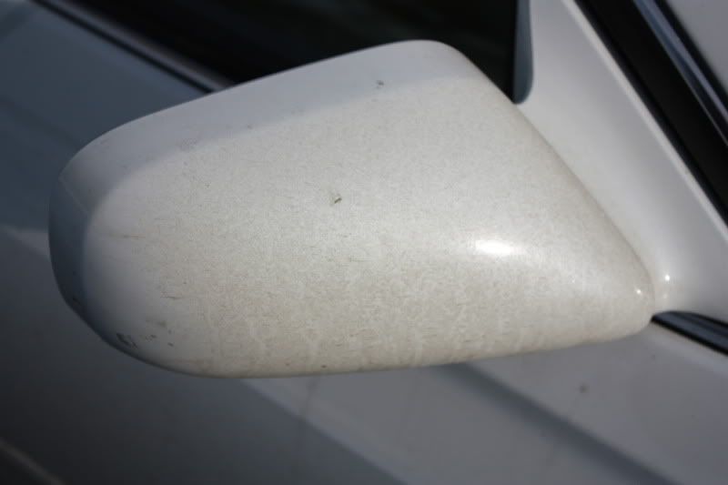

Some shots of work I had ahead of me.

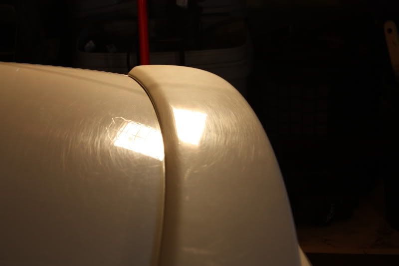

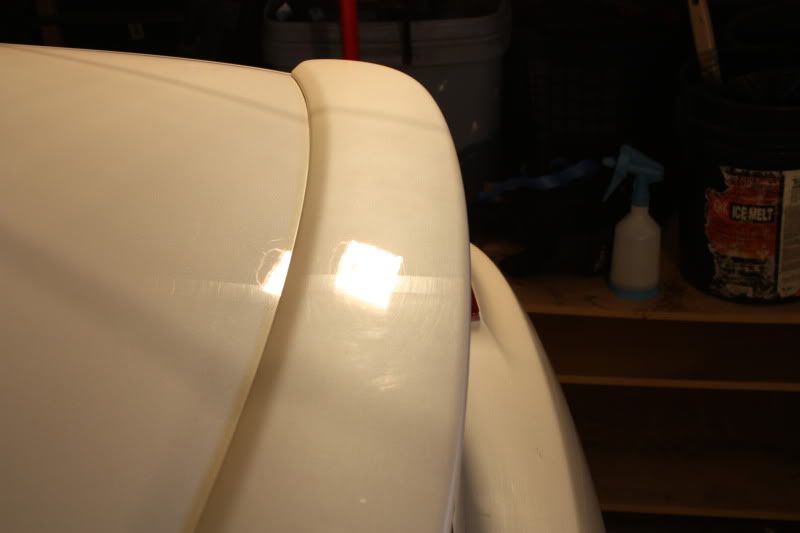

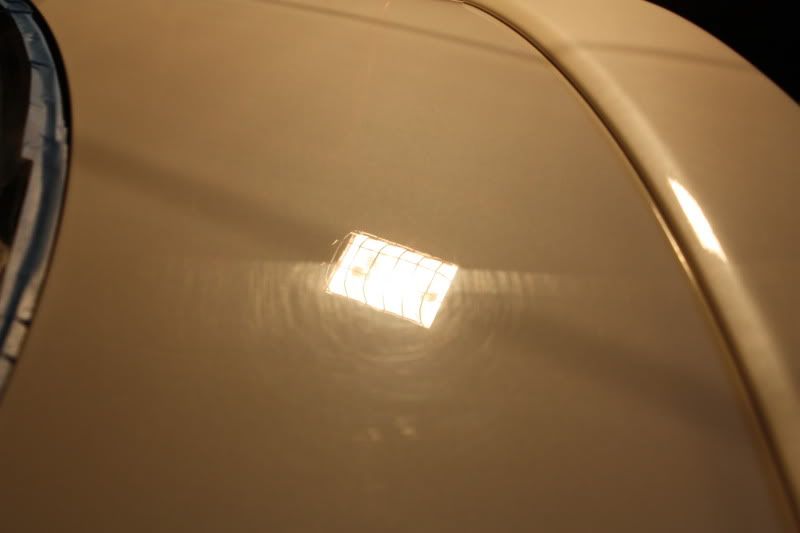

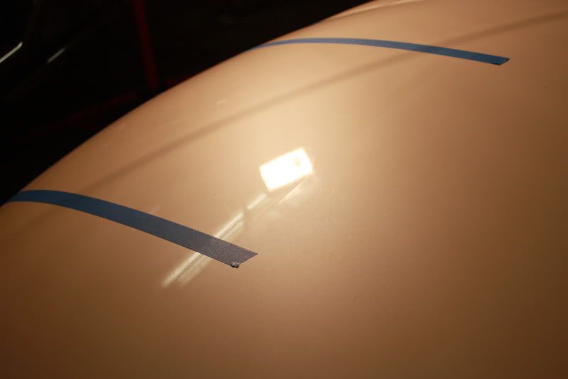

I taped up the car and got to work on my test spot. The paint was a lot harder than I was expecting. I ended up settling on M105 on yellow CCS flat pad, followed by M205 on a white CCS flat pad. After I completed the hood I had ran out of M105 and ended up running to Pep Boys and had to get Megs UC. All with the PC7424.
On to the 50/50's...
After the polishing was completed I gave it an IPA wipe down and proceeded with a coat of Pinnacle XMT 180 High Gloss wax. After it sat over night I applied a coat of Dodo Juice Supernatural. All via the PC and CCS flat red pad.

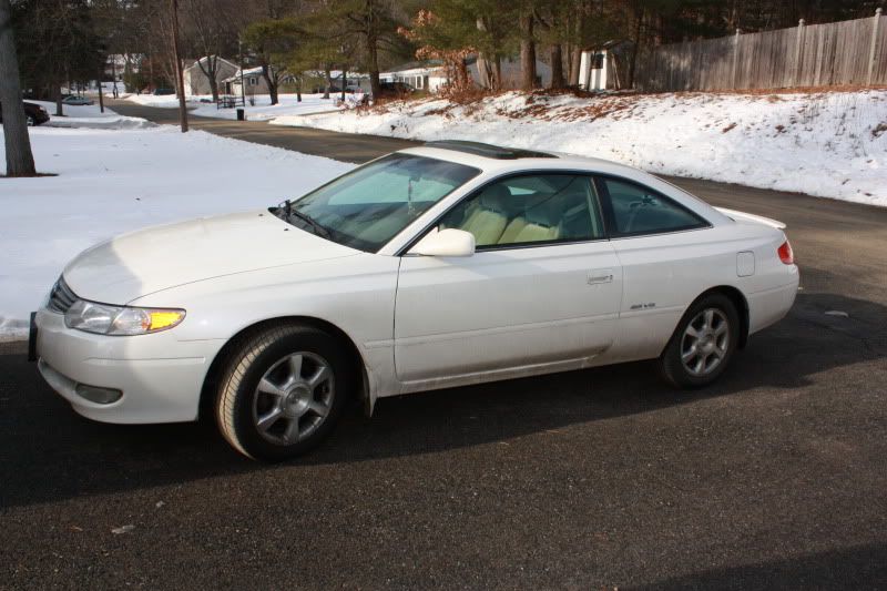

And here are the afters
