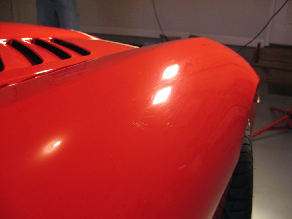

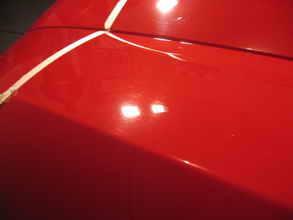

We started off by claying the paint with Meguiar's clay bar and Meguiar's Quik Detail spray. This proved the condition of the paint as the clay bar picked up little to no contaminants. Here are a couple of pictures, showing the swirl marks that needed removed:

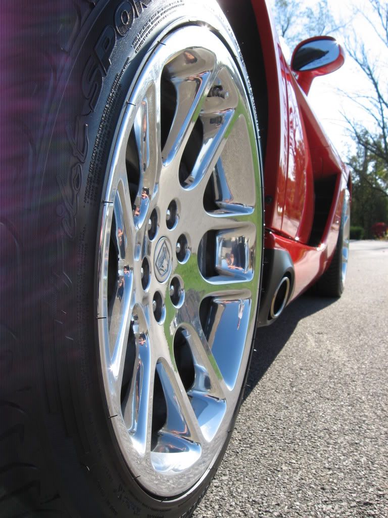

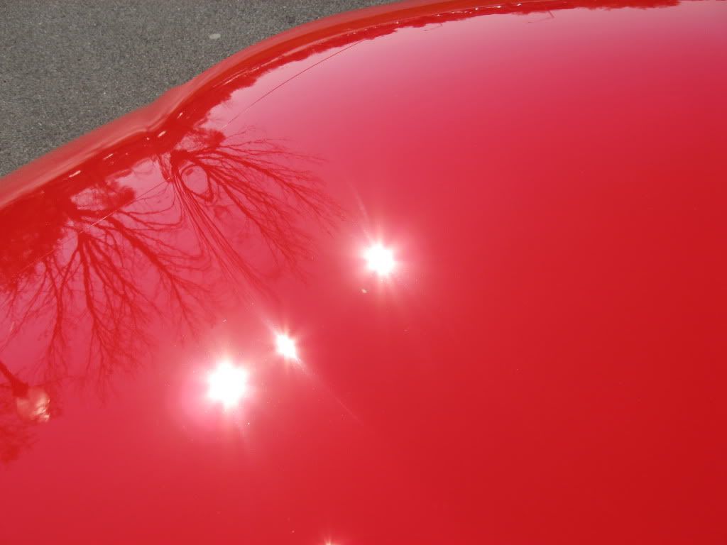

We're both just beginners, but after we came up with a system that worked, we moved along nicely. Tom had his Milwaukee rotary, utilizing an orange LC CCS pad and M105, and I followed using my PC7424XP with a white LC flat pad and M205. Once complete, we sealed it up using a Meguiar's sealant from their professional line. I just can't remember which it was. The results were stunning:
