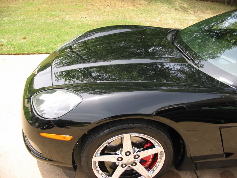

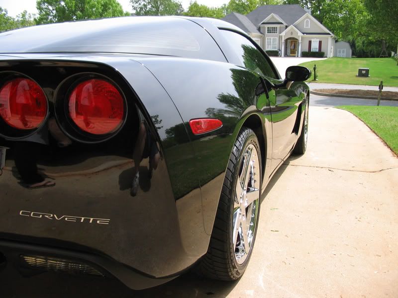

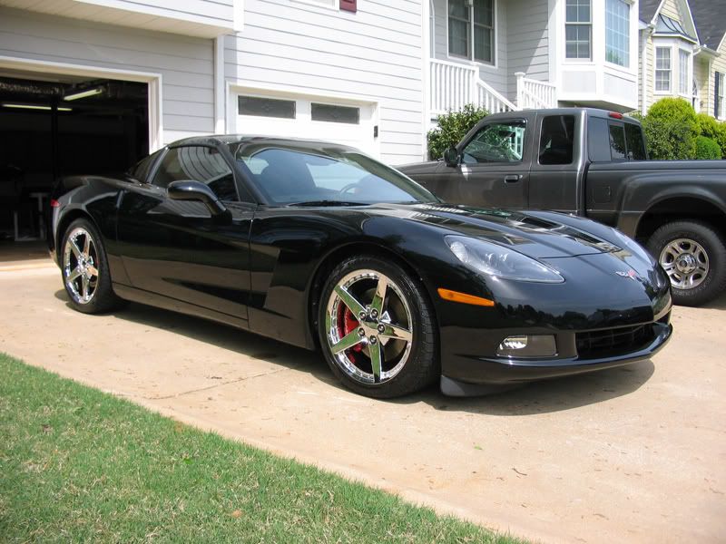

I have done this one twice before, and all he use's is Pinnacle Souveran
When I got there it was covered in dust/pollen/bugs. Not washed in about a month. He gave me the key fob, and I drove it out of the garage. I had a problem once before with this vette. And I didn't want it repeated. Long store.
Interior
Vaccumm carpets, dash/door panels/console received Dp Interior Surface Protectant, seats received brand x
The Wash
Optimum car wash, wheel brush and the 16'
Deep Reach Wire Wheel Brushes
Dawn soap on corvette(I used this because of before) I don't do this often.
Dried with the guzzler.
The Gameplan

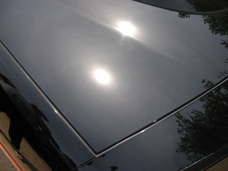

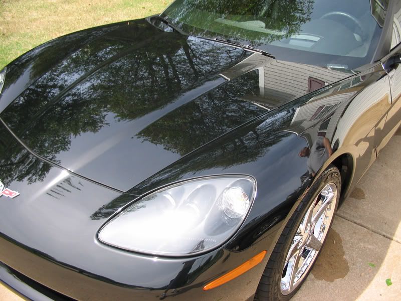

I went with a EDGE green pad and Optimum polish. Between 3-4 pea size dots per panel. Spread at 3-4 them bumped it up to speed 6.
The Final
I used a 6in blue WG pad with Pinnacle XMT Carnauba Finishing Glaze. Left it on for about 15min, then removed.
Out came the Pinnacle Souveran Paste.
Tires received Pinnacle black onyx tire gel
Total Time 4 hours( 1/2 hour talking with client)
