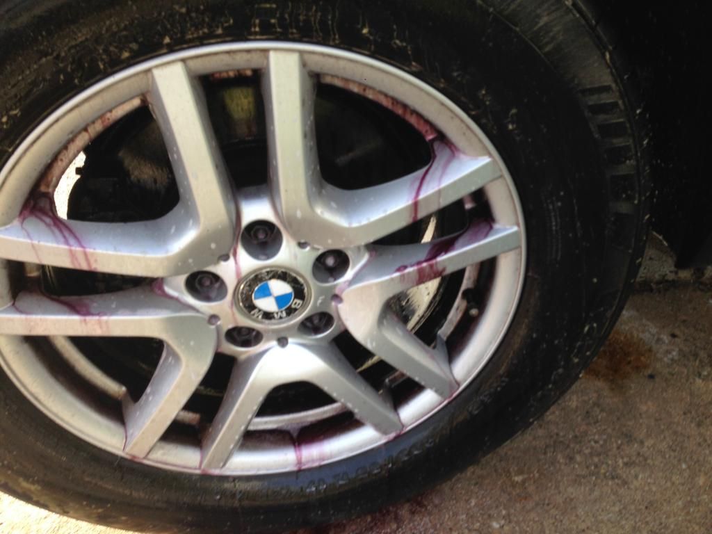

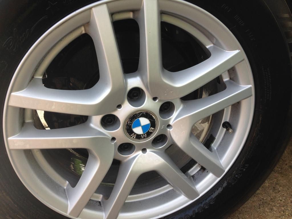

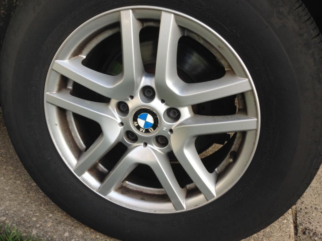

Wheels were cleaned with 1Z Colourtec followed by Meguiar's Wheel Brightener, followed by Stoners Tarminator.
These wheels were extremely dirty and unfortunately did not come out 100% perfect.
