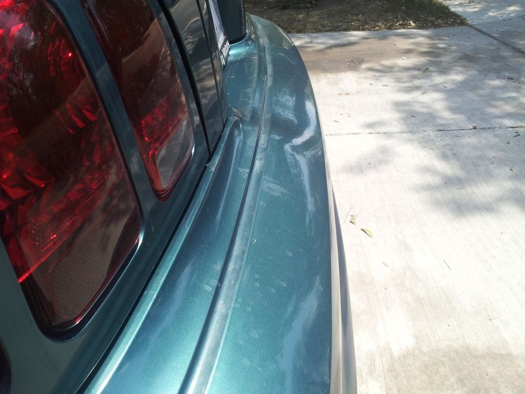

Met up with Dave today and did a great job on my car, really. When I pulled up the car was filthy with oxidation all over it and I honestly wasn't sure there was much hope, but Dave worked his magic on my car and brought it back to life! Thank you Dave for allowing me to use your products and tools and helping me out. I honestly would never had got this done without you!
Here are some pictures:
Before:
Test Square:
Oxidation on top of pic clear on bottom:
After:
Thank you, the bumpers will still need to be repainted in the future but as for now they shine again and are glossy
Glad I could help. Get the bumper covers and hood painted and with not much work she'll look like new. The rest of the paint is really in pretty good shape. Glad you are happy with the outcome. :)

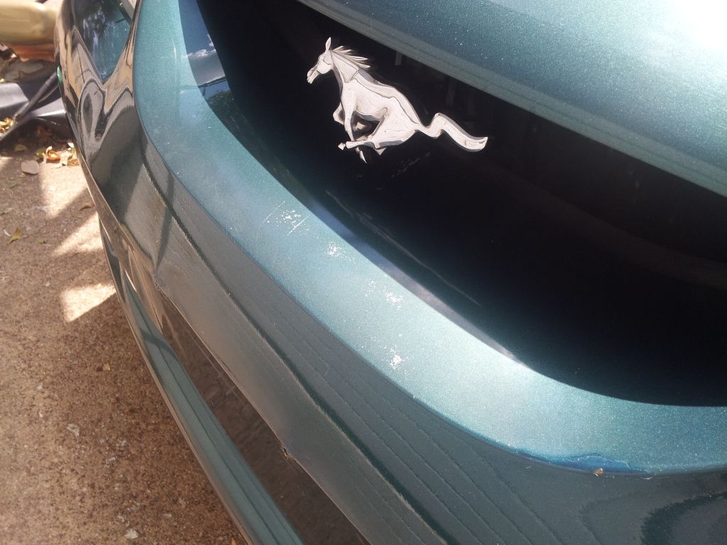

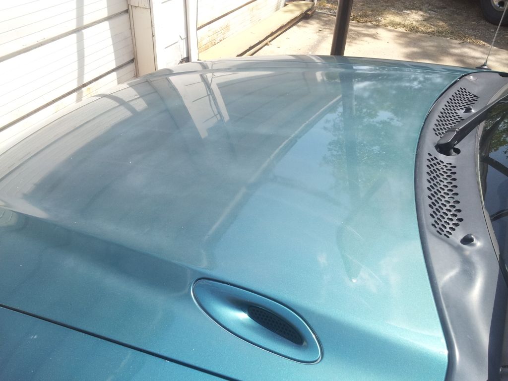

As you can see on the bumper covers there is some CC failure there and on the hood. The hood also had some oxidation. Because of the CC condition I didn't want to get too aggressive. We washed and clayed it. Then did a test spot on the hood with hyper polish and yellow pads. It cleaned up pretty good. I did use some 105 on the hood to get rid of the heavy oxidation. Then we went over the car with PB black hole then put a coat of meg ULW on. John was one of the quickest learners I've worked with. I'm sure he'll be doing paint correction and detailing soon.
