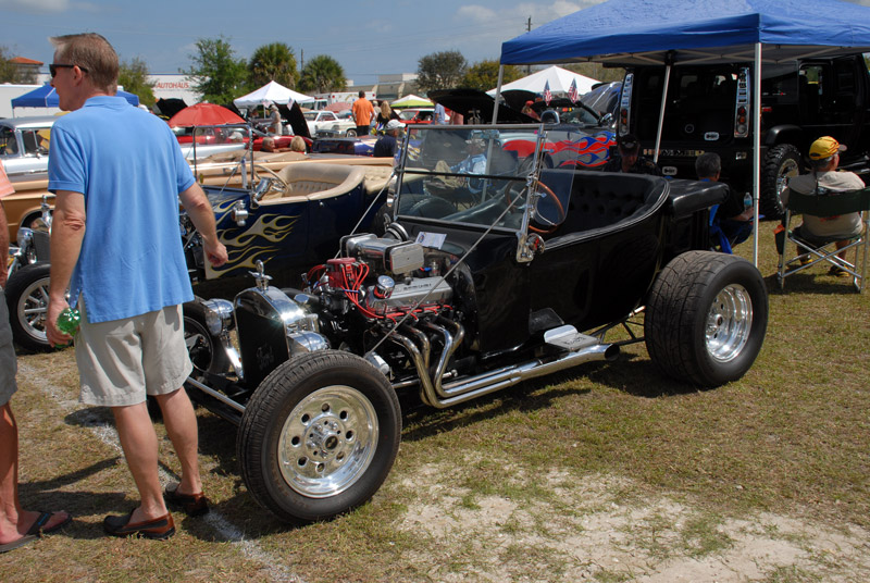

When I started off learning, it was on this car that I purchased to be a project car… after watching a few Mike Phillips videos, and buying some stuff, like you did…my friend who is a service manager at a Ford dealership at the time, said what’s the worst you can do screw it up? It’s just paint… And paint is paint. He said if you screw it up bring it in and we’ll fix it..
Well as you can see, I didn’t screw it up :-)
