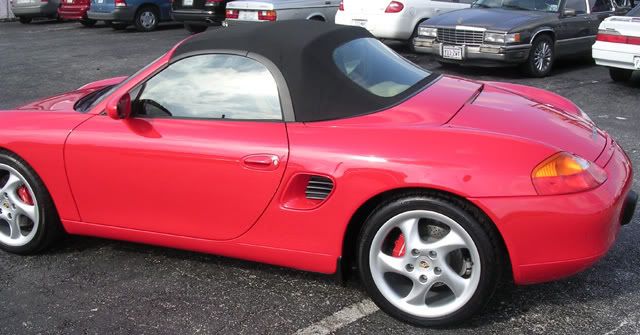

Husband wanted to get his wifes red Boxster detailed so he left it with me for a few days after it was serviced by the dealer.
Paint didn"t look that bad until after I washed all the dirt off. It had alot of marring as seen by these two pictures.
Black lambswool with Hyper at 1500 was my first step.
Green pad with HYper at 1400 came next.
White LC pad with OCP at 1400
Cyclo with PoliSeal and white pads. Some areas were done with blue finishing pad at 1000 rpm's.
I was a bit bummed today as it rained all day but I was able to get it outside for a few minutes and snapped off a few AFTER shots during a break in the rain. I was really hoping to get better sun shots but the clouds were not having any part of that.
The paint had alot of paint chips but it came out looking pretty nice.
