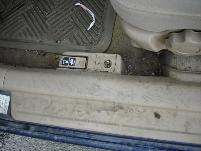

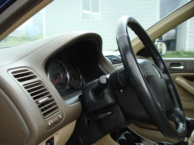

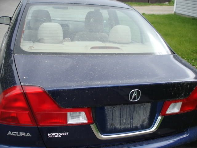

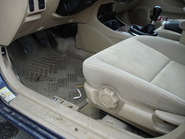

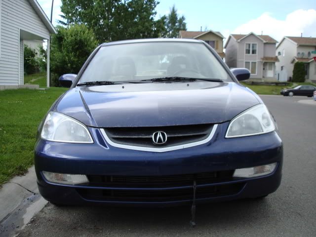

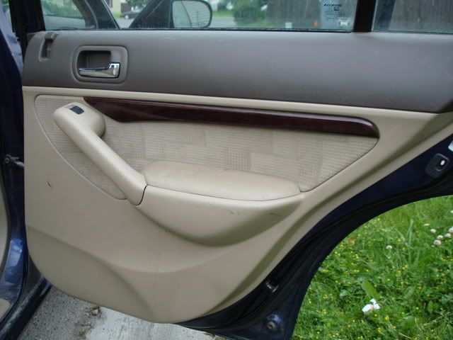

Now for pictures:
Before:
If you look closely you will see bird poop near the pilar...booooo!
