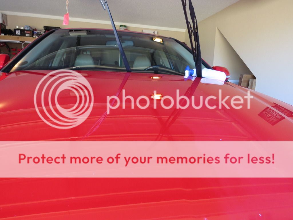

Hey guys, back in the detailing world and will start showing some work over the next few days. Up first is a 2004 Acura TSX. The car was in pretty rough shape when I received it. The paint was in rough condition, was a weekender car wash victim.
Opened up my full cleaning arsenal.
Started off first with the foam wash with DP extreme foaming soap. Roll off on the tires, Menzerna wheel gel on the rims. Clayed with riccardo reds clay. Then out with the polisher and a LC orange with Menzerna PG 1000. After several passes started to look better. You can see a 50/50 photo below. On to the Menzerna PF2500 with the LC green pad. Paint was really starting to look nice. Finally onto the Menzerna SF4500 with the LC Blue pad. After a final wash and inspection, decided to top it with the P21s 100%. Hyper dressing on the tires. Flitz on the exhaust. Then onto the interior which wasnt in too bad of shape other than the leather. 1Z cockpit, BF interior, 303 on the carpets. Leatherique on the leather, let sit for 2 days before removal. Final inspection and wipe off with FK 425.
