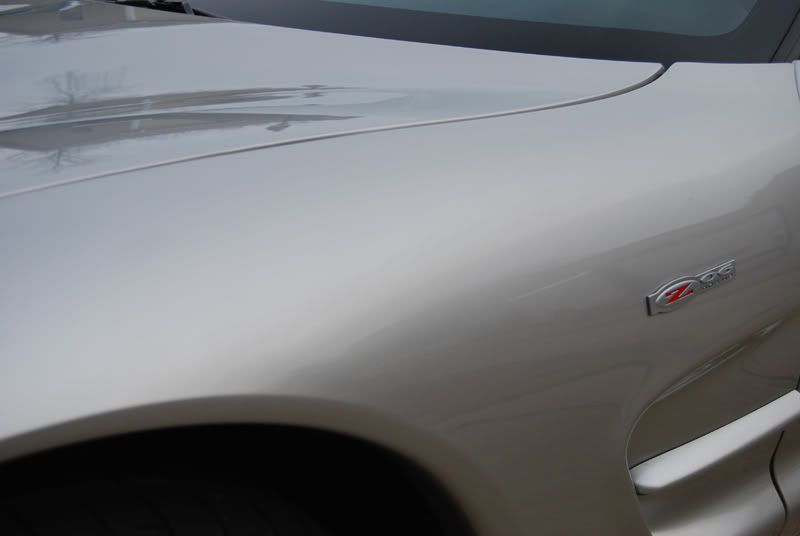

Optimum polish, a new low profile org pad. The PC set at speed 6. Taped off trim, took all of a few min. for that. Had to sand a few spots, with 1500 grit sand paper. And for the final, went with Wolfgang Deep Gloss Paint Sealant. Surf City Beyond Black on tires.

One of the sanded spots
After

Nice job on the scratch Ed. I love detailing on an overcast day as long as it not to cold.
u got those sanding markings out with a PC? NICE!
Yes the pc did it, it took a few passes to do it. I didn't feel like using the DeWalt
