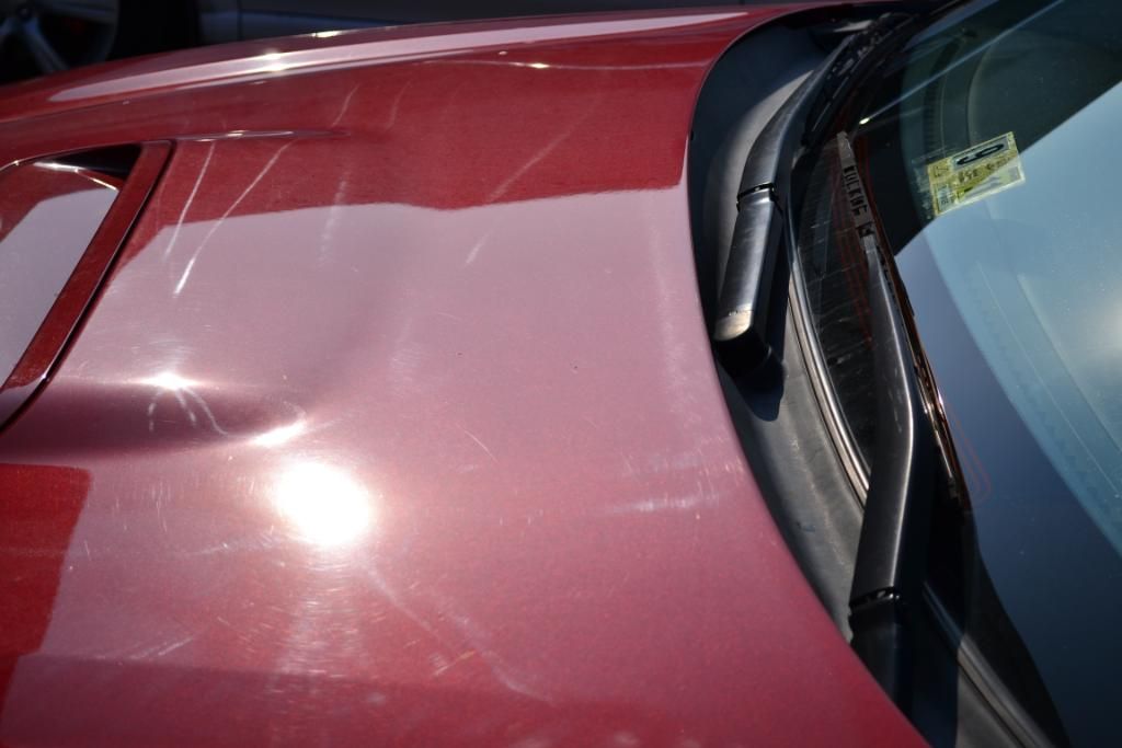

Tons of holograms throughout the car! I am assuming they were inflicted by the dealership...
I started by washing, claying, and stripping all waxes then tried my hand at the test spot.
I used a hydrotech tangerine pad and 205 on my DA then moved over to the Rotary and Menzerna P085RD with a finishing pad to really make the paint shine!
