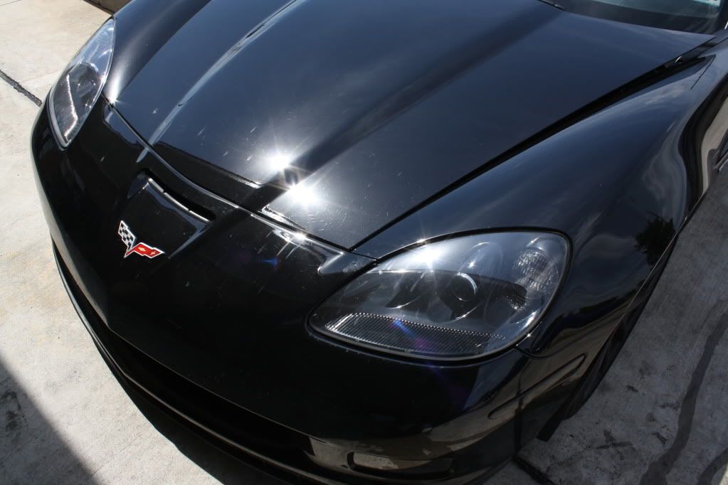

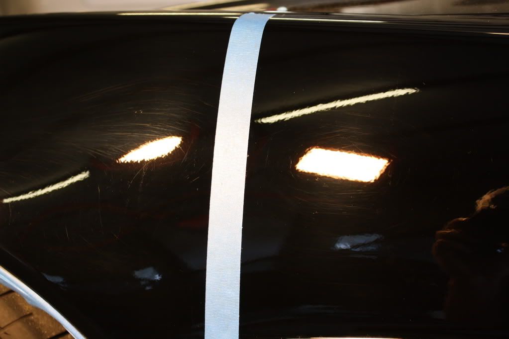

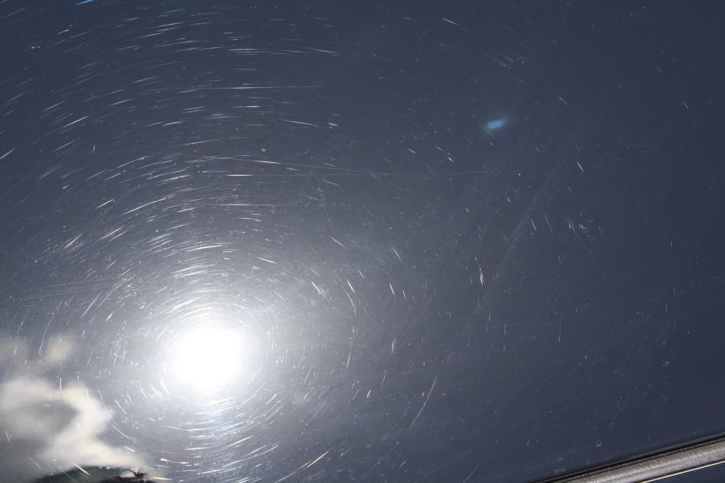

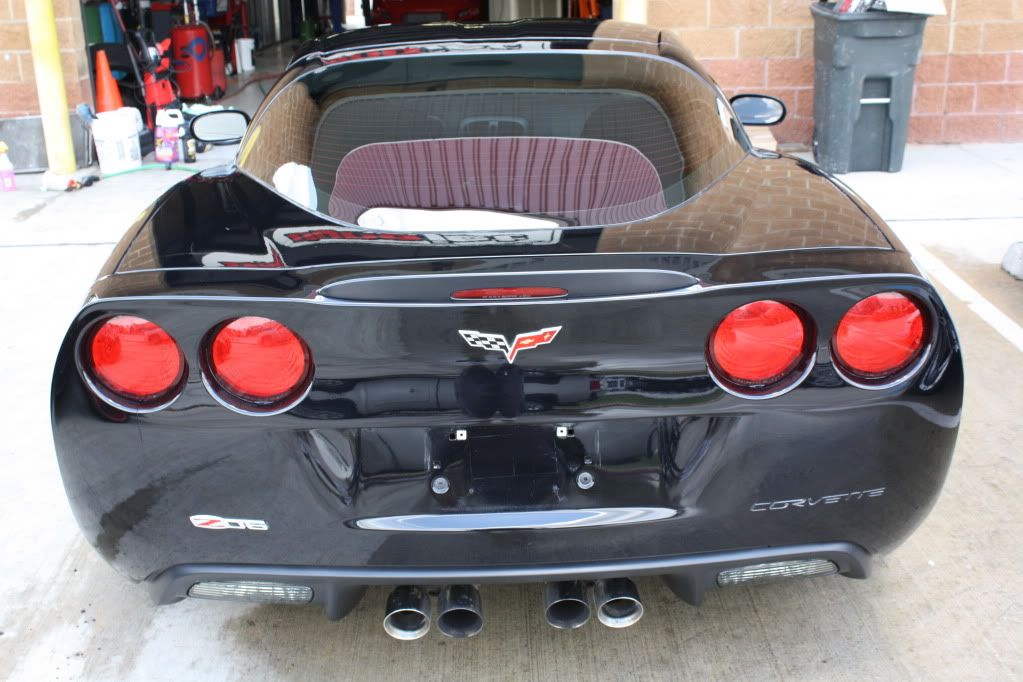

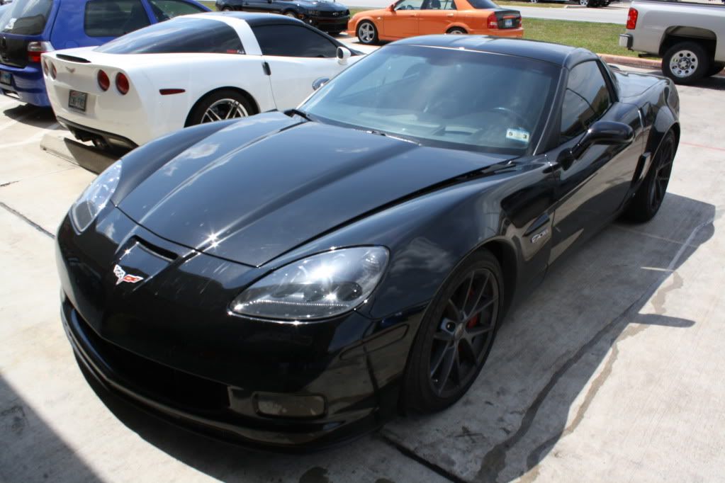

Previous customer of mine decided to get a "fun" car. Dealership really tore it up before delivery. He dropped it off for the works. I didn't have a hard time wondering why.
BEFORE
AFTER A TWO HOUR BATH

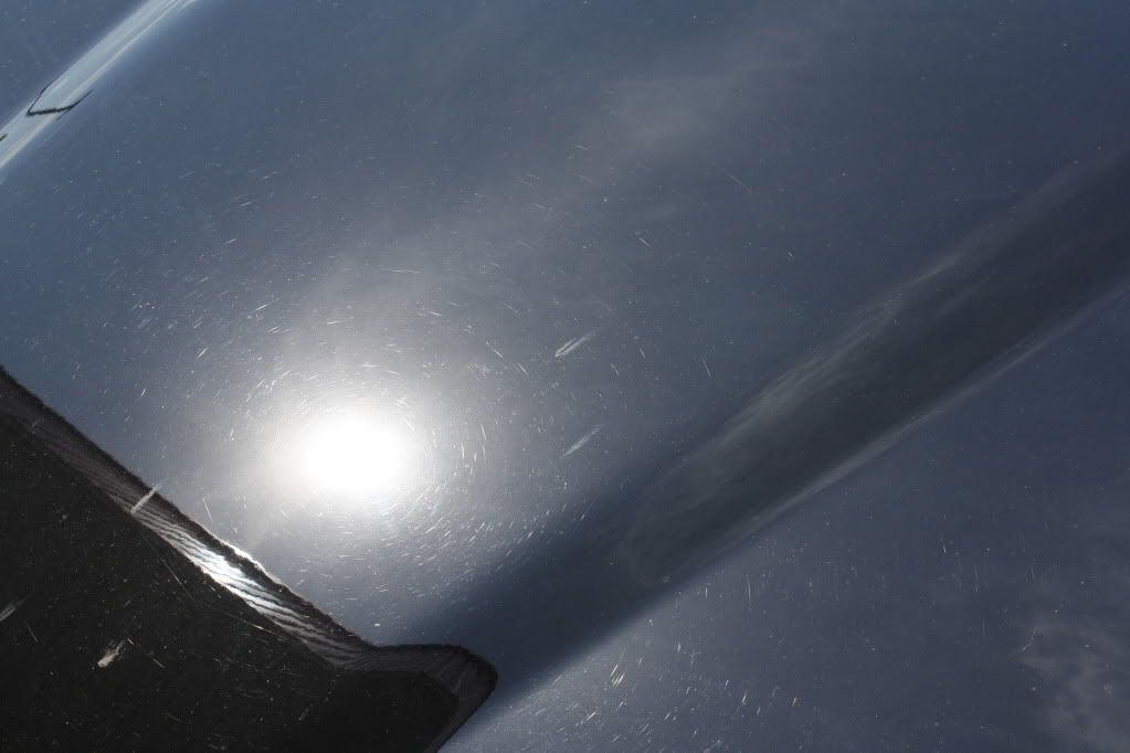

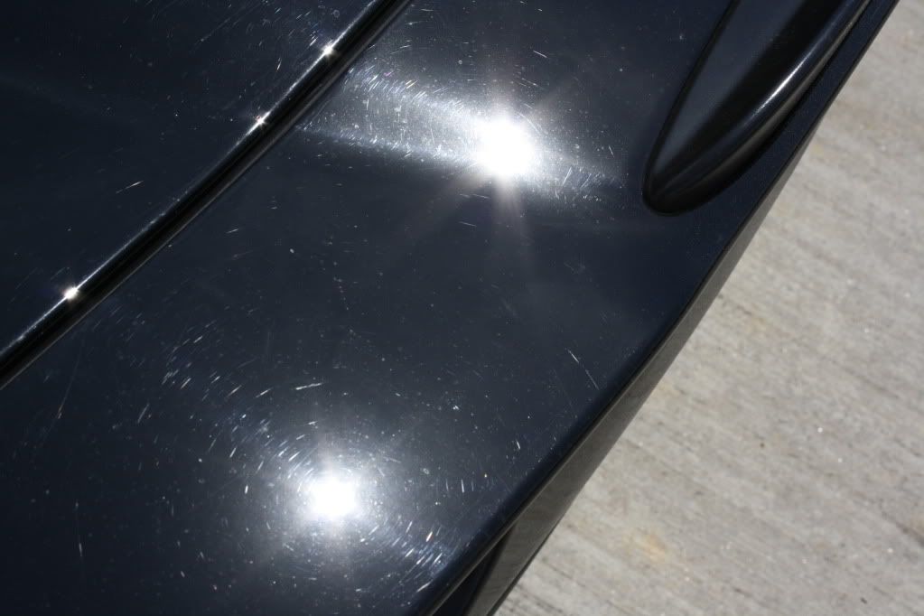

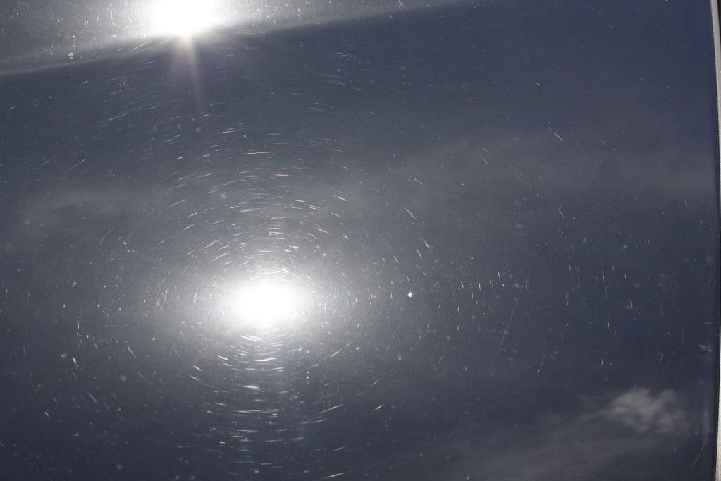

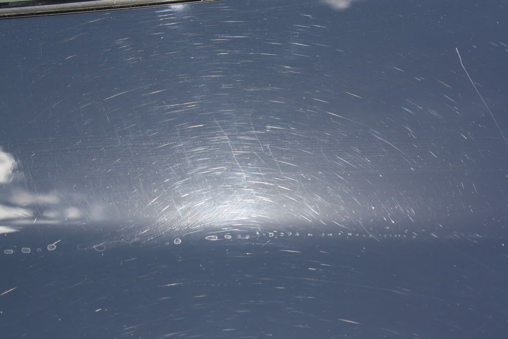

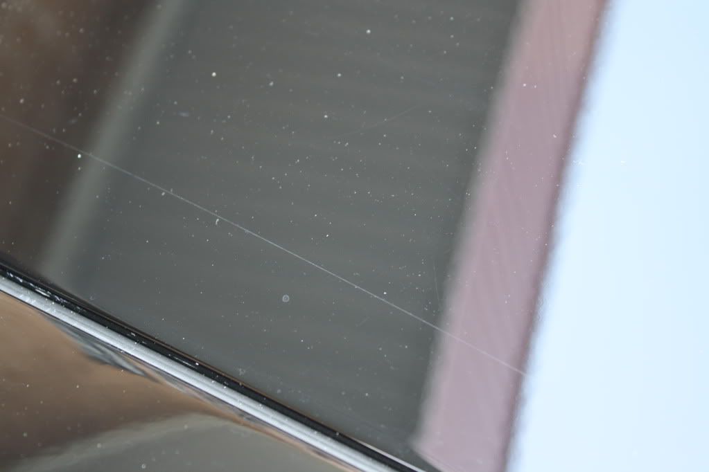

Part of a scratch that ran the length of the hood on the driver's side
Looks like the dealer used a lot of products to conceal swirls

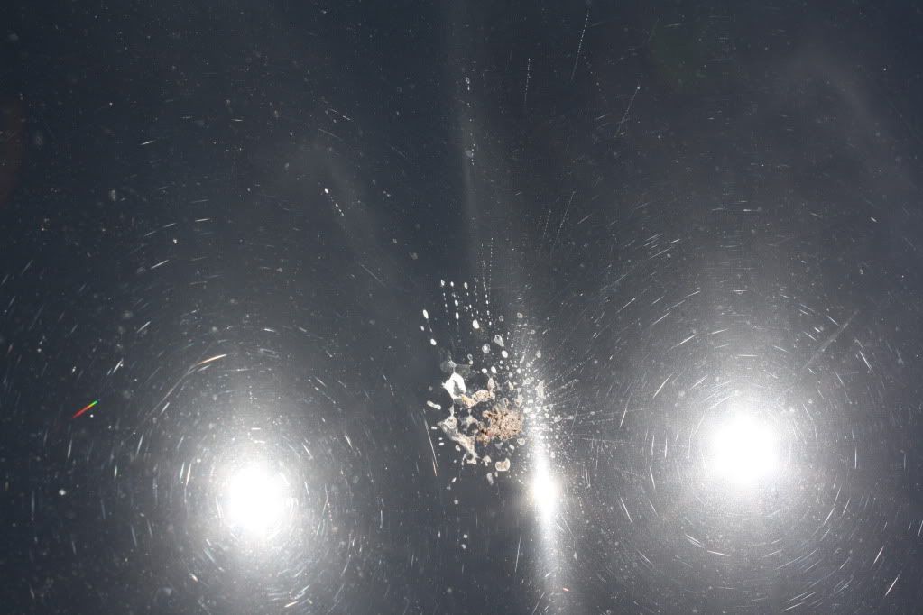

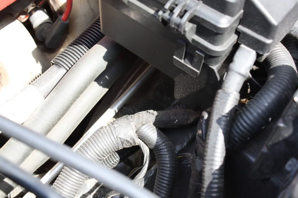

I was finding this crap everywhere...

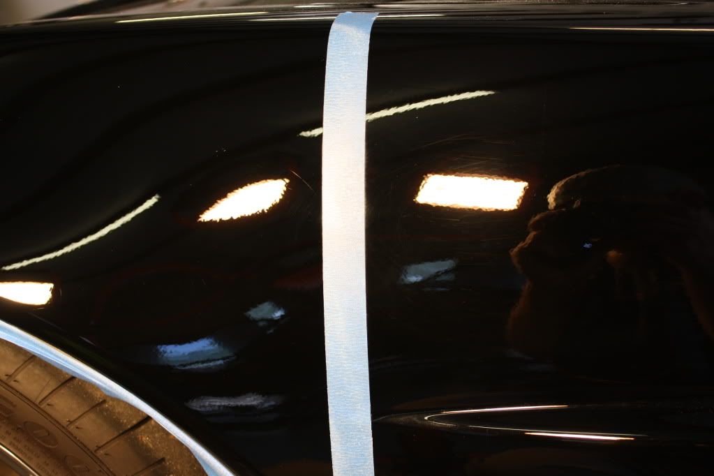

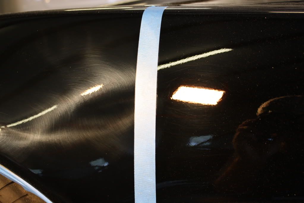

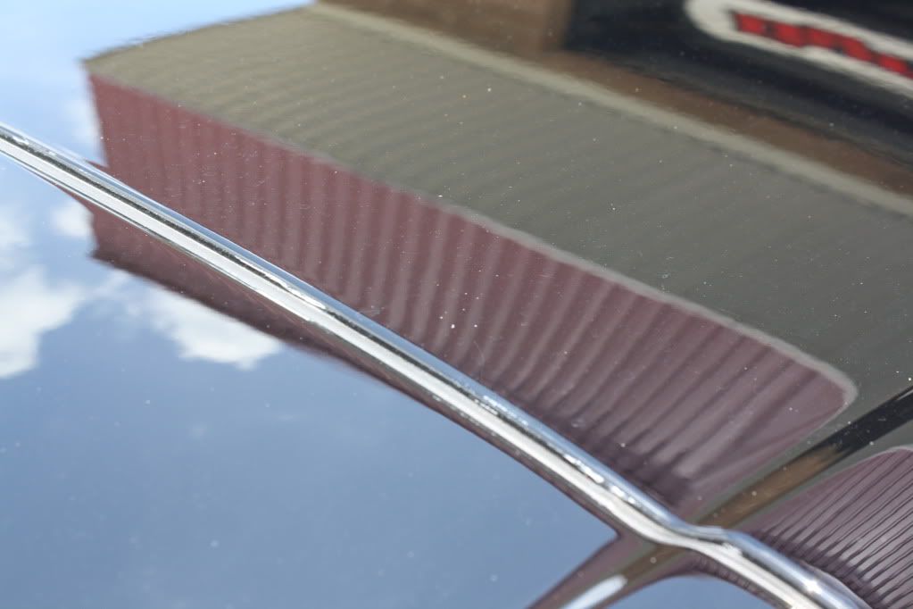

QUICK 1-2-3 PAINT CORRECTION 50/50 SHOTS
STEP 1: COMPOUND
STEP 2: ROTARY POLISH
STEP 3: ORBITAL POLISH

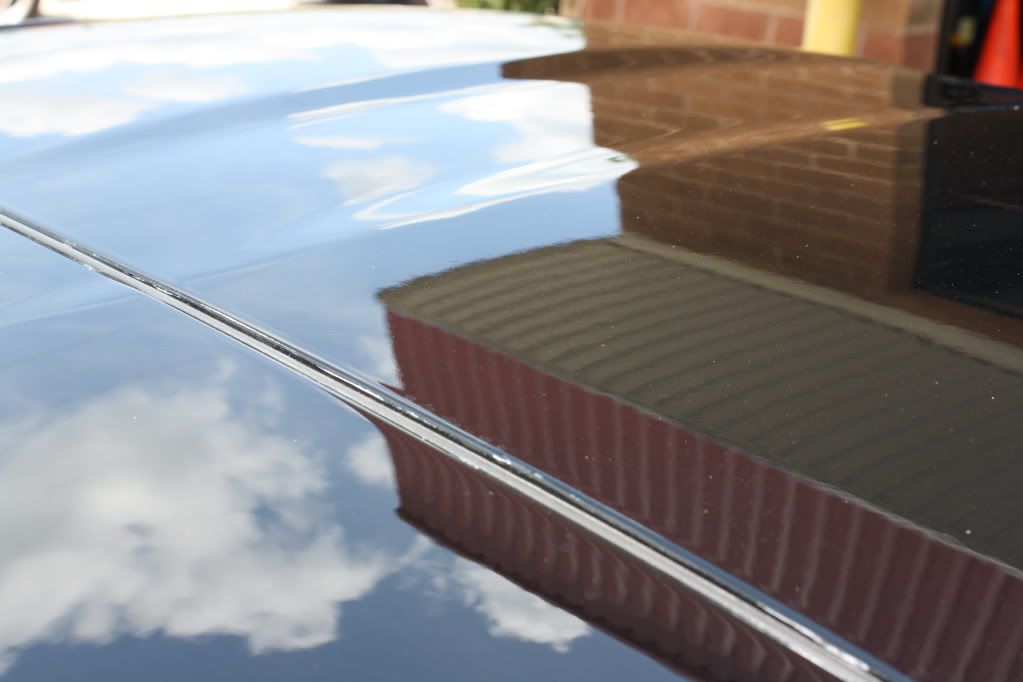

MULTIPLE LIGHT SOURCE 50/50

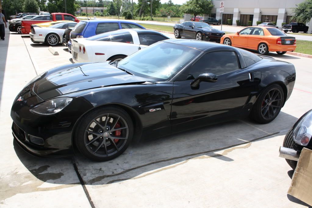

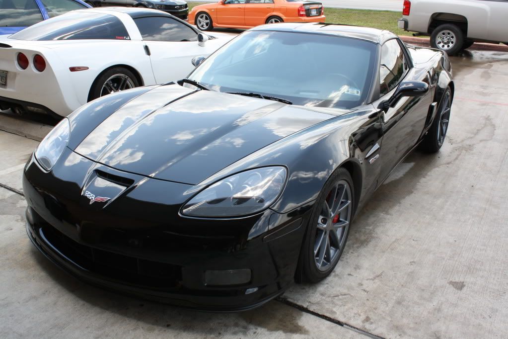

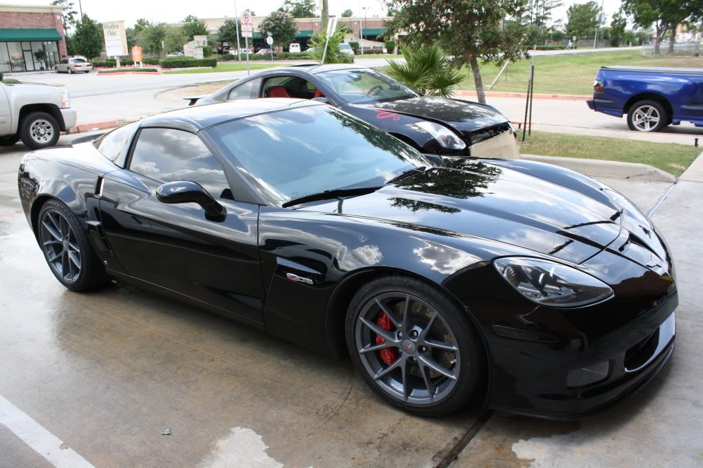

AFTERS:
OUTSIDE
Amazing correction! What products did you end up using on the Z06?
Amazing! Blackcars always have the best turn arounds. One of my good friends just picked up a black 2002 mazda protege5. I cant wait to get my hands on it. Ive never polished a black car. In fact, he doesnt even know that I want to polish it. But I know it will need it. I just told him I want to detail it haha.
That Corvette looks amazing!!! The gloss is so deep and reflections are clear as can be.
Holy Smokes, talk about a transformation! :wow:
The owner must be at a loss for words right now because his new toy looks better than new!! :props:
For paint corrections, I used
Makita 9227c + LC white wool braided and white VC pads
3M rubbing compound
3M machine polish
BTW I'm ditching 3M for 105/205. If you want to know why you can read it here: http://www.autogeekonline.net/forum...rustration-3m-products-input-appreciated.html
Kinda disappointed Mike didn't respond.
Flex 3401 w/ LC black CCS pad
P085RD
Two coats of Blackfire Wet Diamond
One coat of Blackfire Midnight Sun

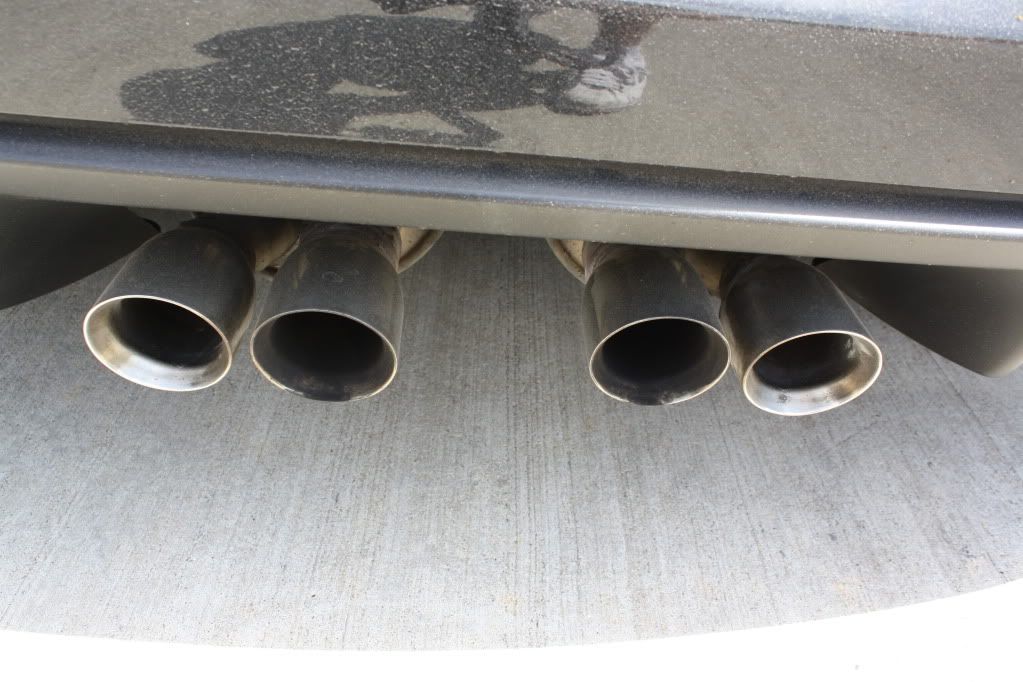

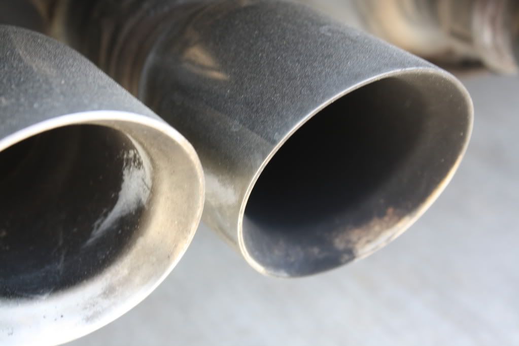

What did you use to polish the exhaust tips?
Mothers Polish and elbow grease. Mostly elbow grease ;)
