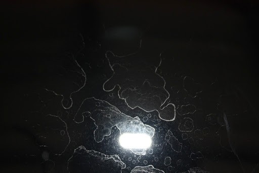

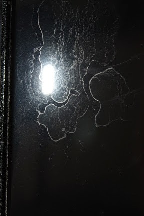

It's amazing the difference a polish can make. I tested a section after it was fully corrected with black hole. That is pretty impressive stuff. Just adds a deeper gloss to the black.
These pics are without black hole. Just polished paint and oils removed using CarPro Eraser.
I really want to thank everyone who has helped out. I'm glad it wasn't my technique but rather soft paint and having to change polishes. I think it's a testament to why it's important to read even if you aren't dealing with exact issues as are posted online. From years of reading, I suspected the soft paint and people here helped confirm that and offer suggestions...very helpful. I had read Mike Phillips say 99% of cars can be finished off beautifully with SF3500 on a black pad. He knows his stuff for sure.
