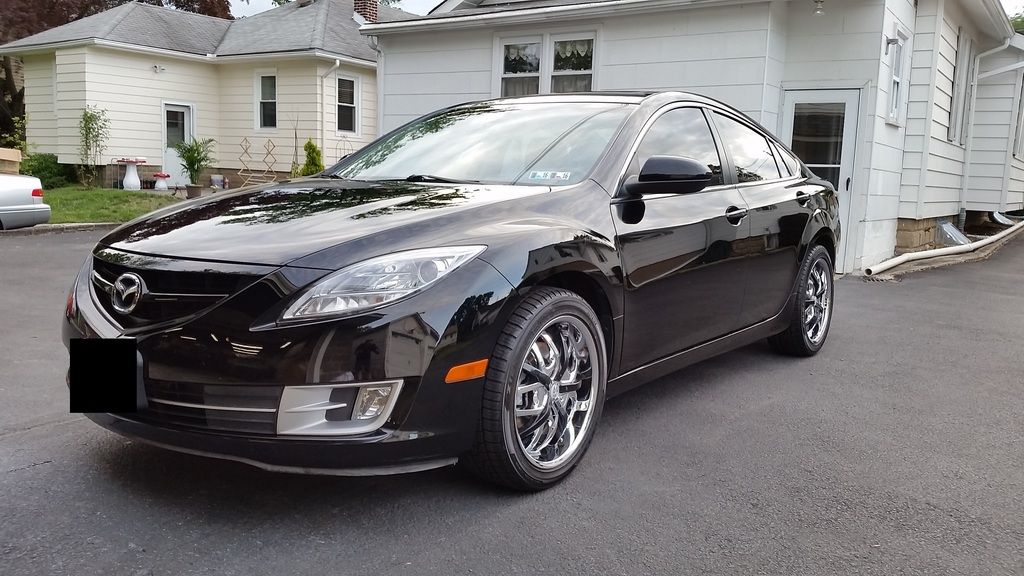

Here are some pics of the car I did this past weekend. So pretty much 3 out of every 4 cars I do are black so I have a solid success rate with the following combo... Menz FG 400 on an orange LC hybrid, Menz SF 4500 on a white LC hybrid and Menz power lock on an LC red pad. I also had to a headlight restore while it was in. For the headlights I started at 800 grit and followed up with 1000 and 2000. Lastly, they were polished with the same menz fg and sf, but was sealed with opti coat 2.0.
The car was in pretty rough shape between swirls, scratches and sap marks. It's a daily driver and isn't garage kept so.... here are the pics. I'm posting a picture that shows one side finished and the other just after using the Menzerna FG. I though it would be to illustrate the need for the mulit-step process. This really shows the haze left behind after using the compound and the need to follow up with a micro polish.
