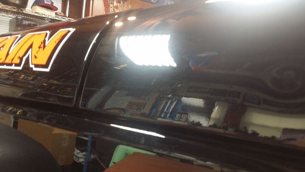

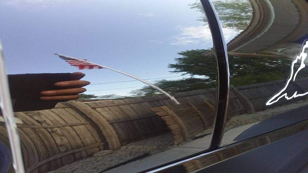

Well I finished up my buddies 2010 Wrangler yesterday and I will say I'm pretty impressed with the results. I didnt think it would come out as good as it did. I had another thread going asking for advice on how to attack this, and thanks everyone who helped out. Friday night I washed it, cleaned his engine which had 56,000 miles and was never cleaned, clayed it, taped everything off, pulled the mirrors off, wiper arms off, spare tire off, and rear plate bracket. Friday night I also did a test spot using FG400 with a LC orange flat pad followed up with SF4000 and a LC white flat pad. That came out well, but when I started on it Saturday, I gave it a shot substituting the orange pad for a Meguiars MF cutting disc and that worked even better so thats how I attacked it. So 1st pass over the Wrangler was FG400 with a Meguairs MF cutting disc, 2nd pass was SF4000 with a LC white flat pad, 3rd pass was with Pinnacle Souveran Paste Wax and a LC blue flat pad.
Before shots
After shots
