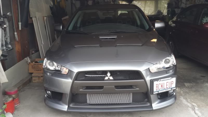

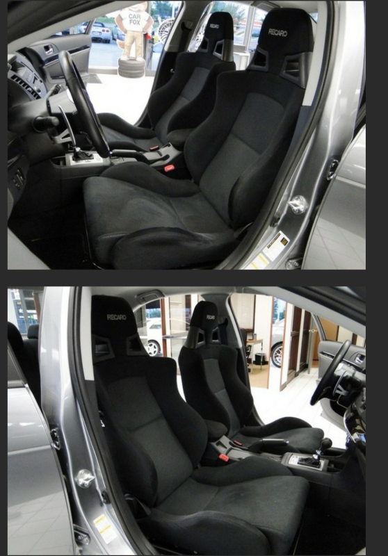

I am going to start this thread out by introducing the detailing I will be doing next weekend and to get some input on ordering a few new things.
I am imagining that the paint is already in excellent condition, so it wont need much compounding and polishing.
Here are my plans:
1. Wash Wheels and Tires Using Chemical Guys Signature Series Wheel Cleaner and various brushes. Car Pro Iron X will be used to remove any Iron and contaminants.
2. I will then follow with a 20 minute Pre-Soak. Soap to be determined. (Current Stock is: Chemical Guys Mr. Pink, Honeydew, GlossWorks, Citrus Wash) *Trying to get the hot water hooked up in my garage by next weekend.
3. This will then be followed by a two bucket wash using. Chemical Guys Honeydew for the soap. (Will finalize after deciding what new stuff I want to order.)
4. I will Foam the car using undetermined soap.
5. Car will then be dried and clayed using Chemical Guys Fine Grade Clay and Clay Lube. (May decide to use my Nano Skin Mitt)
6. Will complete full Vehicle inspection form.
7. Tape and prep for compounding and polishing.
8. Compounding (Either ordering new or using Chemical Guys (V34, V36, V38 or CarPro Reflect Polish with either Lake County Ultrafiber Pads or Hexlogic Pads.)
9. Polishing
10. IPA Wipe down to remove all oils
11. The Interior of the car looks pretty good so I don't imagine that I will need to do much other than maybe applying some sort of protection on the seats.
12. After the vehicle has been fully polished and all oils have been removed we will begin applying the Cquartz UK Edition Coating.
13. Plastic and rubber will be coated using CarPro CQuartz DLux Plastic & Wheel Coating.
14. If needed Glass will be polished using CarPro CeriGlass and then coated with CarPro FlyBy30 Windshield & Glass Coating.
15. Interior Glass will be coated with CarPro Fog Fight.
I may change this in order to meet clients budget but as of right now this is my plan.
Let me know what you guys think as far as products and my process is planned. Also let me know if you think I could leave some things out.
