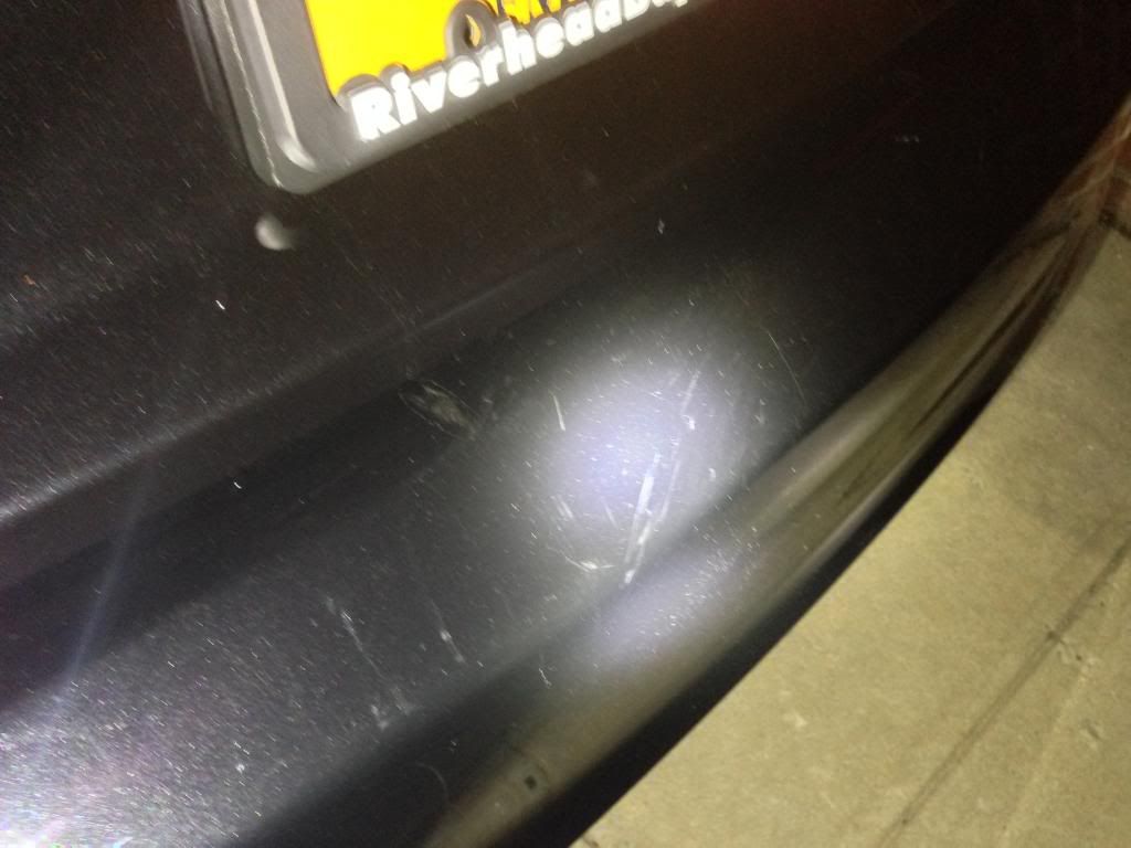

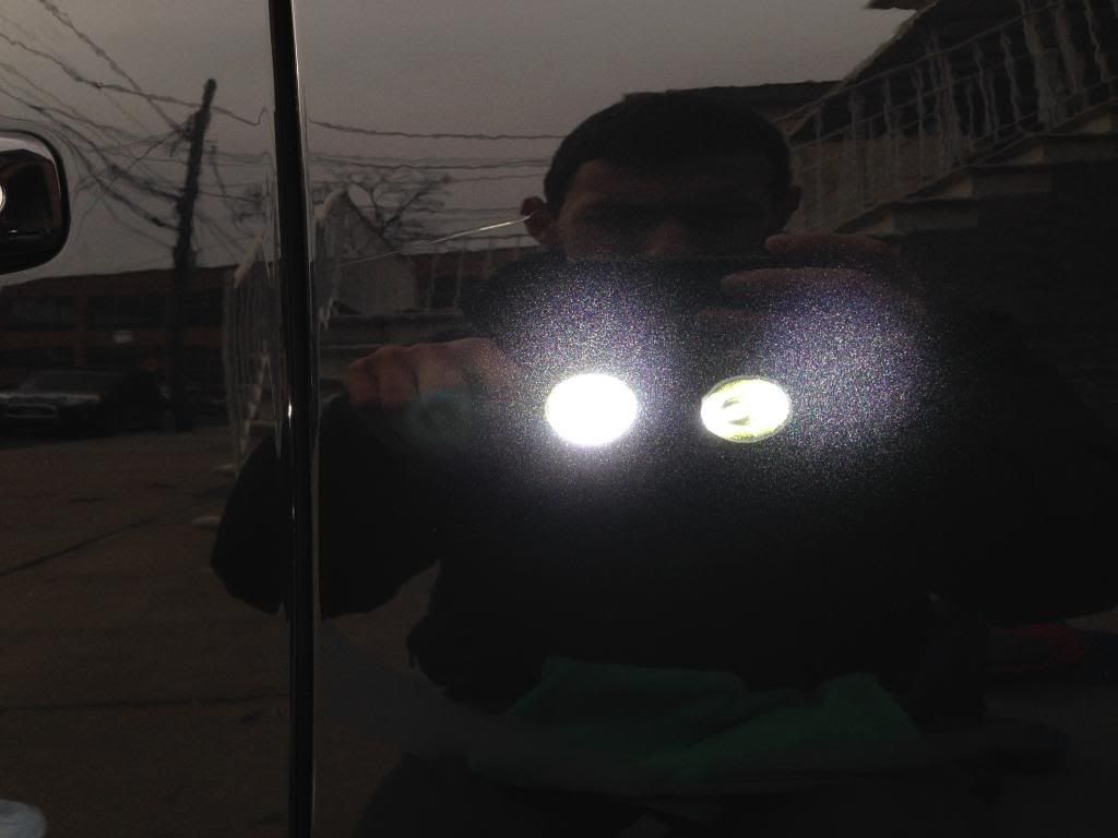

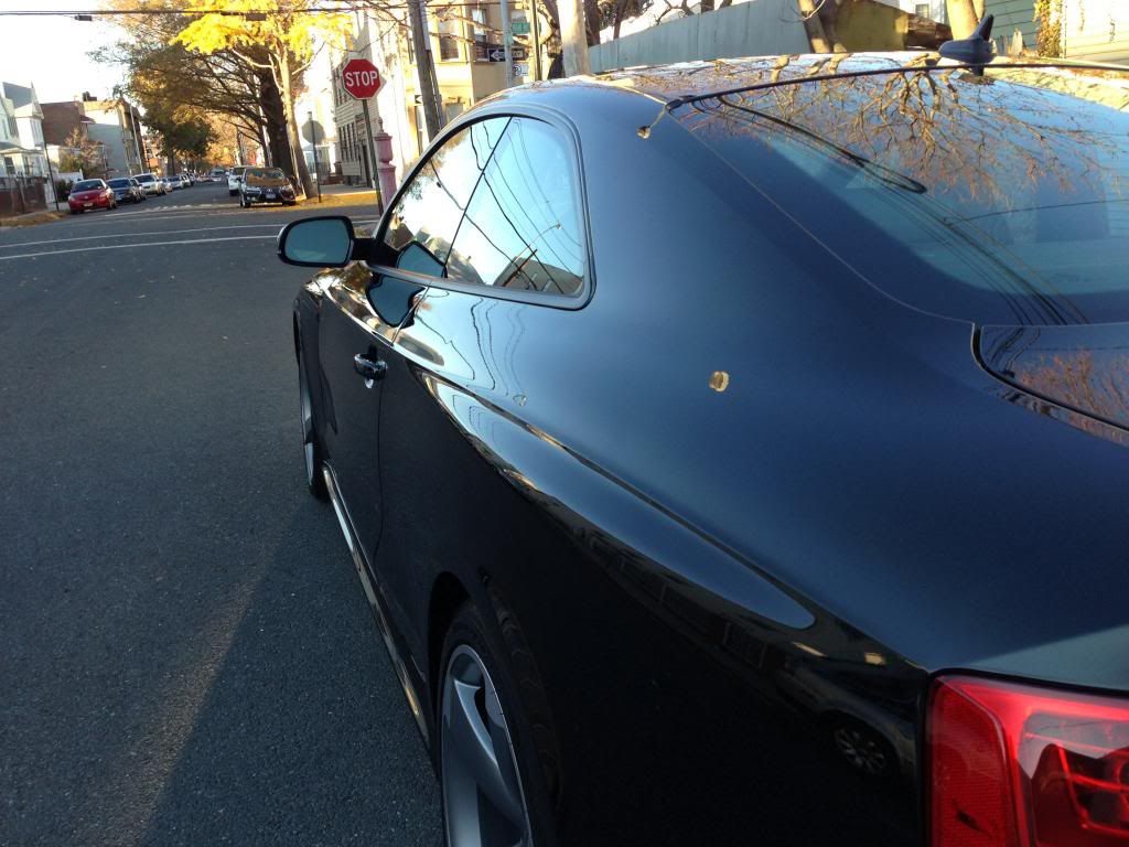

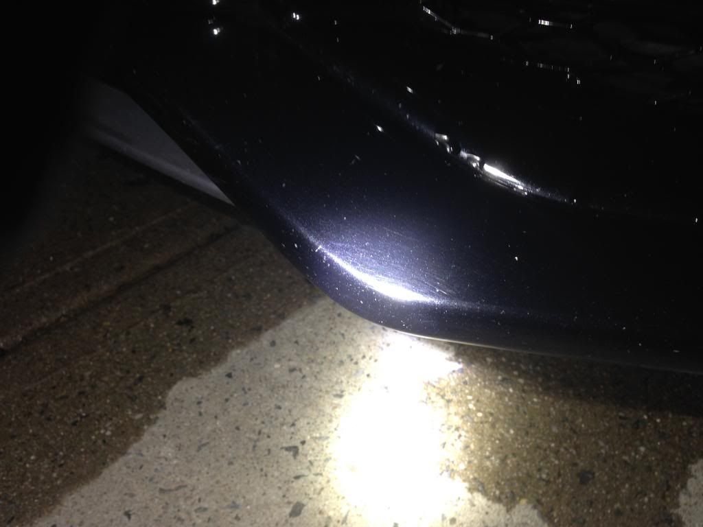

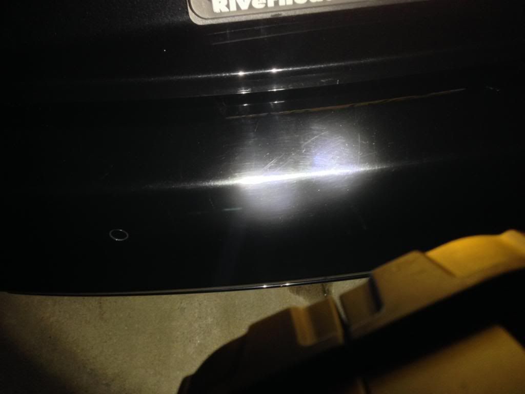

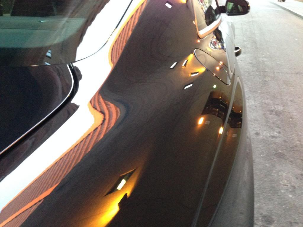

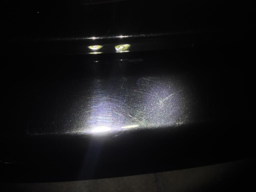

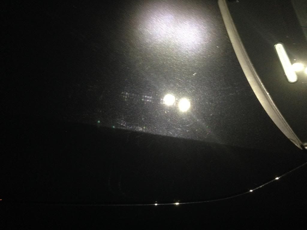

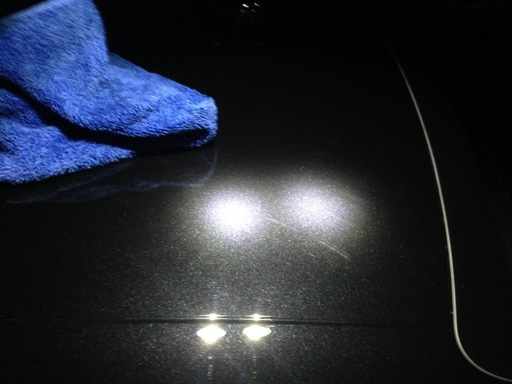

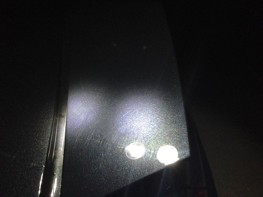

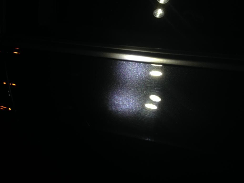

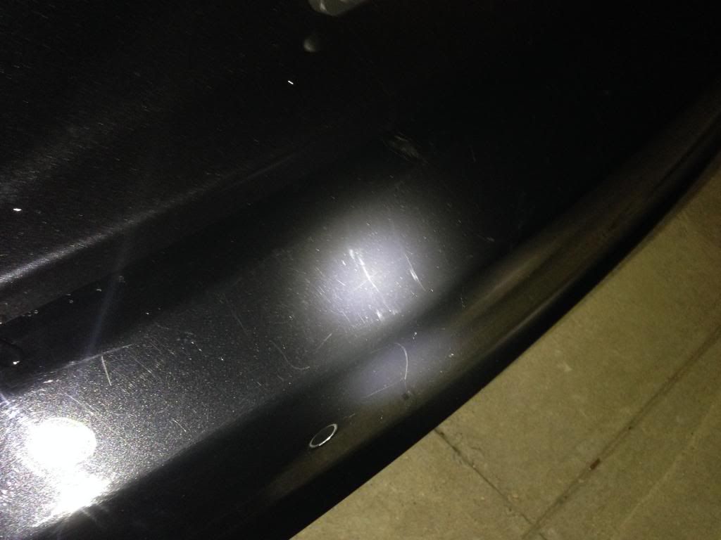

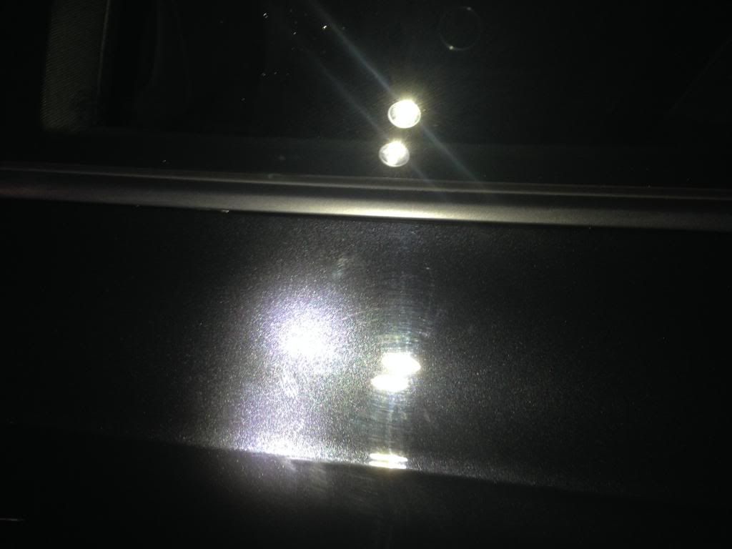

This 2013 Audi RS5 came to me with the worst swirls, buffer trails and scratches I had ever seen in a practically new car. Car had about 11k miles, the owner took it on several road trips and was not afraid to drive it. He was also not aware that Mechanical car washes scratch and put swirls into the paint. After looking at the paint, I offered him a full paint correction. Picked up the car on a Monday and kept it to Wednesday. Did not have too much time to take pictures during the process but I did try.

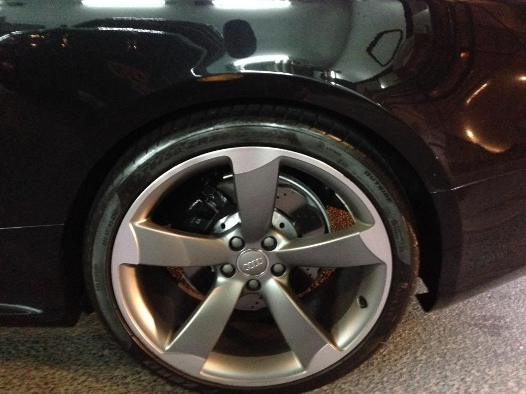

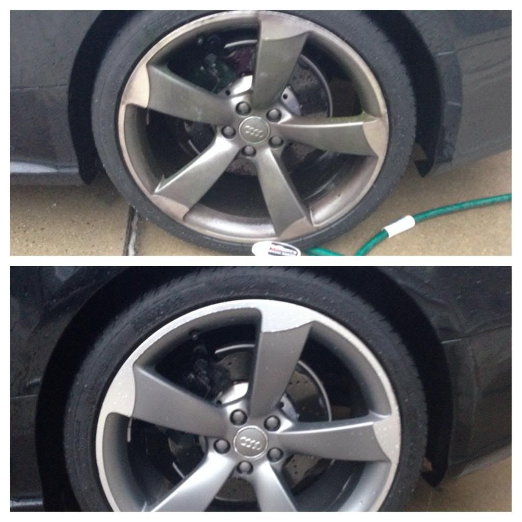

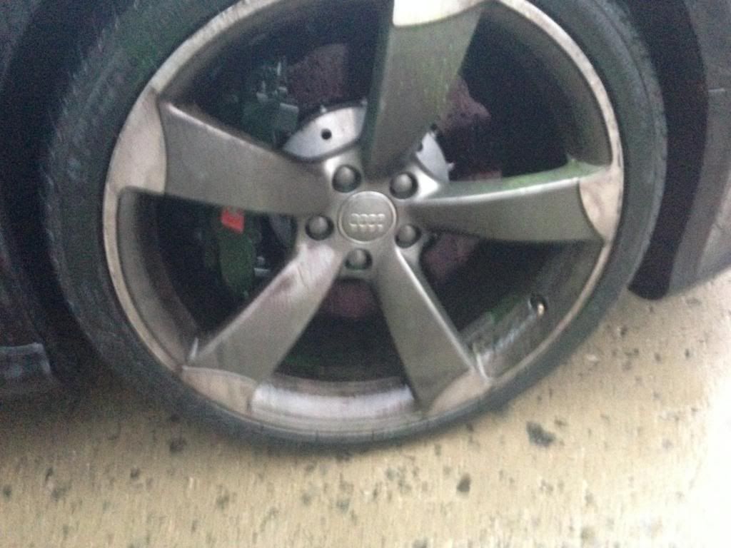

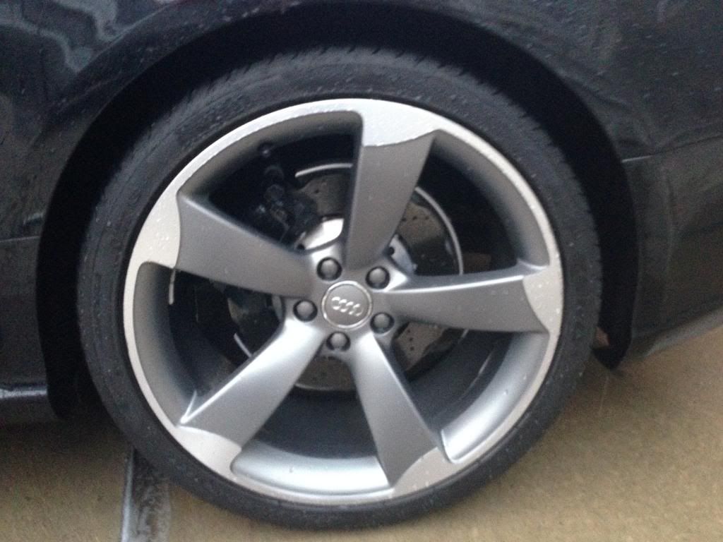

Wheels:Before & After wash
Sonax during:
Wheel after:
Paint after prep:

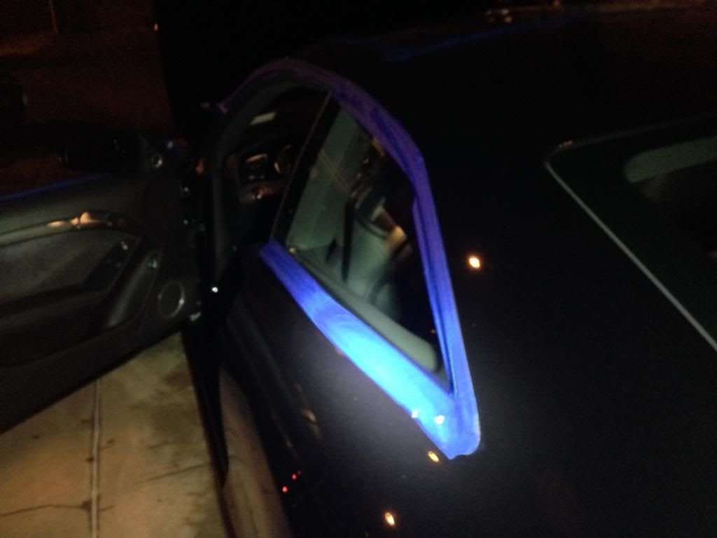

Tape Up:
Rear Bumper:

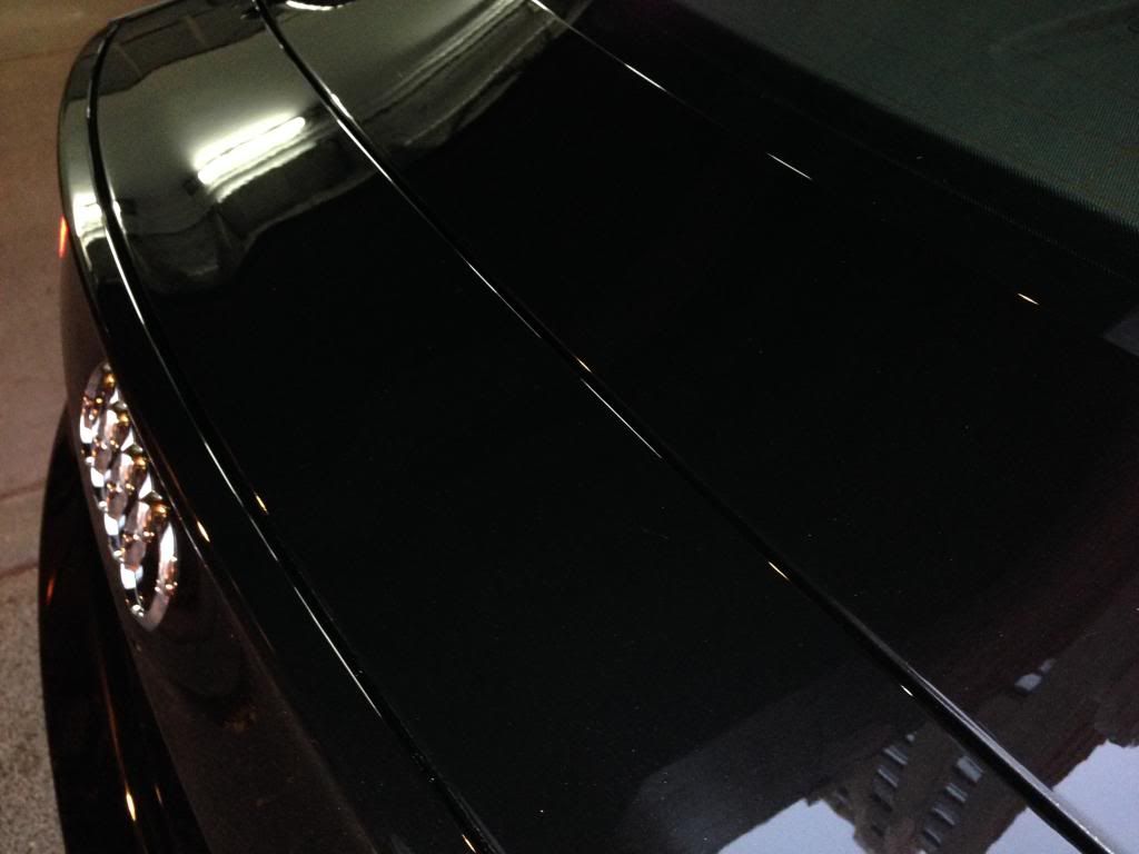

After:
Just that one big scratch-Needed more attention and touch up.

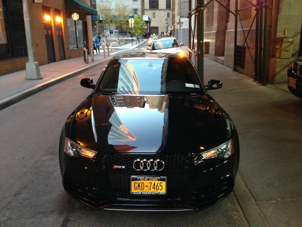

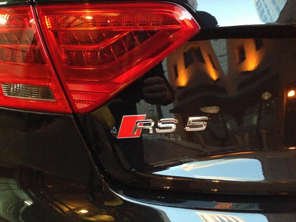

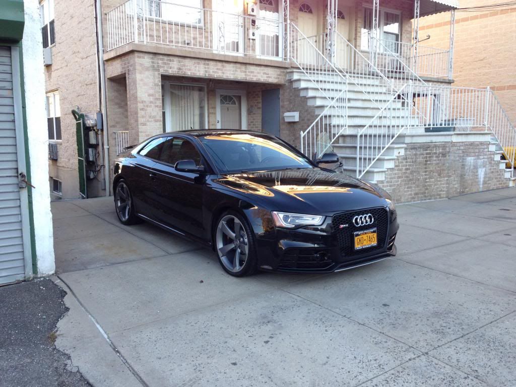

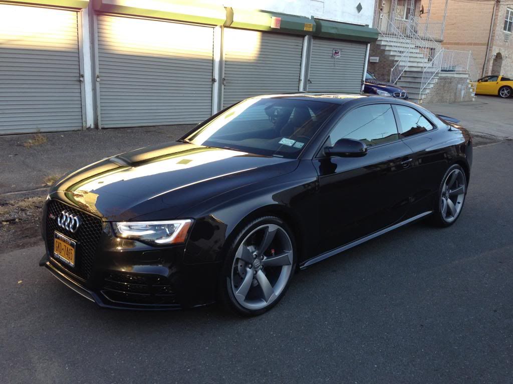

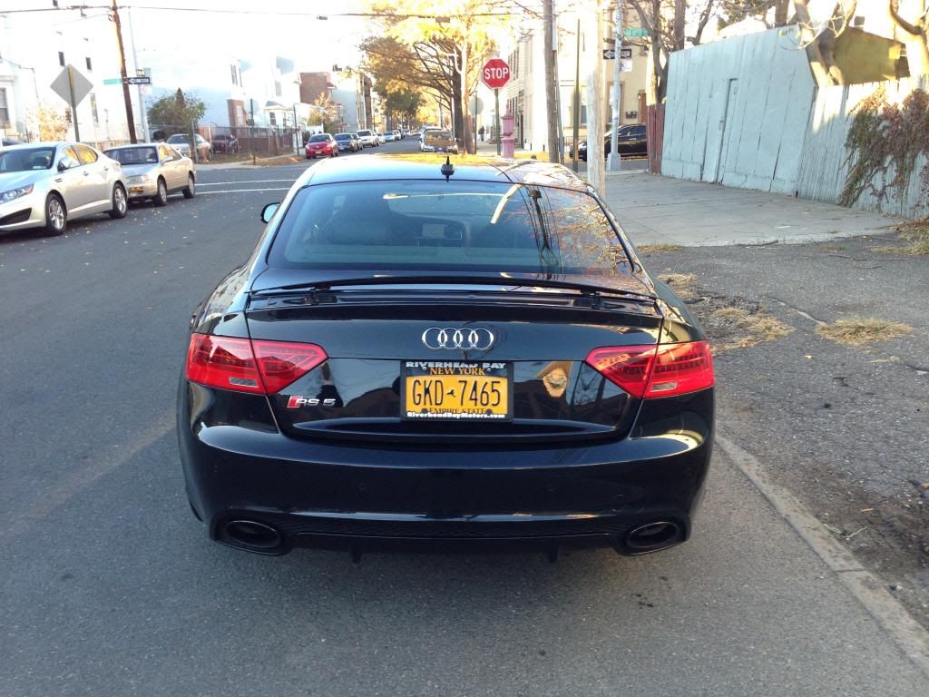

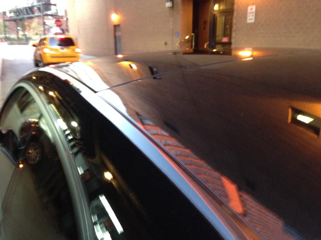

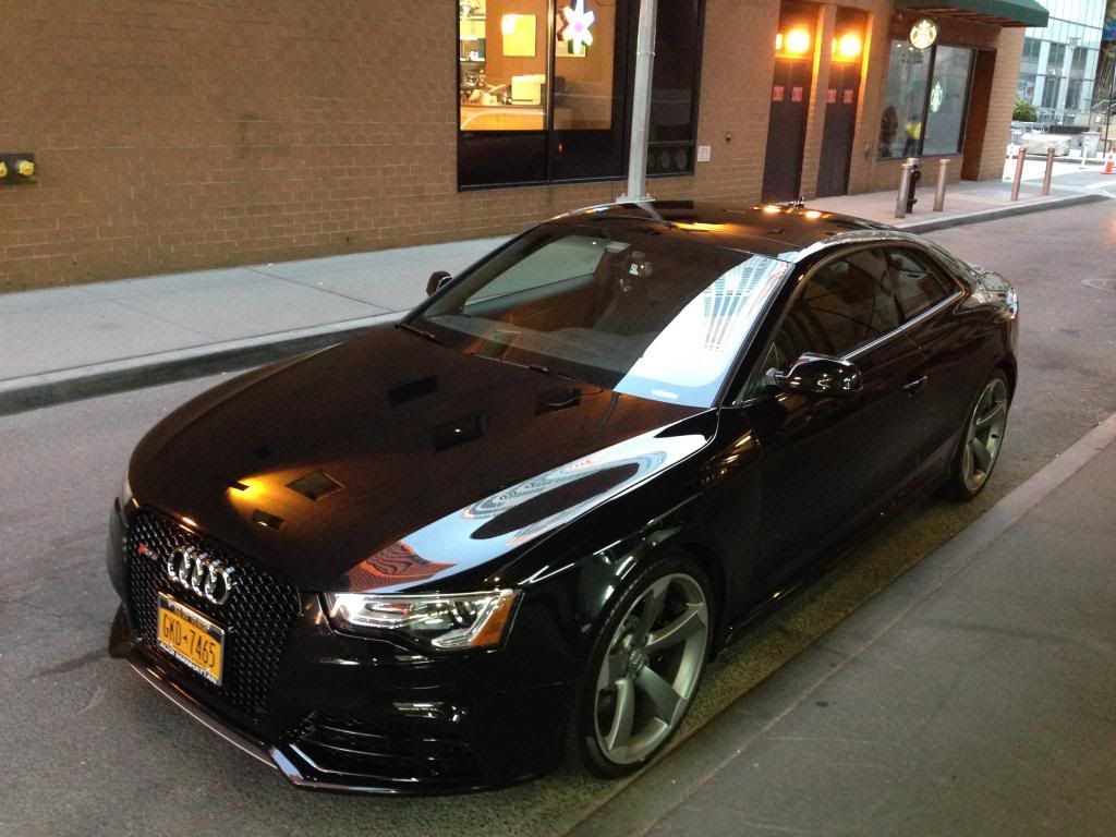

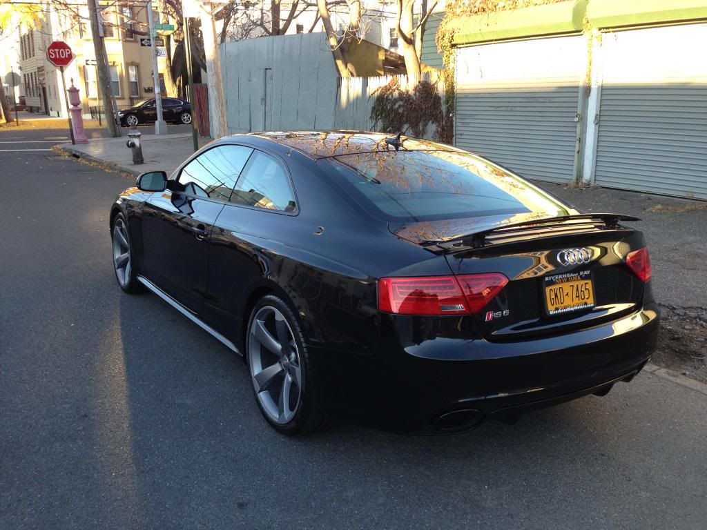

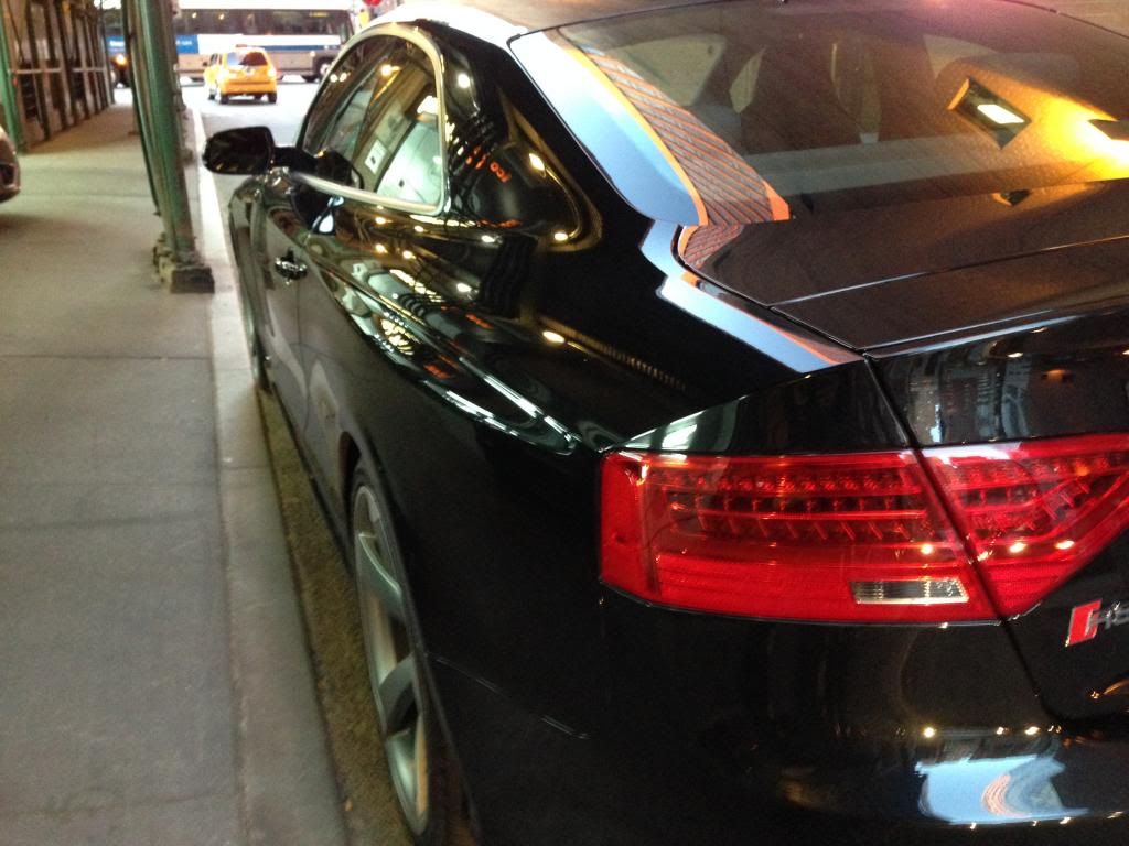

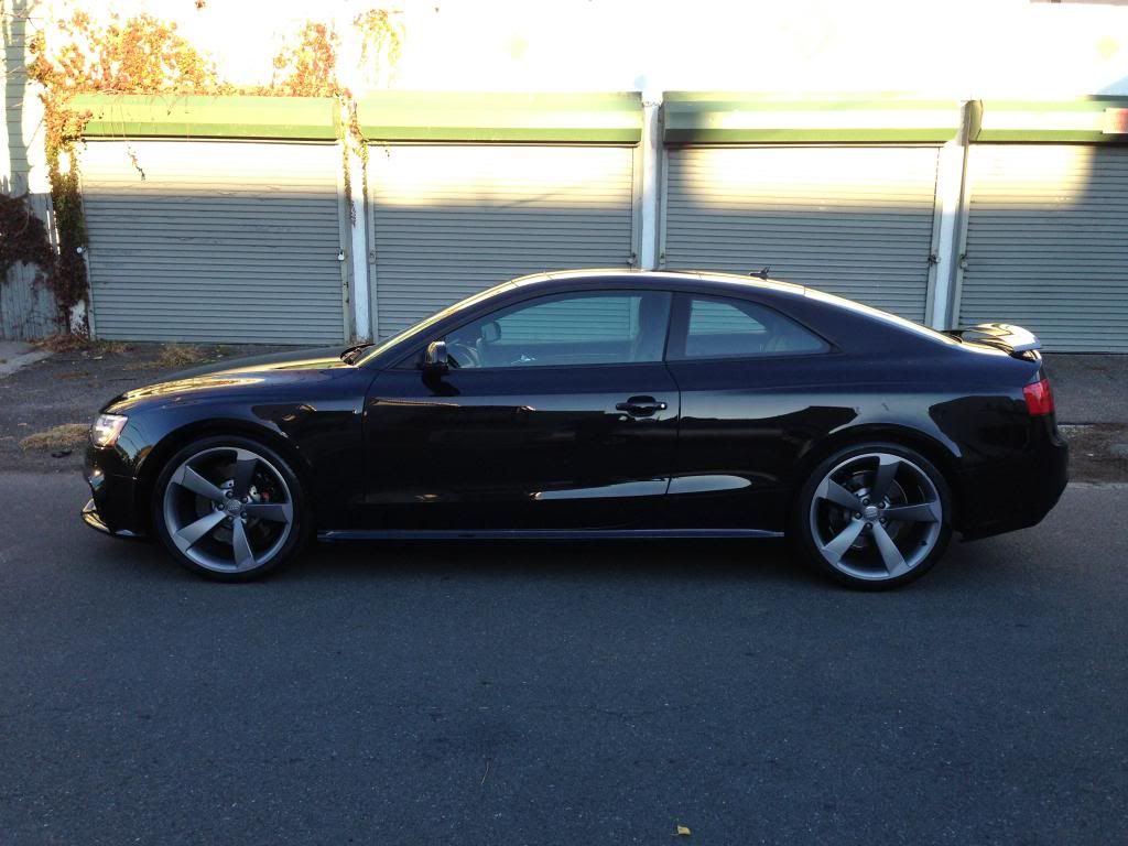

Full Car pics:
Chemical Guys Black Light and V7 combo to finish the job
After 303:

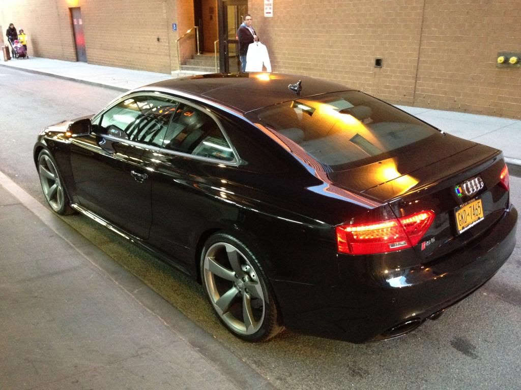

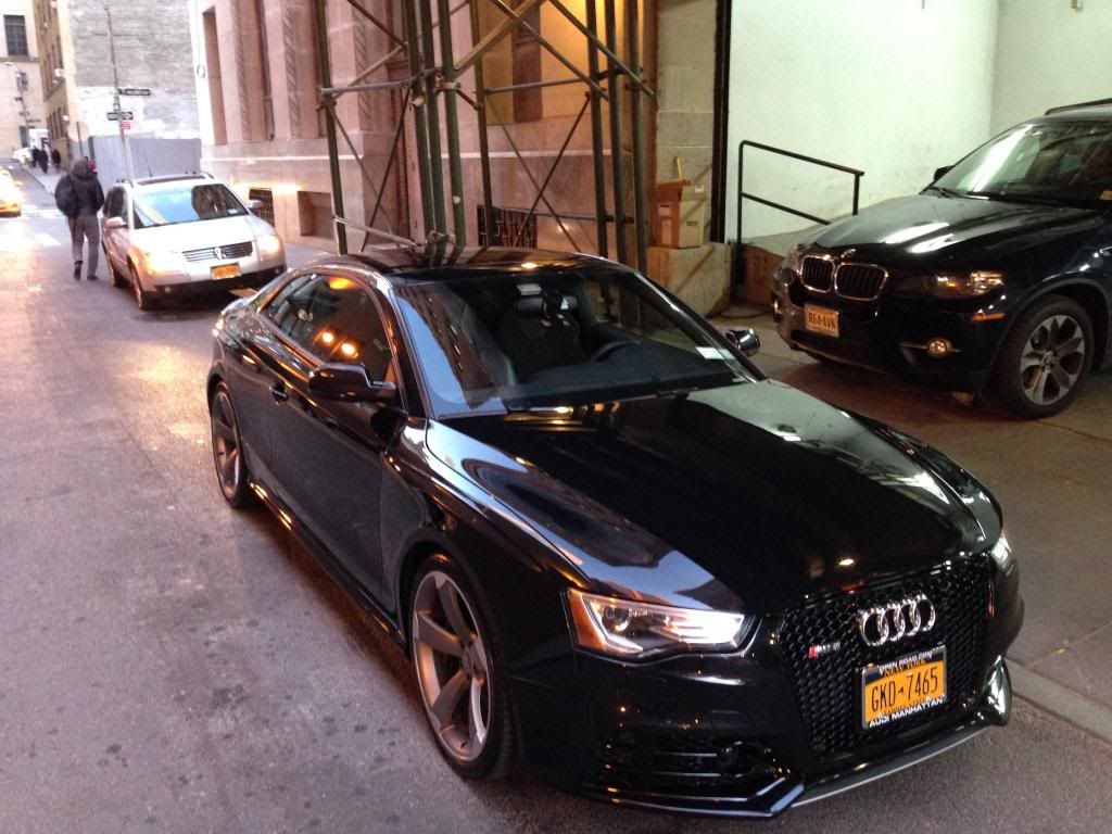

Lower Manhattan By the Freedom Tower delivering the car to the Customer:

Thank you guys. I was very happy with the results and the wet shine from the blacklight and v7 combo. Plan was to put a layer of Blackfire Wet diamond as well but owner did needed the car quickly. He said he'll bring it back for maintenance wash and wax in a couple months.

Correction:
Optimum microfiber cutting pads on the Flex 3401
Used the M105 & M205 combo on this one. (Uber Foam polishing pads with 205)
chemical guys Blacklight and V7 for the shine.
Correction:

I'll give that a try. I believe it's paint transfer from a concrete pillar though.
