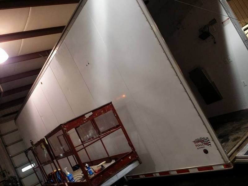

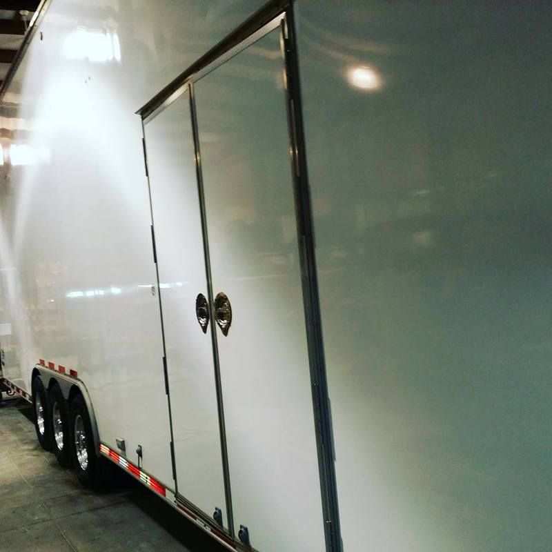

30 plus hours
Superior_Details
Jan 2, 2009
104

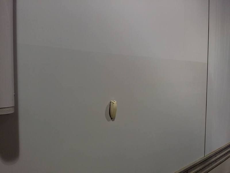

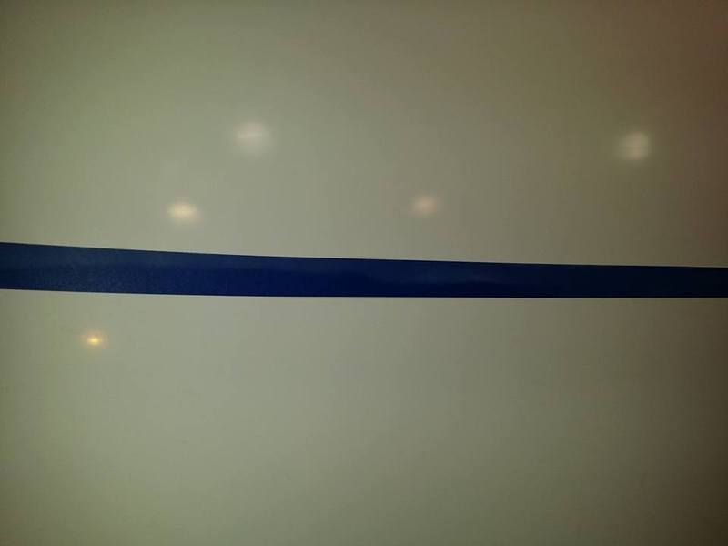

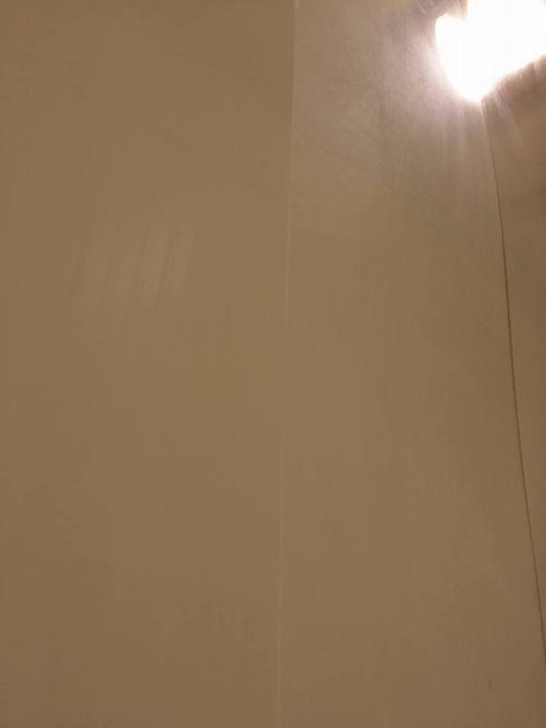

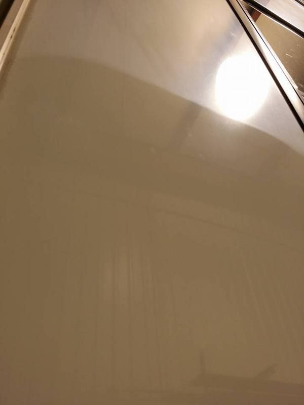

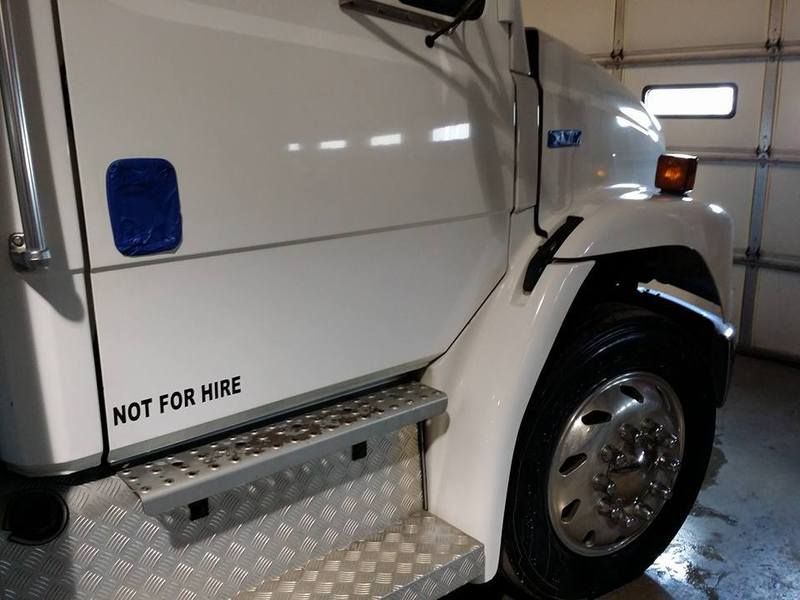

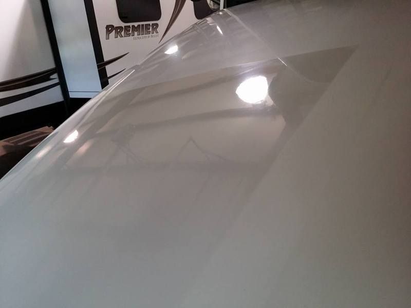

All painted aluminum was pretty oxidized, so i had to use a heavy degreaser (D-20) and went with Meguairs 1 step cleaner marine wax for the 2nd step, and final step was with LC blue pads and Megs Marine RV gloss enhancer.

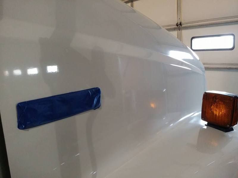

Cab was washed, clayed and M105 on yellow LC pads, then M205 with white pads, Blackfire Hybrid sealant wax by hand
That's a huge job! Came out brilliant. I take it that is a car carrier? I suppose if someone want's their baby hauled, it makes sense that the carrier look sharp!
Nice work!
yeah, it hauls Late model dirt cars, can fit two in there up top like nascar guys
i enjoy working on big stuff like that, might be more work, but it's a larger turn around!
good job!
