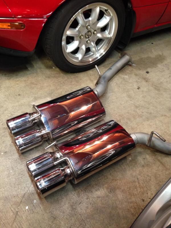

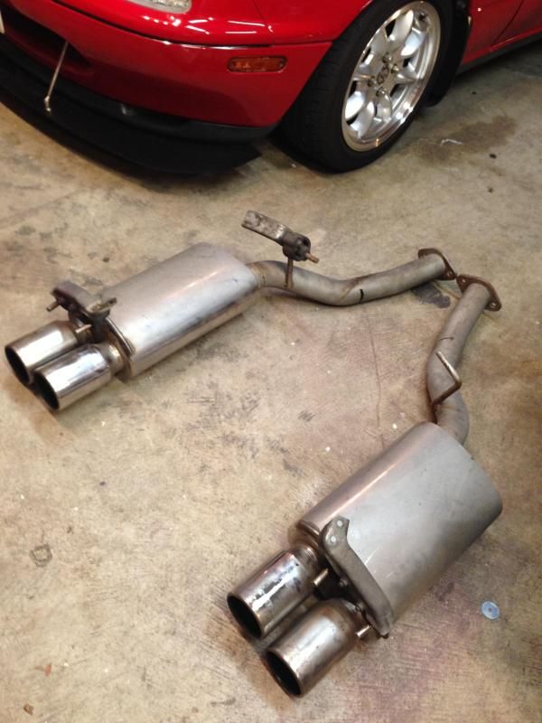

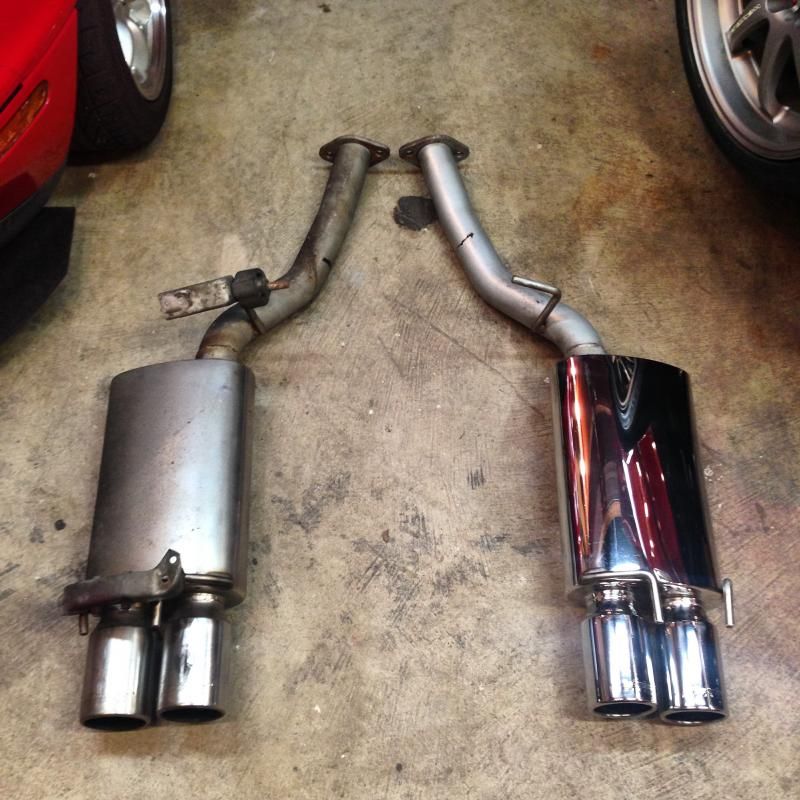

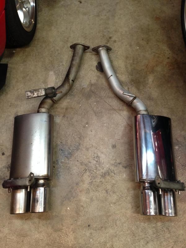

I purchased a Labree exhaust for my 300zx five years ago and never really gave them the love they deserved. I was installing new sway bars today and had the mufflers out so I decided to give them some much needed tlc.

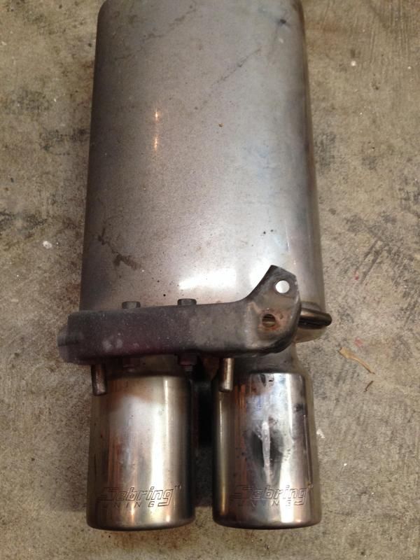

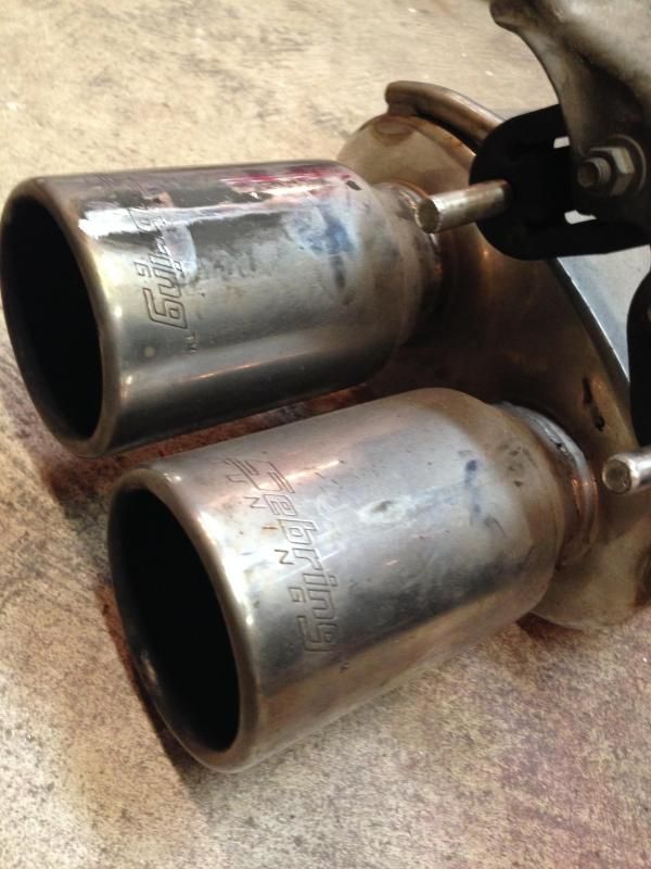

Initial cleaning was done with Meguiar's Super Degreaser.

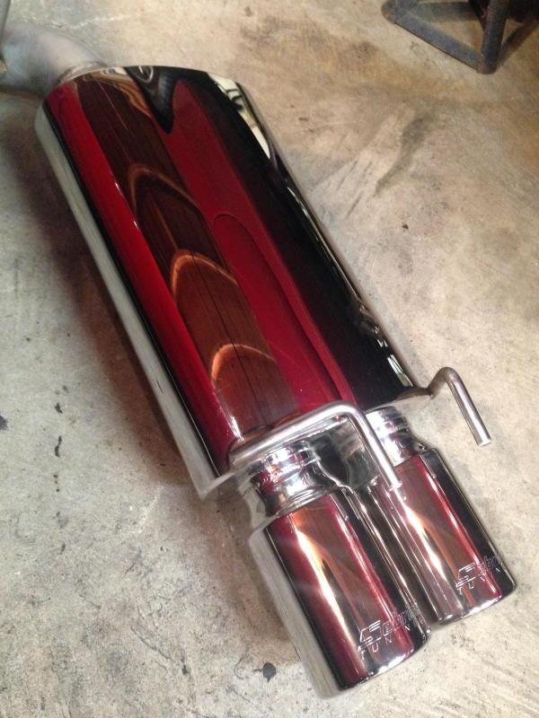

I performed some light sanding with Meguiar's Unigrit discs and paper and followed up with Wolfgang Aluminum Compound (works well with stainless steel).
After a wipedown with CarPro Eraser, I threw on some Opti-Coat 2.0 and wiped away the left over high spots.
Loving the way these came out. Might have to do the same thing to my Miata's exhaust. :coolgleam:

Do you mind commenting a bit how you worked the WG compound, I mean, which pad, speed, pressure, how many passes, etc... If you also can comment on what #grit you used to sand, I'd appreciate.
Thanks a lot in advance,
Kind Regards.

Isn't the opticoat just gonna burn off.
The exhaust tips might be fine but I can't imagine that it would last on the muffler.

Sure, Sanding order was 800, 1000, 1500, and finally 3000 (Unigrit disc). I worked the product with a Lake Country wool pad at speed 5 medium pressure. Didn't make too many overlapping passes because it didn't seem like I had a very long work time with the compound. Some areas I polished by hand.
Wow nice work.... looks like new
The mufflers actually don't get all too hot even after a long drive. If Opti-Coat can withstand the Texas sun cooking my cars, I figured it can withstand the temps of the mufflers. I'll see if I can test its durability a little later down the road.
