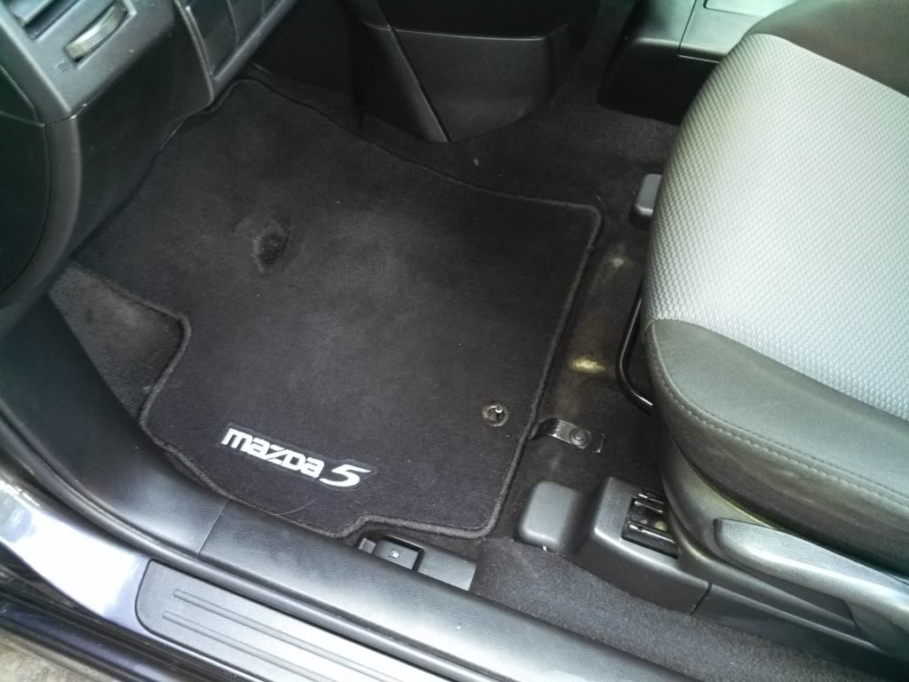

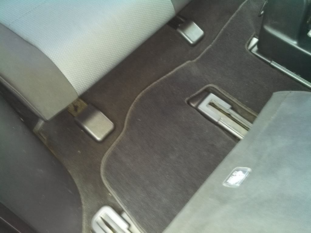

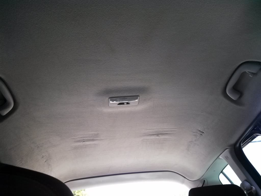

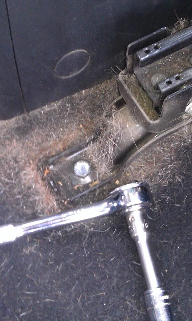

Here's the gross before pics and this was AFTER the customer vacuumed out the 3" of hair!
CAN YOU SMELL IT?
After a few mins we realized that we needed to remove the seats so we could remove all the hair from the floor properly.
We broke out the DAB to really lift up the hair and dirt
Lot's of dog drool all over the place

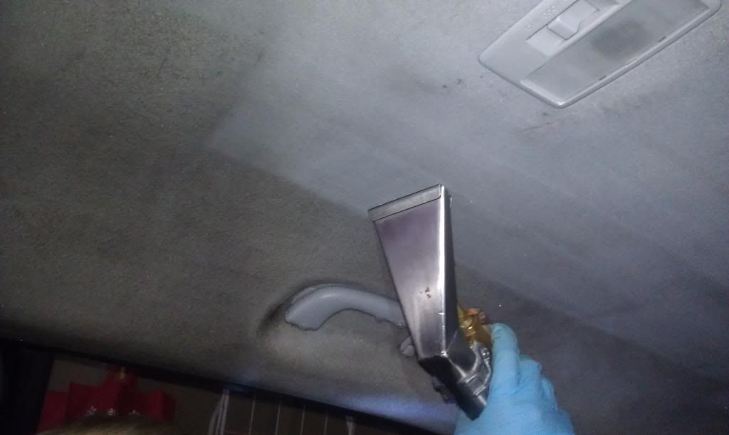

Don't forget the ceiling! Dirt was in every nook and cranny.

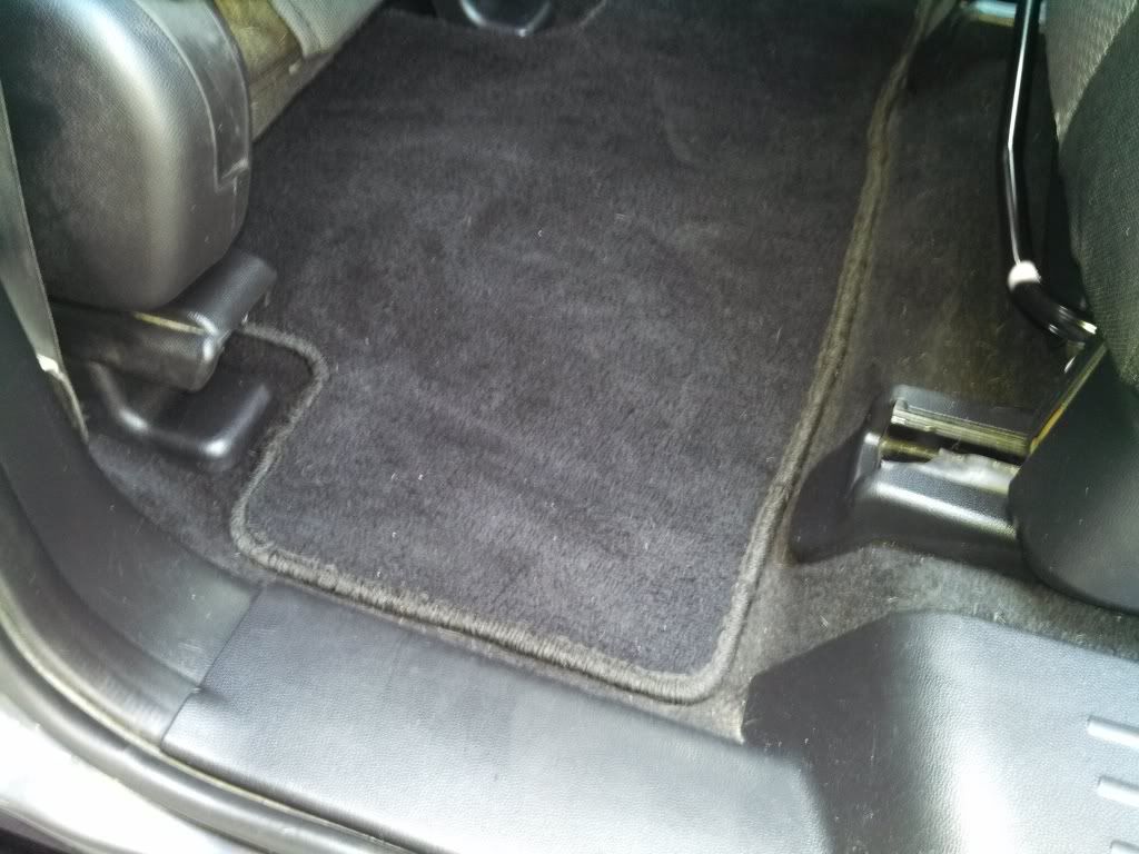

The carpet extractor did a great job of cleaning it.
After 6 hrs of vacuuming the sun was going down and we had to finish it the next day. Well that didn't happen either. The interior was to wet to tell if all the dirt was off.
So I let it dry out for a few days so we could check on the dirt and the smell.
On the third day I vacuumed up what hair was left and then ran the Ozone Generator to get rid of the smell.
I ran this in the car for 4 days!

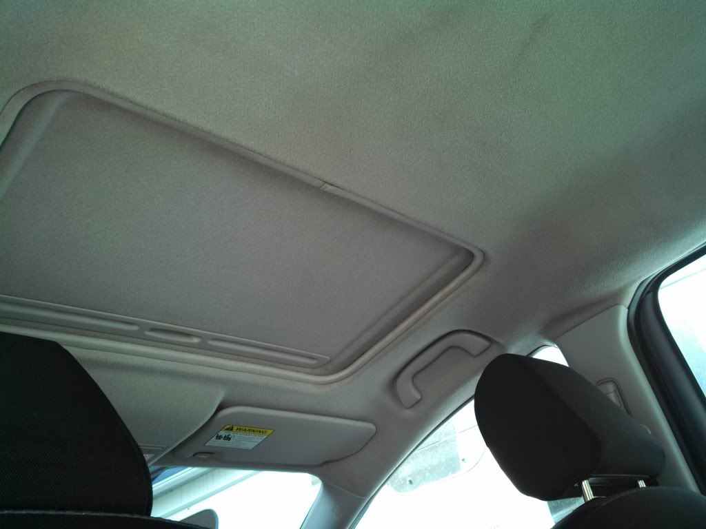

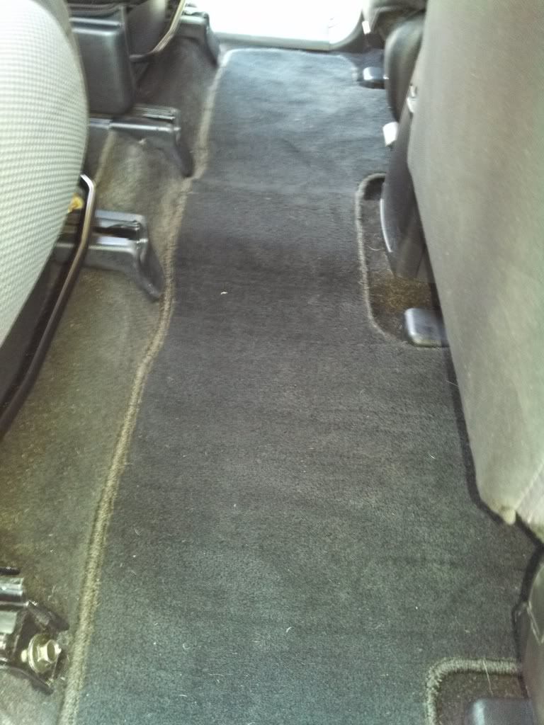

Here's the after pics of all my hard work. and yes, I got paid well for this job.

Isn't it bad to wet ceiling? If not, that's great to hear, was always told if you wet them, they will droop. Other then that, AMAZING job!!!!!
I'd also like to hear some more on the headliner process, did you use the hot water from the extractor?
Nicely done. How many hours total did you have invested here? Any exterior work?
Thank you all for the Kudos. I worked very hard on this. I love a challenge and now I'm not afraid of any interior!
Older headliner would probably drop. This being a newer car I wasn't afraid of cleaning it.
No hot water. I sprayed with water then APC and used the extractor to remove it. I didn't use the extractor like you would for carpet. This dirt was on the surface and came off relatively easy.
Mario I like looking at your work its always top notch. Nice job on the head liner!
PHENOMENAL job!! Pet hair is always a pain and I'm glad to see you overcame that challenge as well as you did. Also, great shot of the headliner 50/50; that looks awesome!
