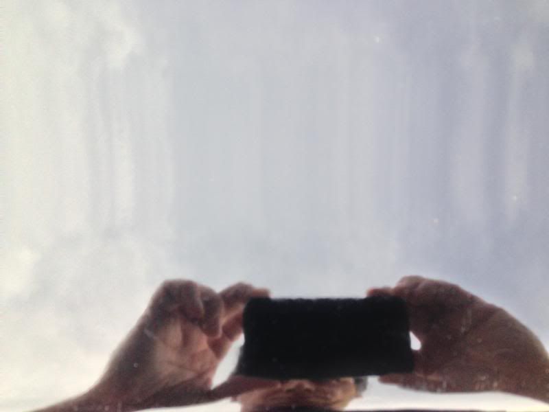

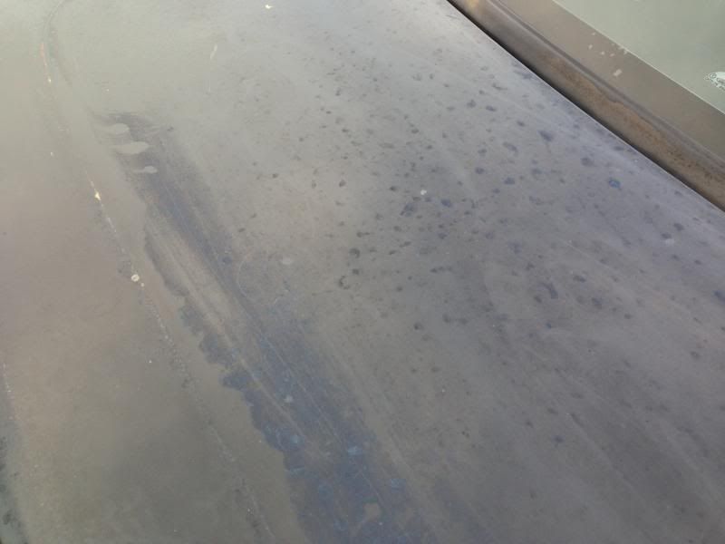

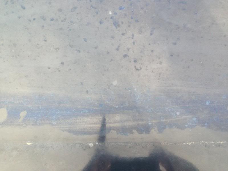

So basically my 98 cobra hasn't been driven in 2 years due to a motor swap and me becoming a father. In this time it spent about 10 months in a garage and the other time outdoors with no cover on it. As you can imagine the paint looked bad. Wax was long gone and the paint literally feels like sandpaper. So the other day since I'm waiting on tuning I decided to go ahead and clay the car. After washing of course. The trunk looked the worse. So today I decided since I had a few minutes I would try and see what kind of finish I could get. Here are a few pictures. Sorry for the I phone quality.
Before pics:

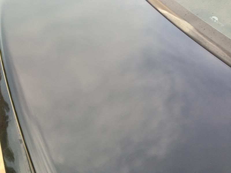

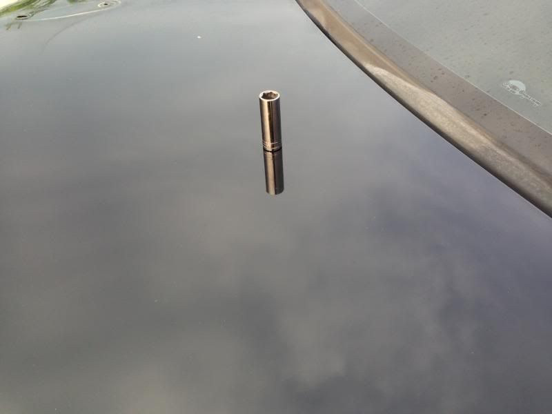

After. I couldnt find my tape but its the same area and angle.
This was only after a few passes of each. no swirl remover. 105 was on an orange pad on speed 5. 205 Was on a light blue pad on speed 4. I'm still learning but like everyone says its hard to mess it up with a GG
