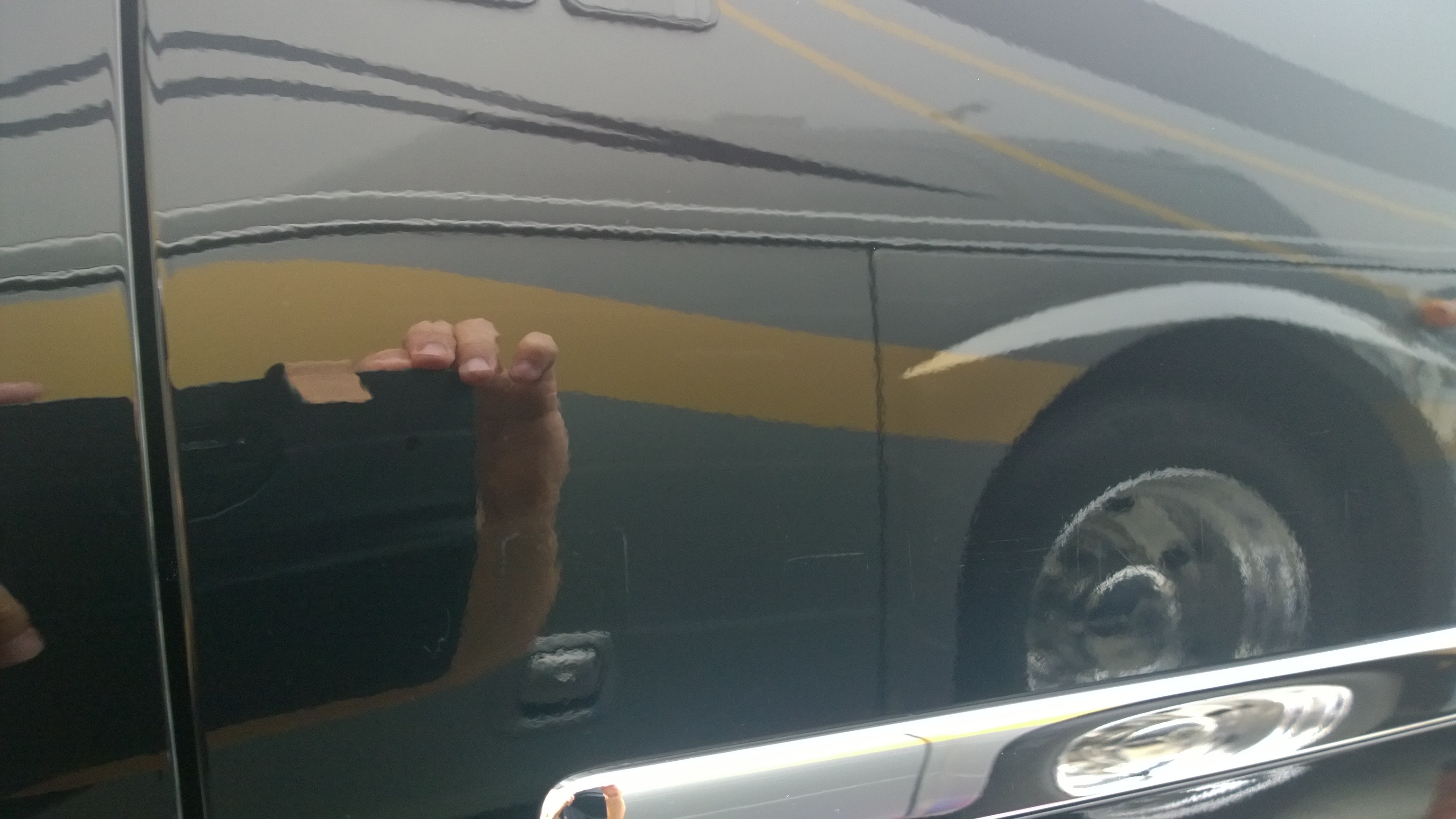

View attachment 74971View attachment 74972

I was using 4 or 5 drops of polish and starting adding a light spray of diluted ONR. I don’t have an air compressor to I try to clean the pads by wiping with a MF towel between panels and use the pads for two panels generally but sometimes go too long. I have 3” and 6” older GG polishers. On this car, I used light pressure, speed 3.5-4, and 3 slow passes followed by 1 faster pass.
I did do two additional very light passes with black pads and Sonax NP something. The car had so much dust that I had to wipe it down so I used 50/50 IPA/water instead of Eraser and applied very little pressure. I don’t know if I was seeing something left from polishing before, the extra polishing or two coats of CQ UK hid it but the car turned out really nice. I do think the Mezerna was difficult to wipe off and Eraser seemed to soften the paint.
I’m starting to get a rash when I see a black car drive by!
I just ordered Sonax Perfect Finish and will definitely try LC white pads on the next black car.
Thanks for every tip and reply!
