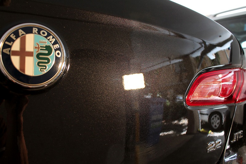

3 steps correction:
M105/Yellow Uber pads
Menzerna SIP1500/Green Uber pads
Menzerna SF 4000/Blue Uber pads
Protection:
Menzerna Power Lock
Total time:
11 hours

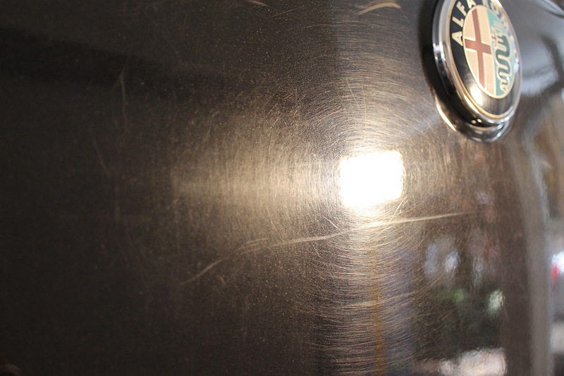

This is a bride...

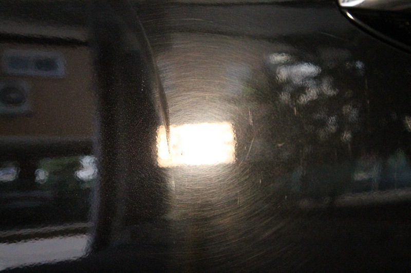

The paint defects...
Do not need any light...
50/50 after M105...

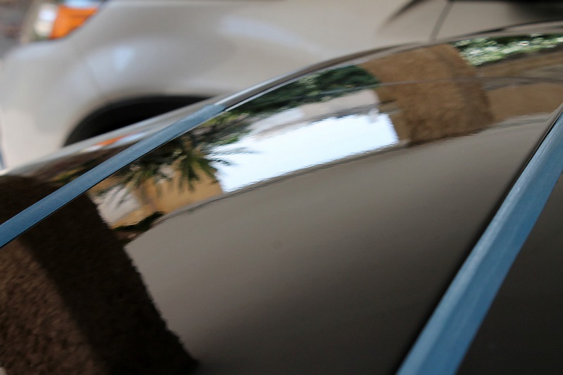

The roof corrected...
The door corrected...

120 grit finish before, Menzerna mirror after! Great transformation, your final product is great
The car came out great, I mean really great and in some of the pics you see major orange peel and in other spots not so much, so I'm thinking some body work was done? As far as the car goes, WOW does it look beautiful!
From what I remember the hood was repainted, the rest of the car - factory paint.
