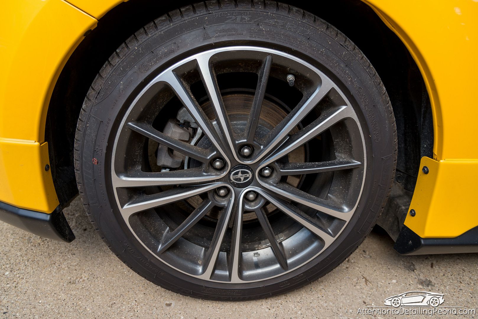

The wheels and tires were fairly dirty upon arrival
We began by spraying the tires liberally with tire cleaner (notice the dirt already forming on the concrete beneath the tire) and the wheels liberally with wheel cleaner to help break down the dirt and grime before we started washing them.

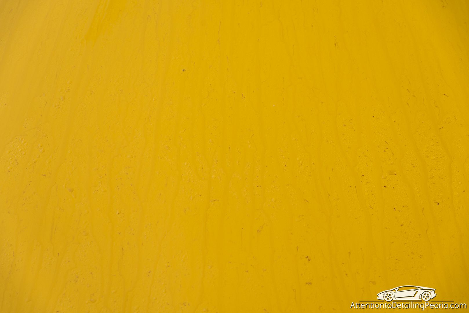

The car was then treated to an IronX bath to remove bonded iron particles. The paint was extremely contaminated.
IronX is a clear liquid that turns purple as it reacts with iron particles and starts to dissolve them. You can see all of the contamination on the paint once the chemical begins to work
Iron contamination was just pouring off of this car.

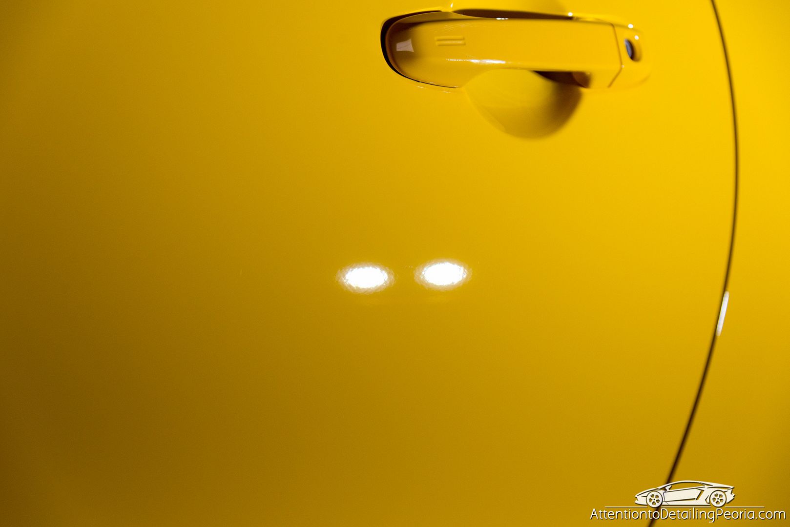

I began on the door, and the improvement was easy to see from the start. The polishing process removed the haziness in the paint and produced a darker color and clearer finish.

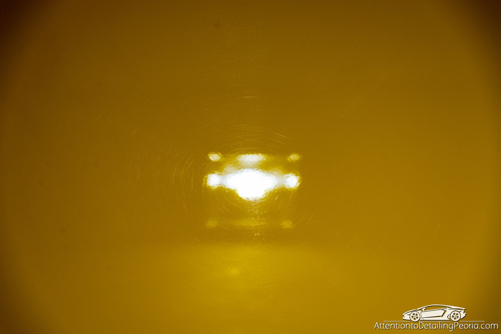

Door before
Door after
Fender before

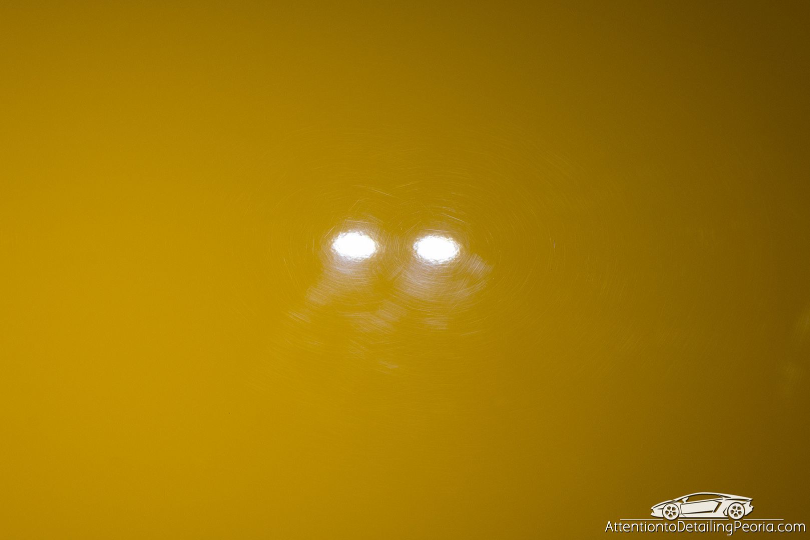

Door before

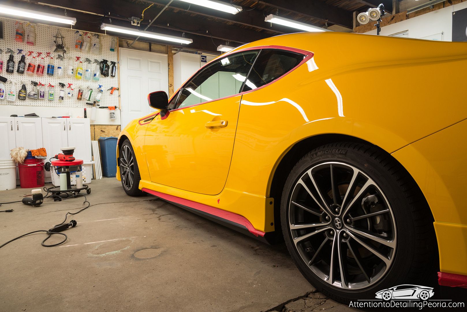

After the correction process was completed, the car was wiped down with a solvent to remove any residual polishing oils. The paint was then coated in 2 thick coats of CQuartz Finest paint coating which was then baked with IR Curing Lamps to promote higher gloss and hardness.

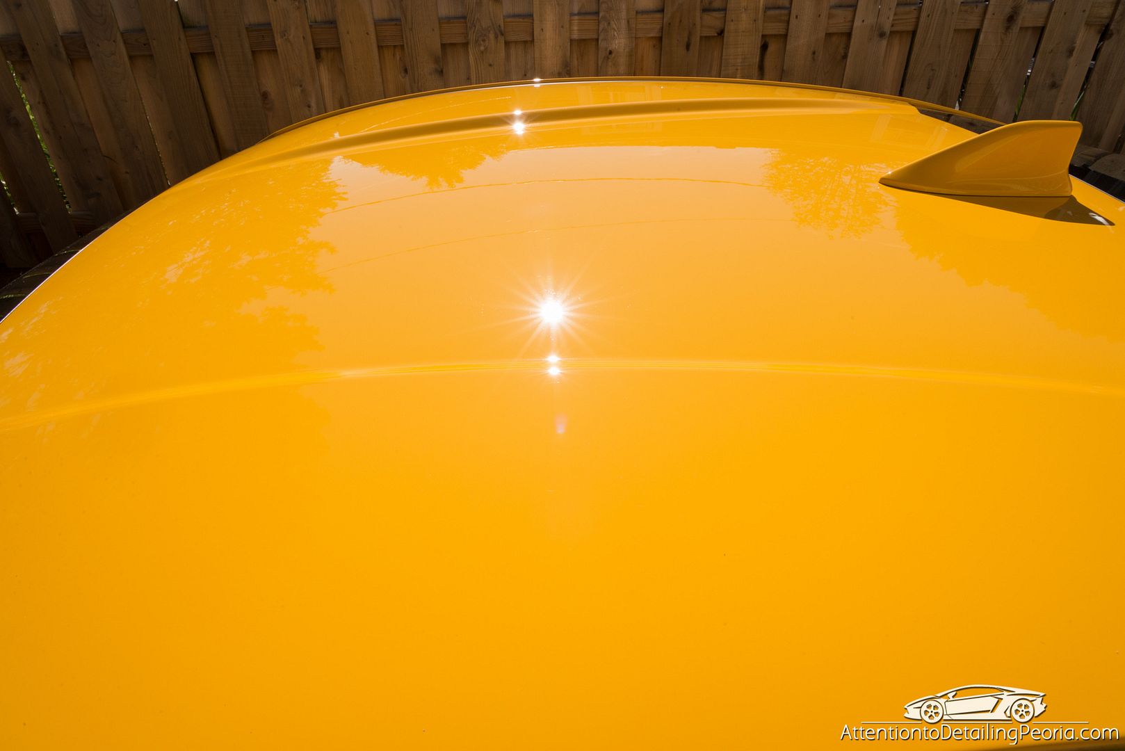

The paint was not flawless, however the color and clarity was drastically improved by removing the lighter swirls and defects.
The car looked stunning in the sunlight. Truly the most vibrant paint I have ever had the privilege of working on.
