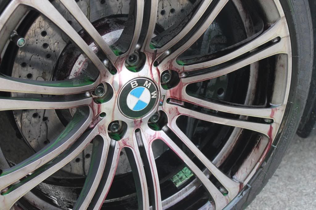

- Wheels hit with Sonax full effect and iron x

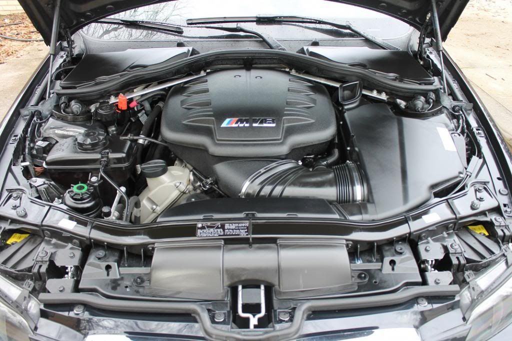

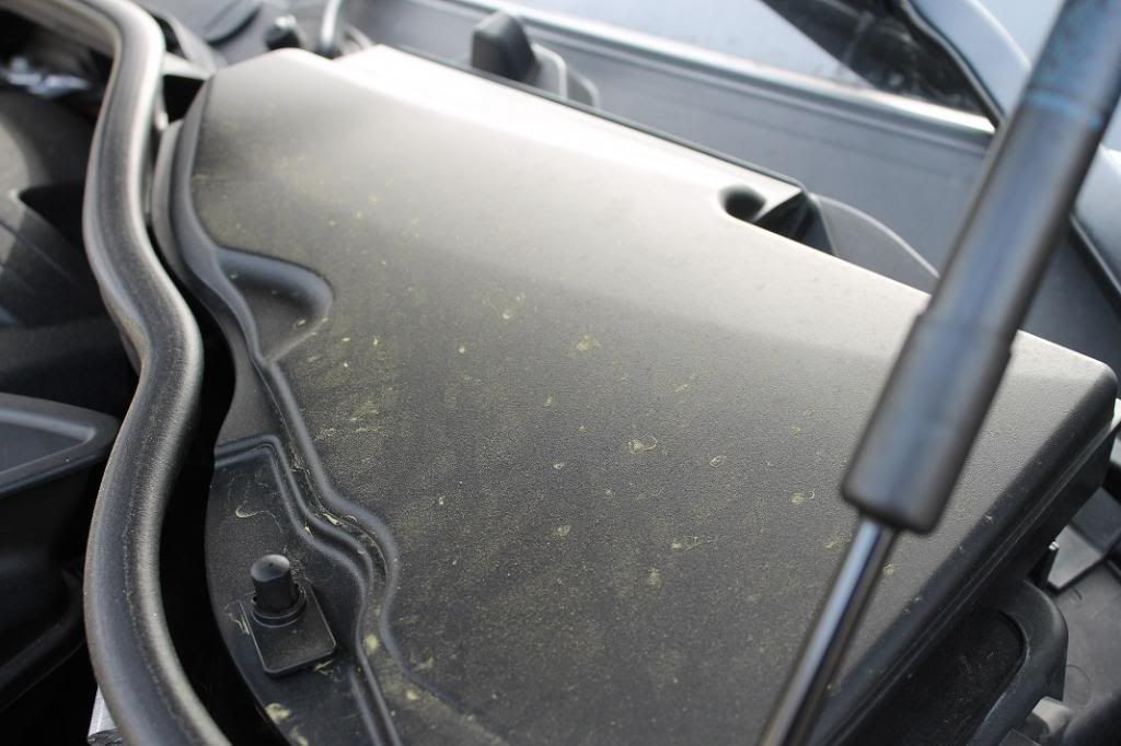

What was done to the engine bay :
- Degreased + Cleaned
- Rinsed
- All metals/plastics shined

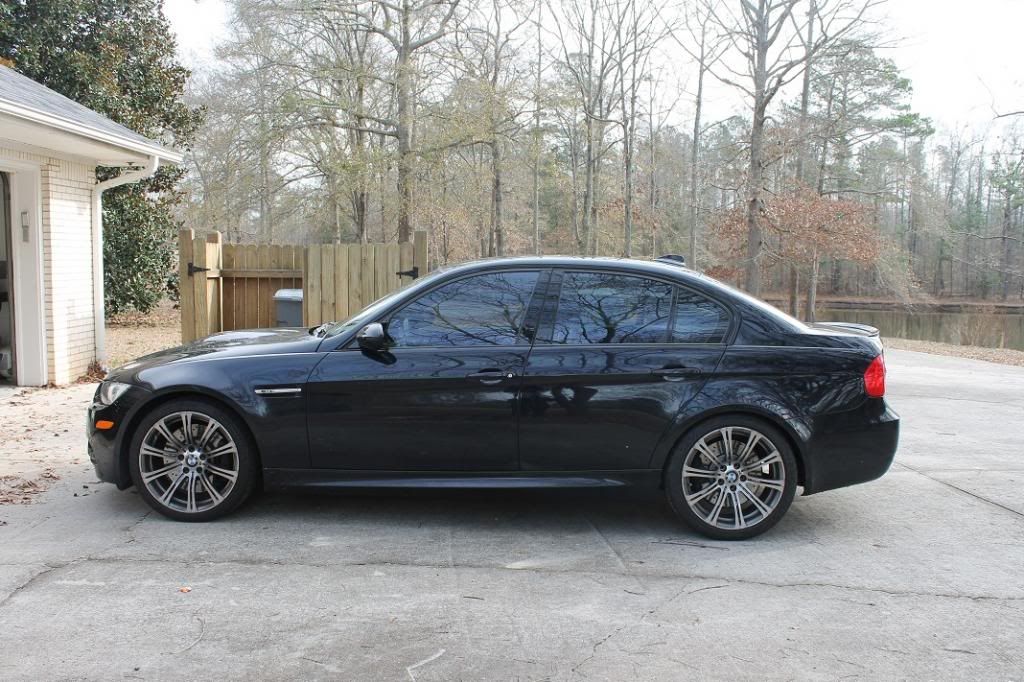

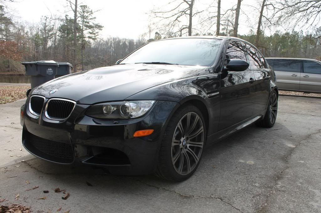

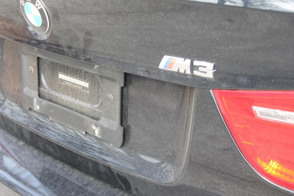

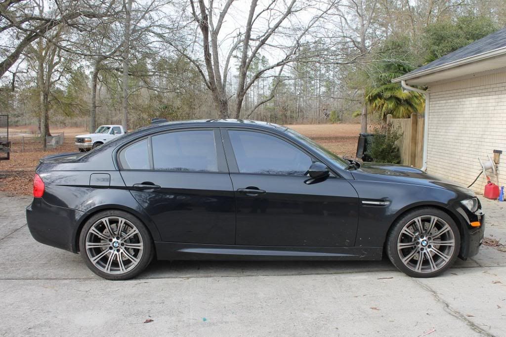

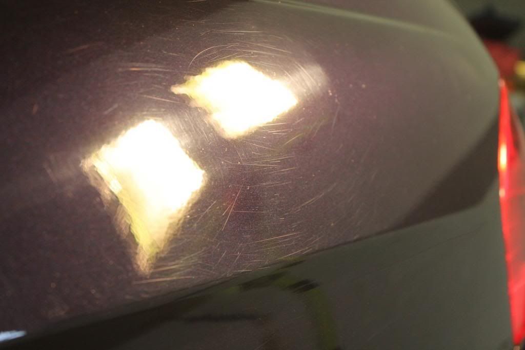

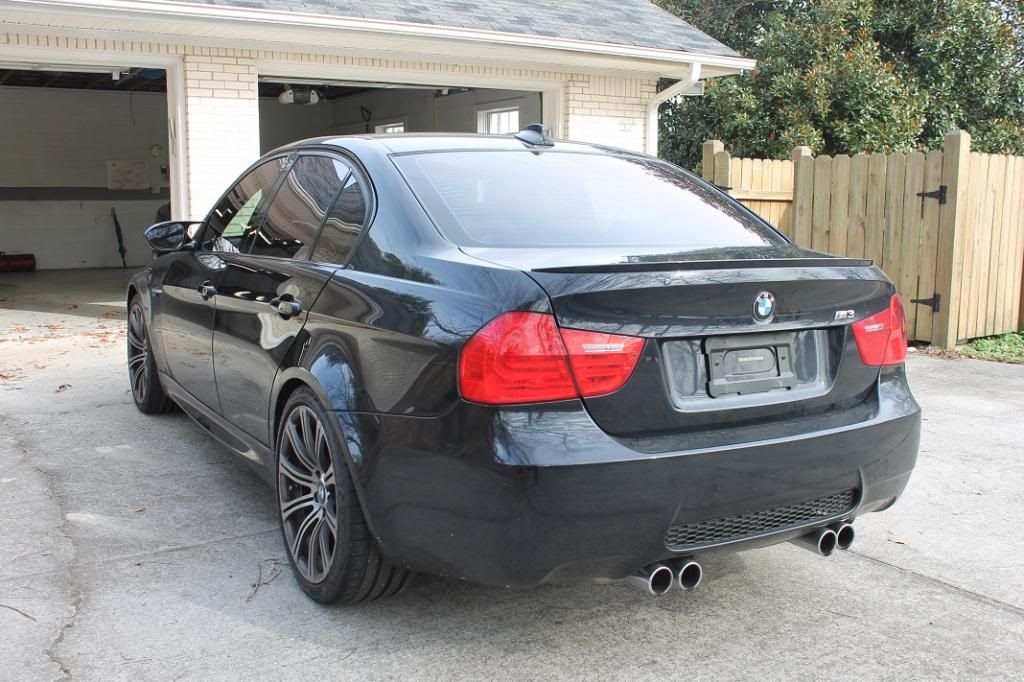

Upon arrival

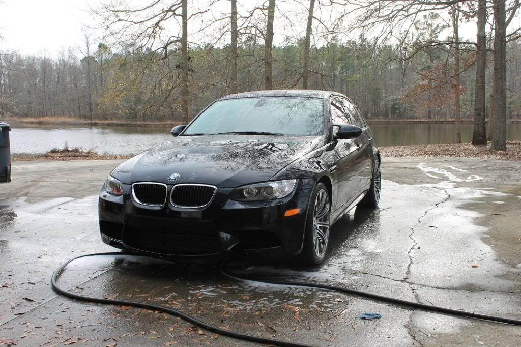

Initial wash done

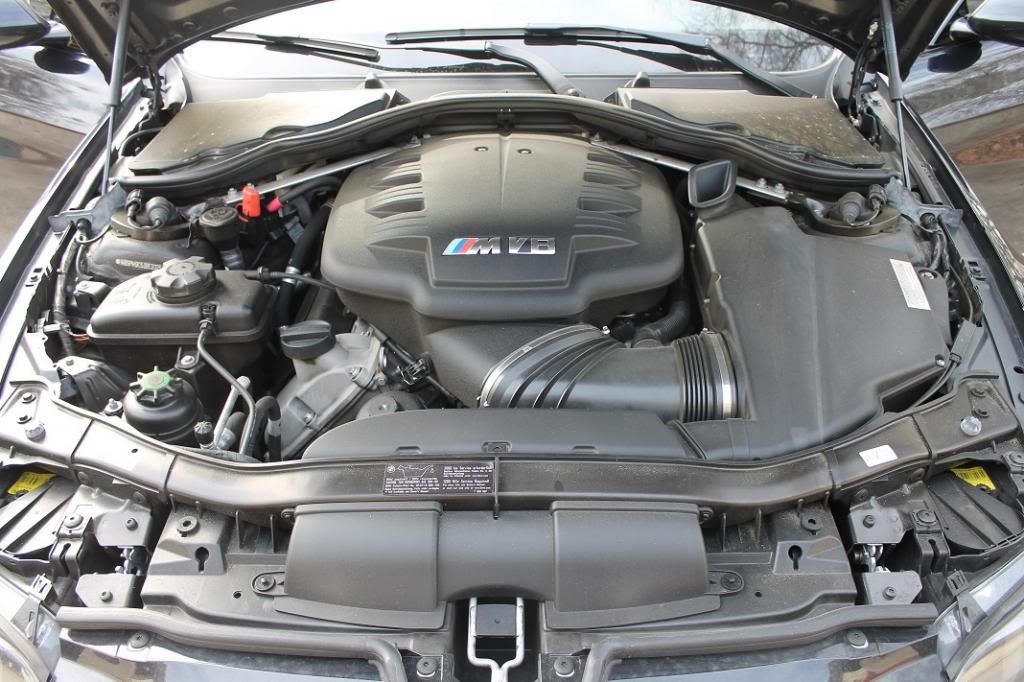

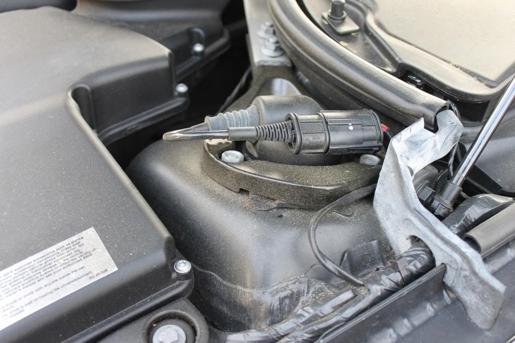

Engine bay detailed

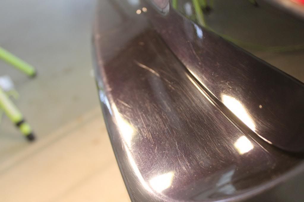

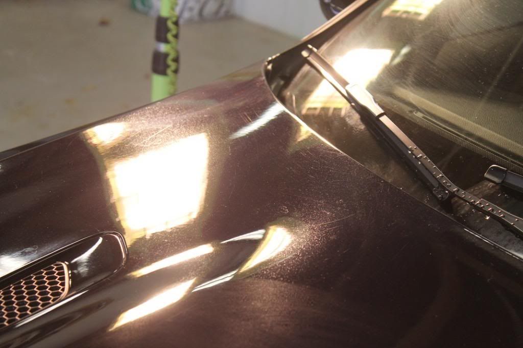

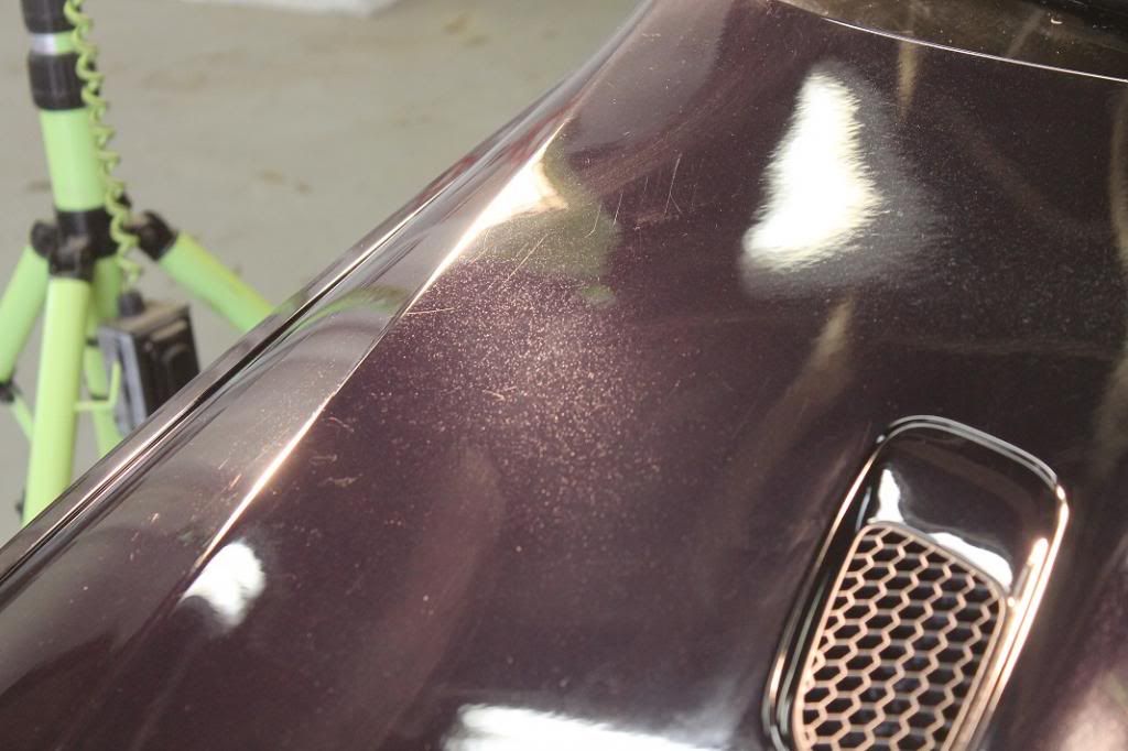

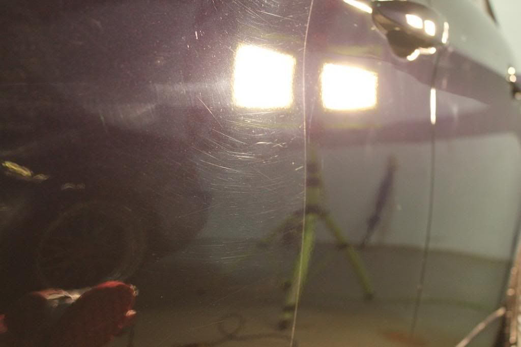

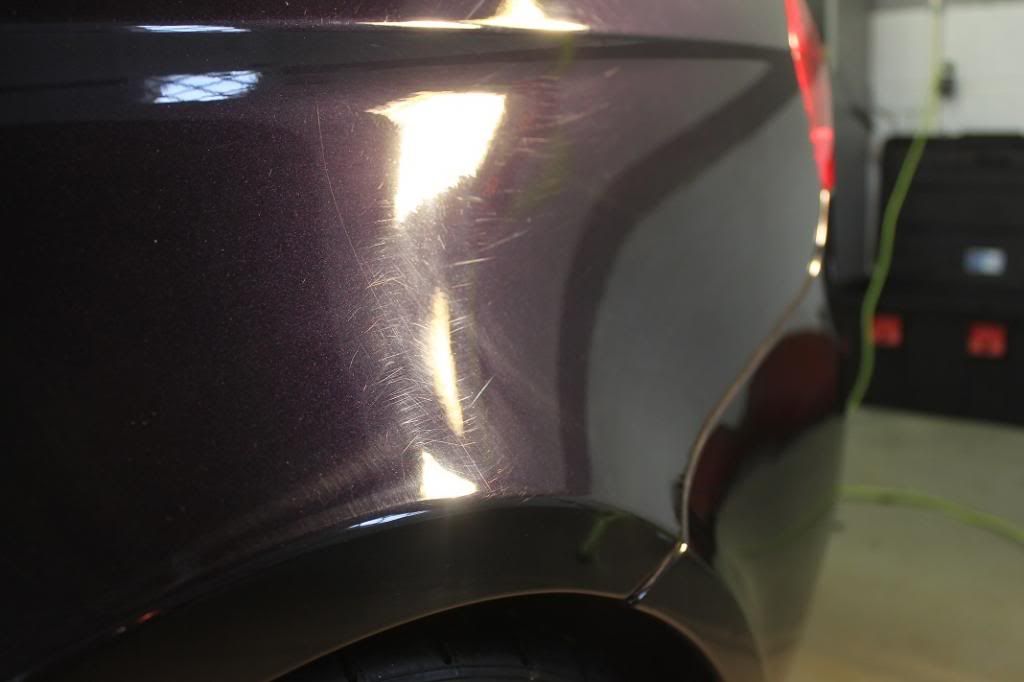

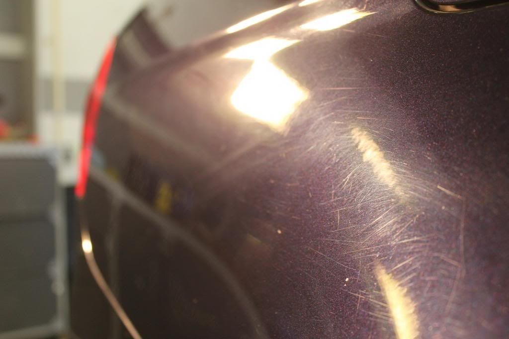

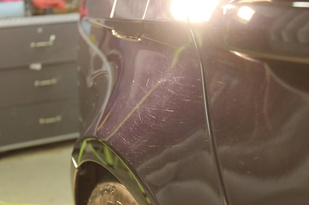

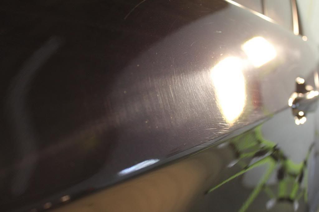

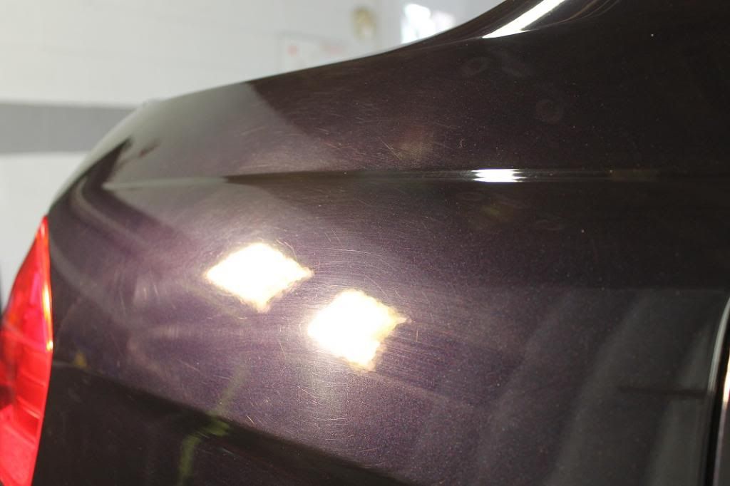

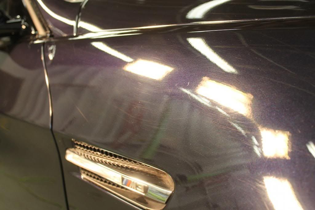

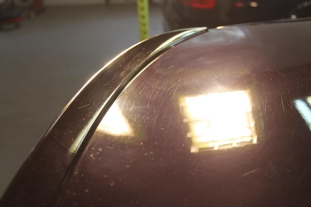

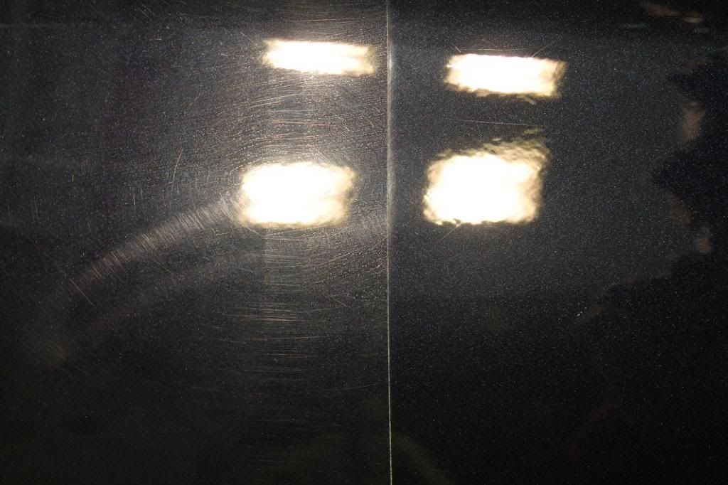

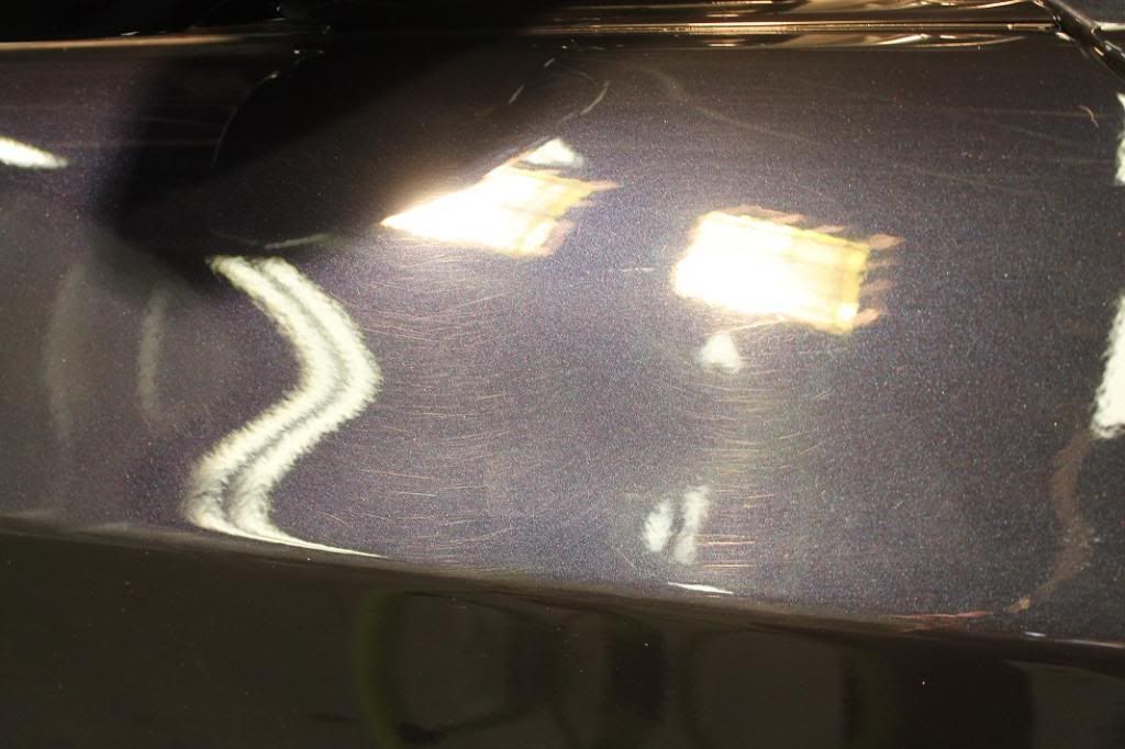

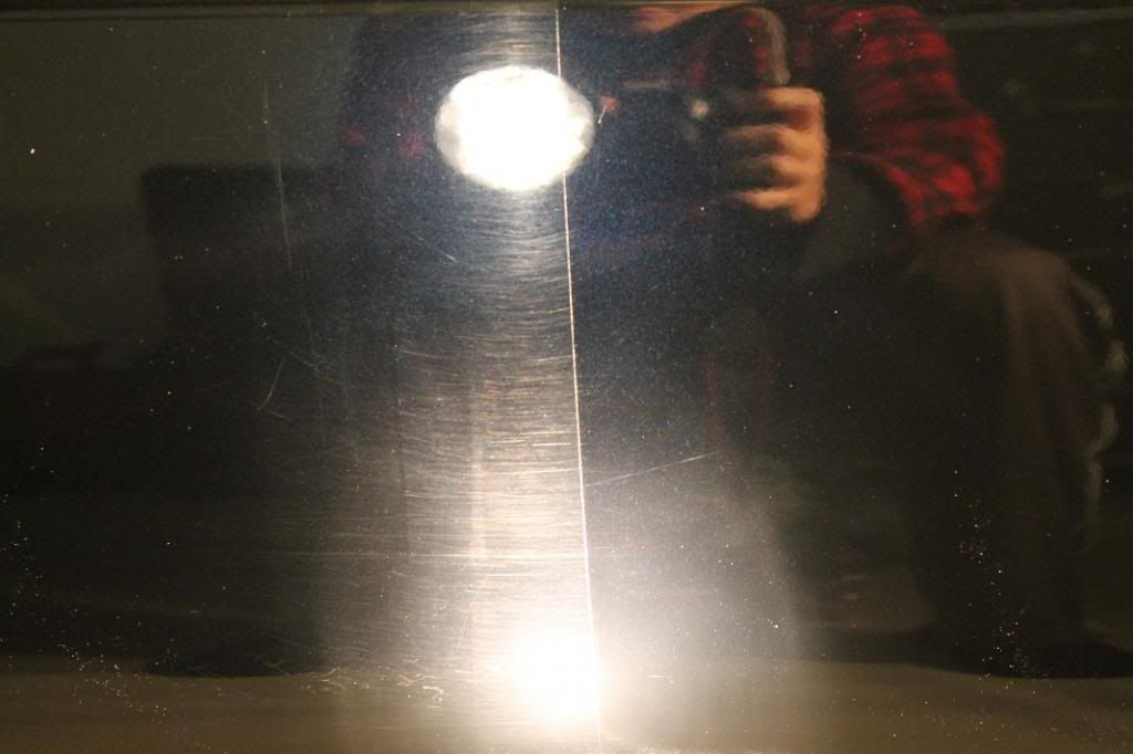

After one pass of M105 & SIP

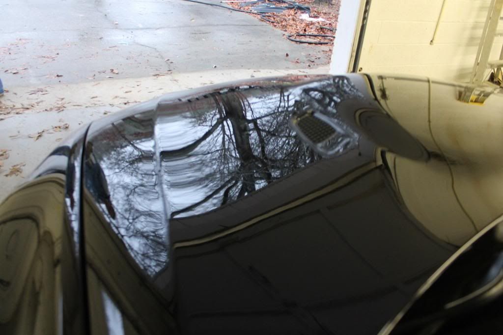

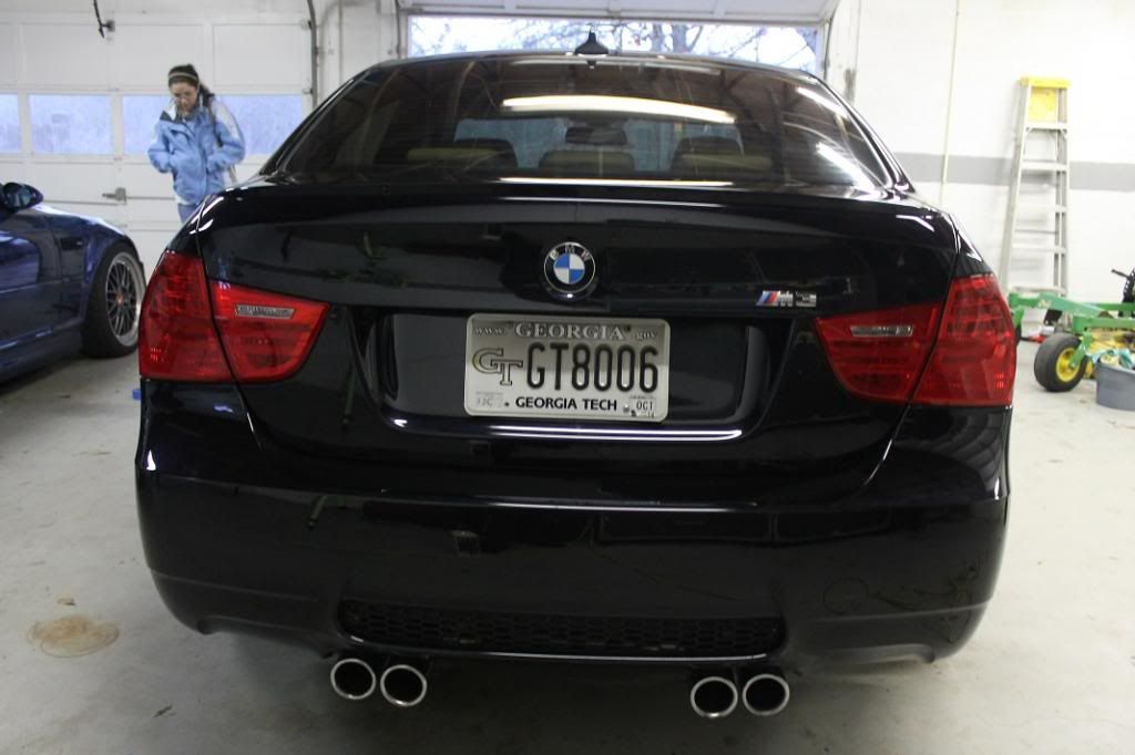

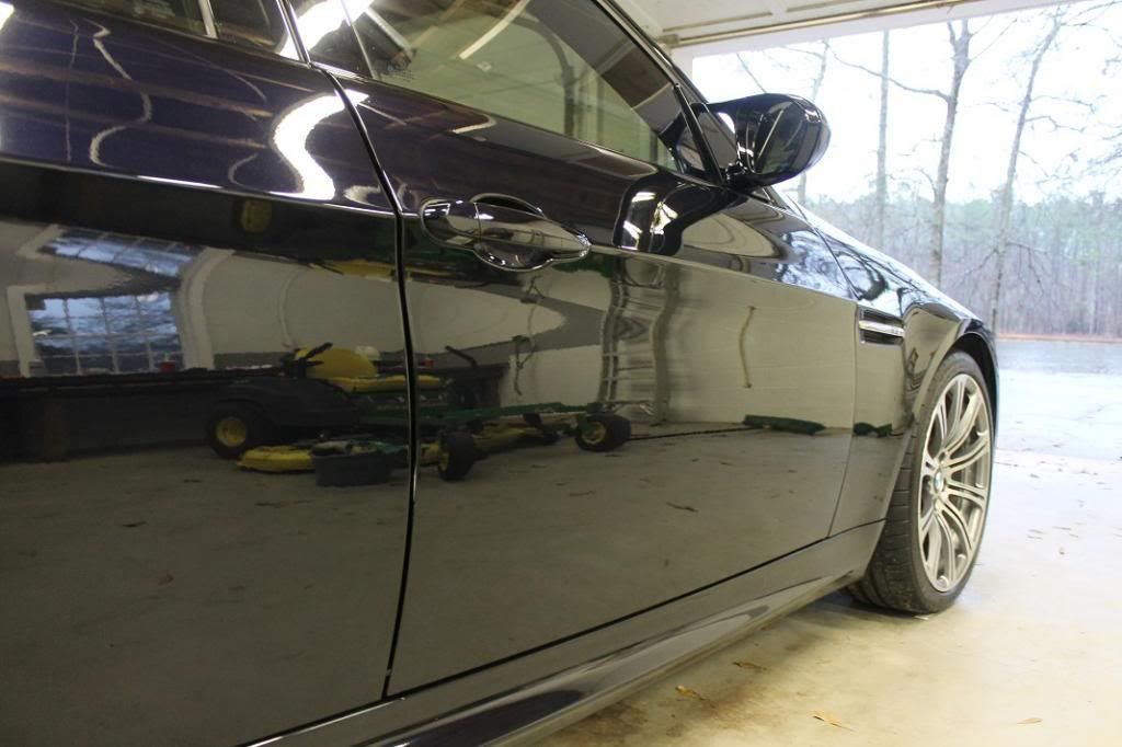

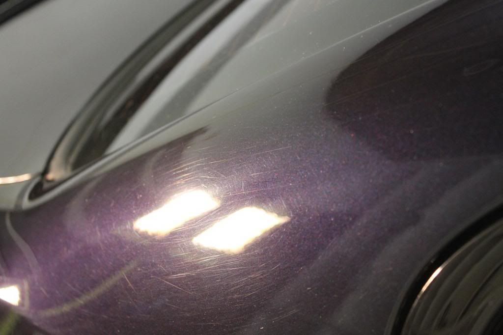

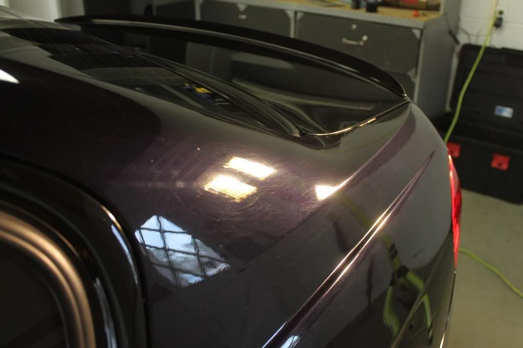

Jerez Black is a really good looking color, the owner wasn't kidding when he said it turns purple in the right lightings.

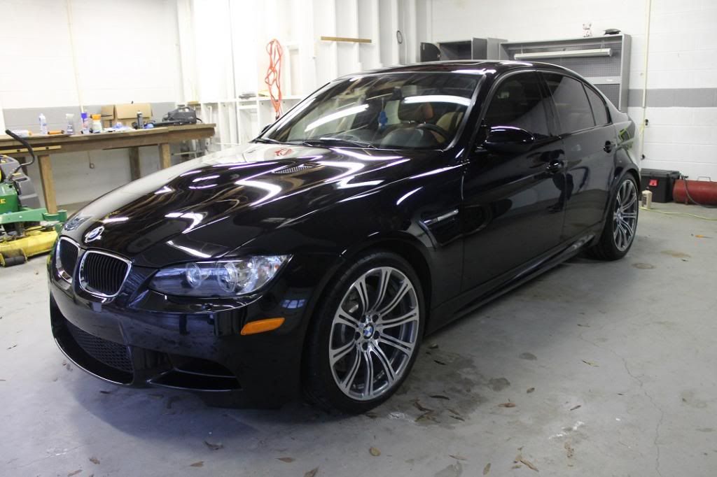

Didn't get very many after shots, but there was a 90%+ correction over the entire vehicle. :)

any reason for ironx on wheels but iron out on paint?
"After one pass of M105 & SIP"
Did you actually do only one "section pass" with M105 & then SIP, or are you saying you worked the compound and polish down on each section?

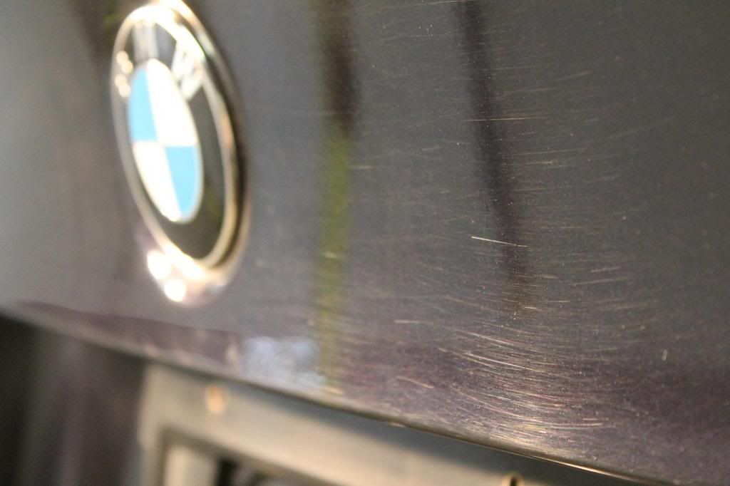

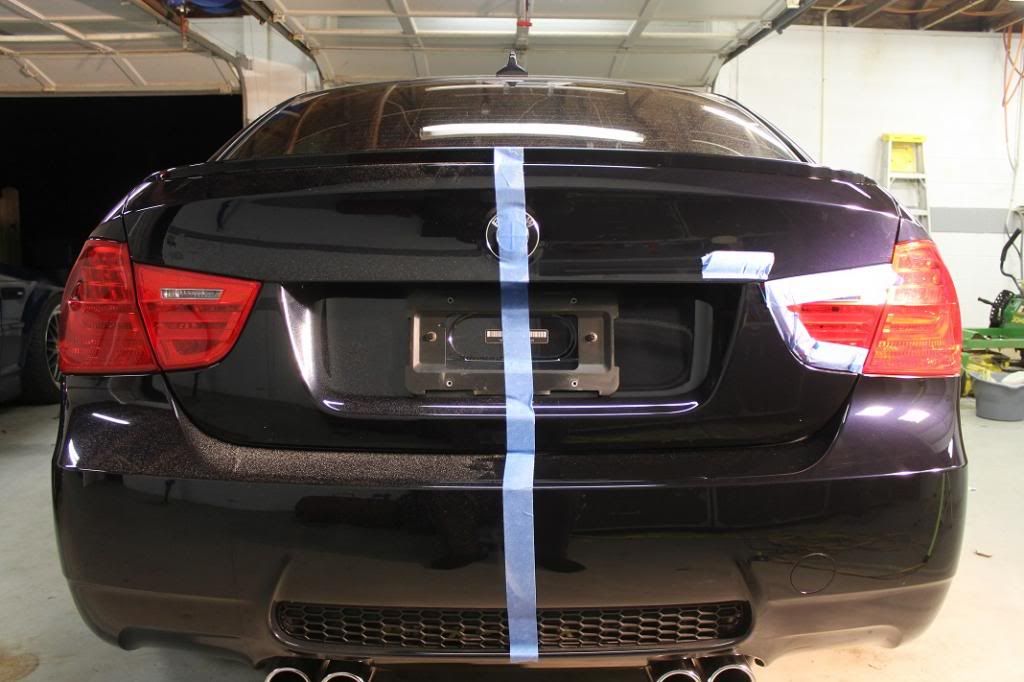

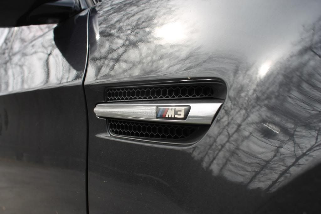

What products and methods did you use around the M3 logo?
Nice turn around. What was used on the engine bay? I really like how that turned out.

Just curious, did you choose M105 over FG400 after a few test spots?
Only Iron Out was used, apologies for the mix up. Proofreading isn't my strong suit. Thanks :)
That photo was only a pass of M105, didn't mean to include SIP in the description. The vehicle was heavily swirled, but some areas needed extra compounding attention for the RIDS. Didn't mean a single section pass, a full pass.

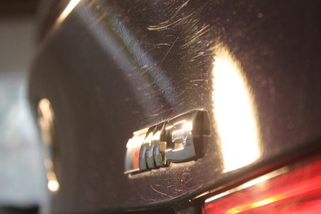

For tighter areas I have a Chicago Electric DA w/ a 3" backing pad, and around badges I spend some time with cotton swabs & detailing brushes and regular cleaners.
Treated with in and out spray & some of Gunk's engine bay products for the degreasing & shining.
Test spots were done on the hood, compounds were between M105 & 3M's extra cut compound. The 3M compound was used on the more heavily swirled areas like the rear & roof, M105 for the more general swirls on the sides of the vehicle. Only used FG400 a on a couple vehicles, still have mixed results.
