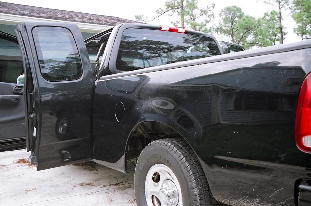

Before wash.​

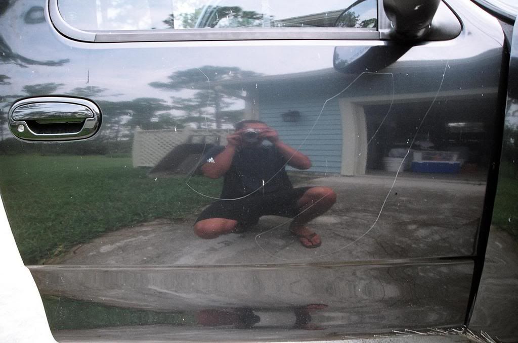

Before again, Kids keyed my car in Orlando...​

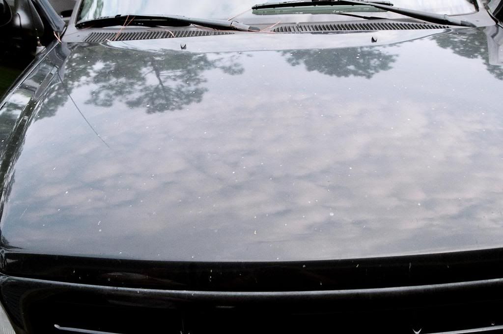

Still before...​

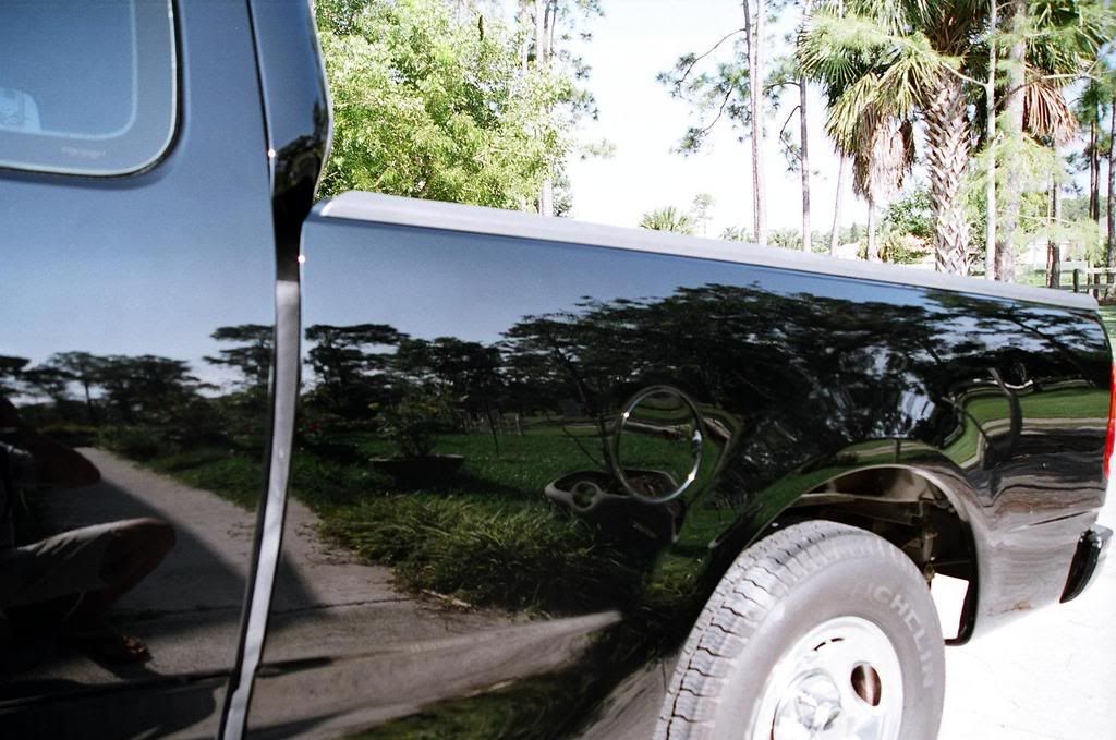

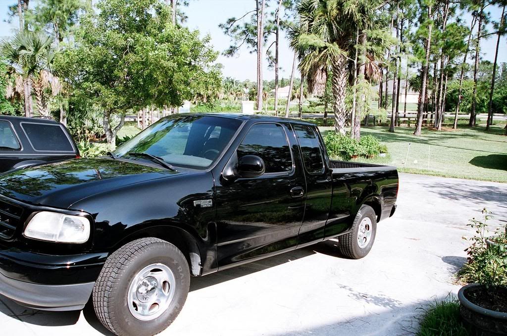

And now the show...
Wolfgand rocks!, well 6 hours of XMT #4 helps too...​

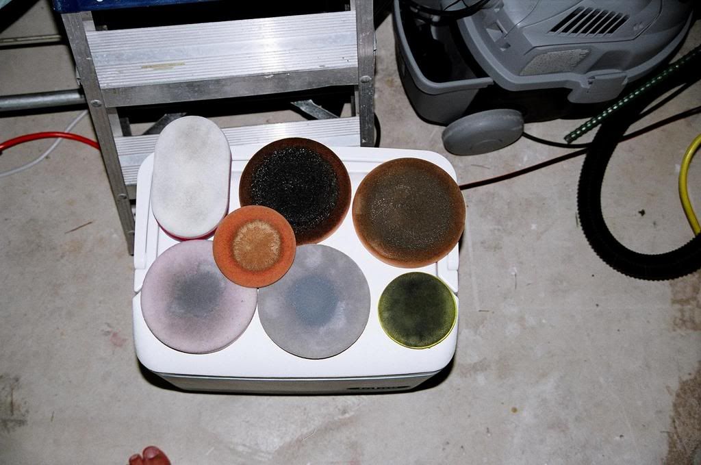

My pads, the black one is not from single stage paint.
The wolfgang went on just like Liqiud Souv. and it is the slickest sealant I have ever used. It took 6h of polishing with the Xmt#4 to get all the oxidation off. I will be able to practice anything on this truck. The whole thing needs to be wet sanded. I didnt dress the tires or wheel wells because my dad is just going to ruin that first. He already cut down some trees, and palm froms, and will use the freshly detailed truck to move them out.

Holy crap man. When I saw the XMT 4 I knew you had a job ahead of you...and those pads look like something Venom threw up. The work was worth it though, very nice job!
Thanks guys, I am still trying to clean those pads. I really liked the wolfgang seal. It looked more like nuba than a synthetic wax.
Very nice turn around, got a really nice wet look to the truck. Question, where you able to remove the scratches completely from the truck?

No way! The scratches on this truck are from 7 years of hard work, and not caring about the finish at all! I got most of the wash swirls out, but there are alot of deep scratches from loading stuff in and out. Also a few dents/ scratches from falling gravel, sod, hay bales, tree trunks, bags of everything, and two golf ball dents. (used to work at a country club.)
I will get alot more out on the next round, when I learn how to wet sand.

Have you tried Dawn Power Dissolver on the pads?

Do you have the Pinnacle Pad Cleaner? That stuff gets out some serious dirt.
I lost my XMT cleanser! Just when I need it, I have hardly used it!
Oh well, I am currently using dawn, and folex, and rinsing very very well.
Its working slowly. I will post some pics later today.
