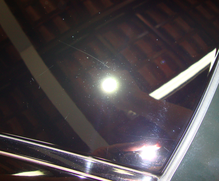

Hi Mike, I saw you showed Pinnacle advanced compound at the end with the photo of all the tools and products you used. Did you use the pinnacle advance compound? I thought after your initial 2 test spots you felt the Uno pure finishing polish with the white pad was the only correction product and pad you used.
Good eye!
I did use the Pinnacle Advanced Compound on the passenger side trunk lid. I have no idea why there were a bunch of deeper straight line scratches in this area but there were. After I polished this area out with the RUPES UNO 1 all the millions of shallow scratches were removed and now these deeper scratches stood out like a Sore Thumb.
They were so ugly and obvious that I took the chance and compounded this area with the RUPES yellow foam polishing pad you see here,
After compounding I re-polished with the UNO 1 with a white pad. Then sealed with the Collinite Insulator Wax.
