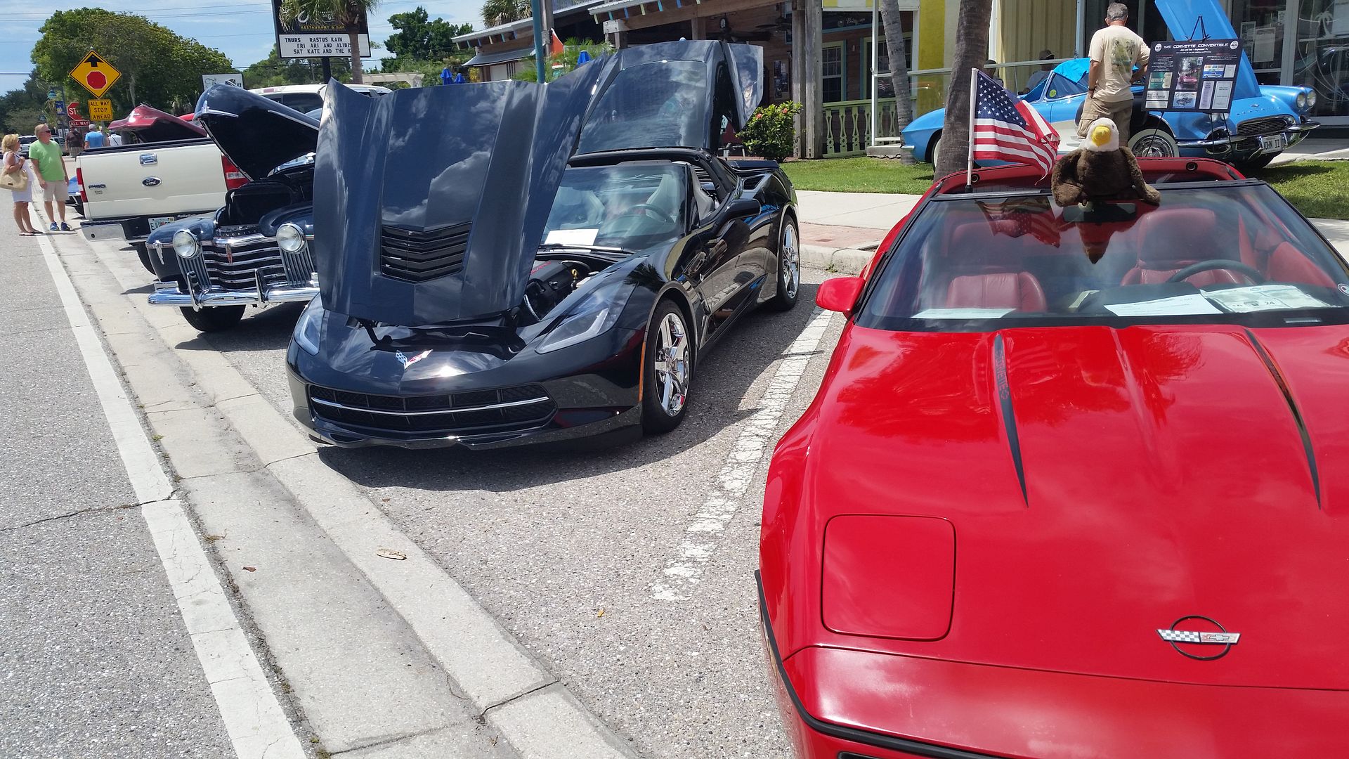

Those are notorious for clear coat failure on front and back bumpers.
Sorry
This shot is from 2015, it has gotten tons worse over time.
That is what I'm finding out lol! I was hoping the other body panels had some other malady other than clear coat failure. It did shine pretty good on the fiberglass panels though. Just those damn white miniscule craters. At 6 feet away it looks perfect! The Megs #7 did a good job of hiding the faded front and rear bumpers. Especially the hazy white looking areas. I can't stop starring at this LT1! 50 years and I finally got a Corvette! What year is yours? It looks awesome!
