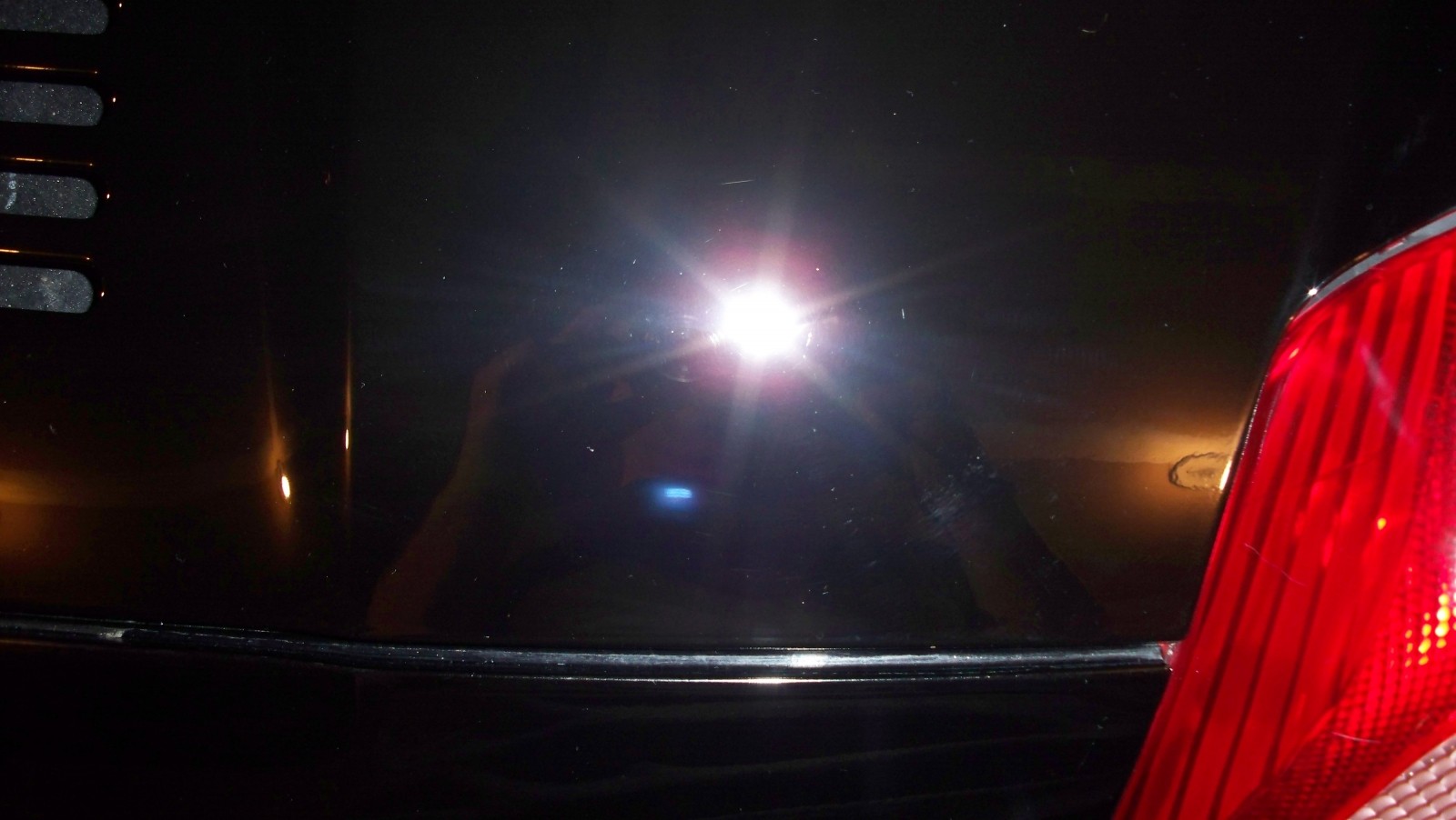

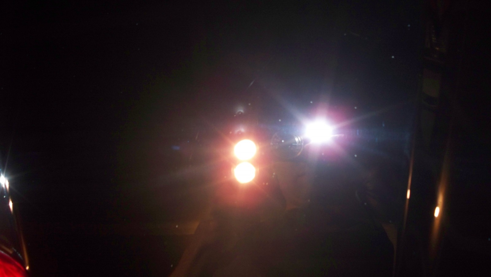

[TD]X[/TD]
[TD="colspan: 2"]Remount on car
View attachment 47351View attachment 47352
As you can see a dramatic difference[/TD]
