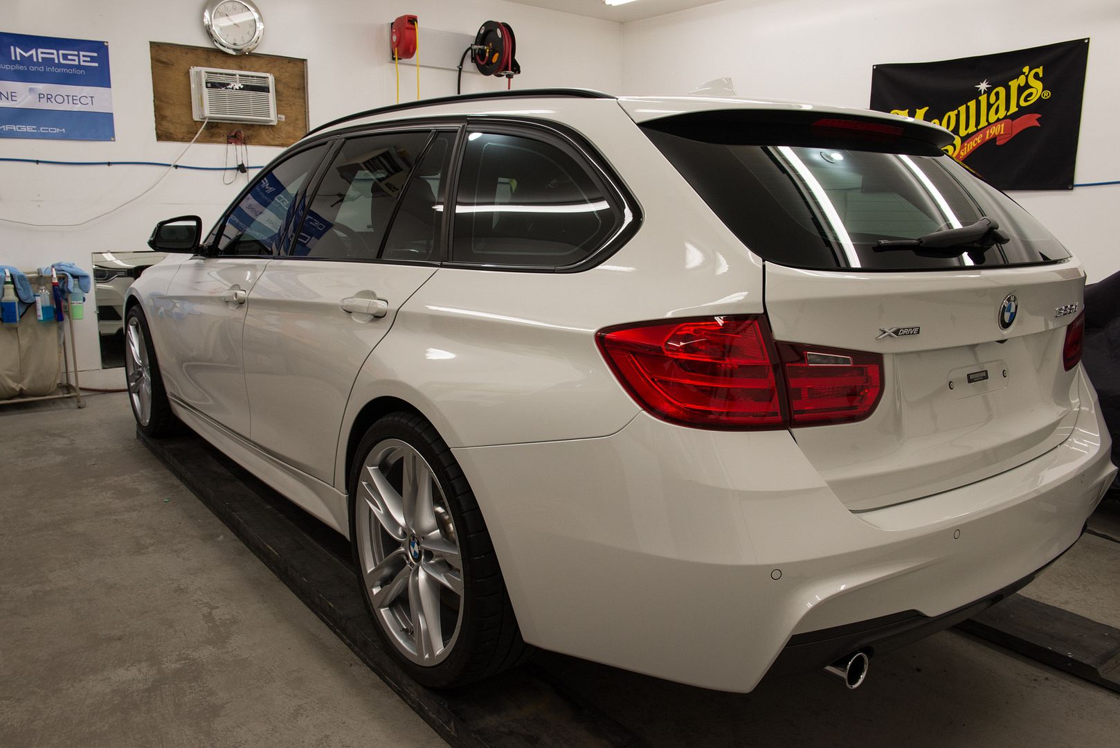

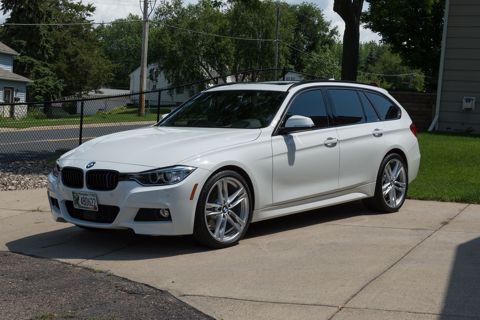

This vehicle belongs to a good client/family that I've been doing cars for a few years now. This particular BMW sits outside 24/7 and becuase of this the paint had some pretty extensive contamination including bugs, tar, sap, rust blooms, and even a few areas with artillery fungus. The swirls weren't too bad, but still required a 2-step correction to get it looking like new again.
Process:
Wash - Megs Hyper Wash via traditional wash, IronX, Tarminator, rewash
Wheels - Sonax Full Effect Plus and various brushes, and Tarminator on the tar
Tires - Megs D143, dressed with Hyper Dressing 3:1
Jambs - OPC with mitt and boars hair brush
Clay - Nanoskin Prep towel with Glide as lube on all paint and glass
Paint correction step 1 - Griot's Fast Correcting Cream with Griot's MF pads
Paint correction Step 2 - Griot's Perfecting Cream with yellow Groit's foam pads
Tool used - G21, G15, Rupes LHR75e, G110v2
Towels - Griot's PFM drying towel, Megs Ultimate Wipes, Griot's PFM Glass towels, DI all purpose towels
Glass - Megs D120
LSP - 2 coats of Collinite 476
